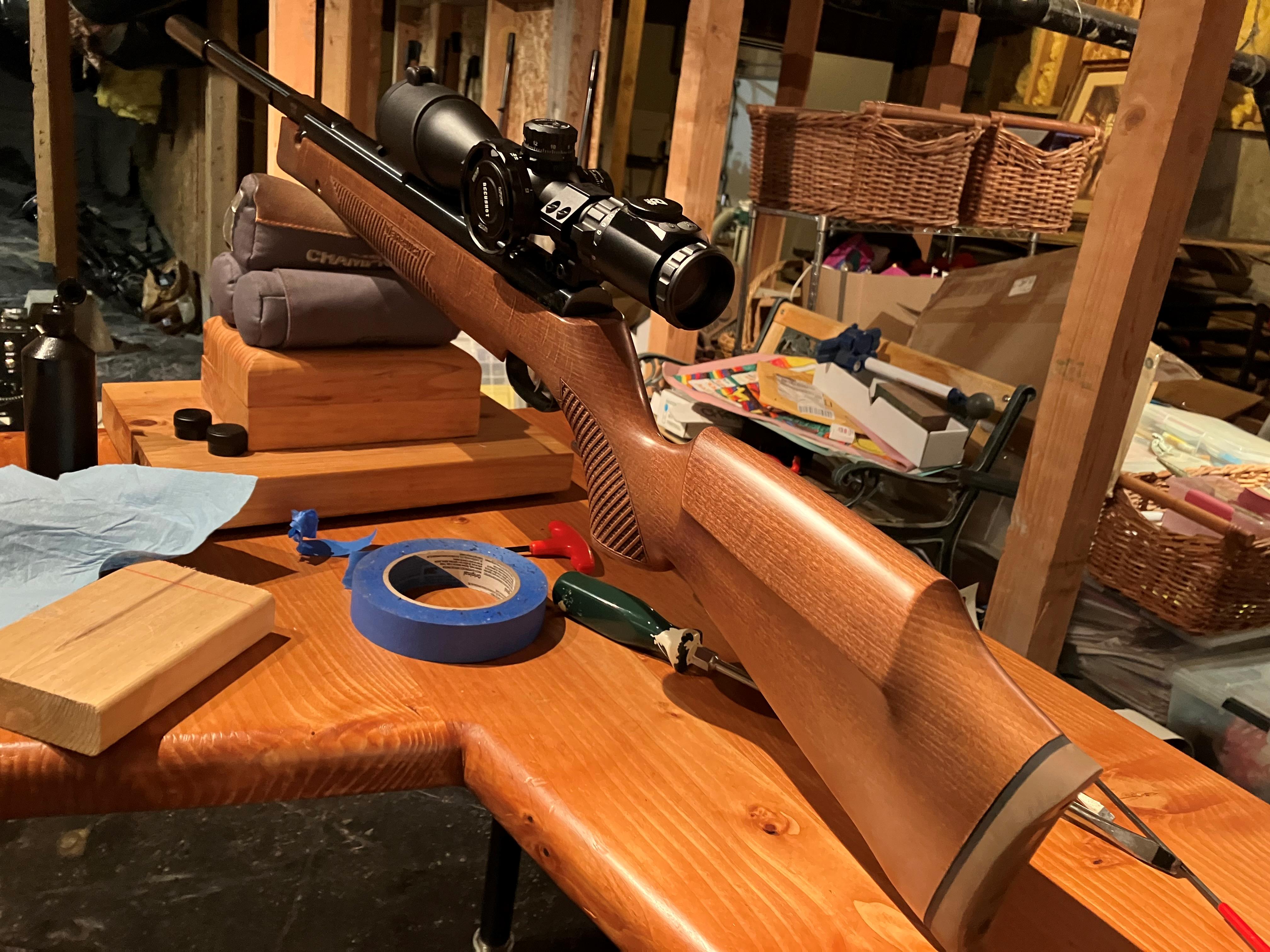

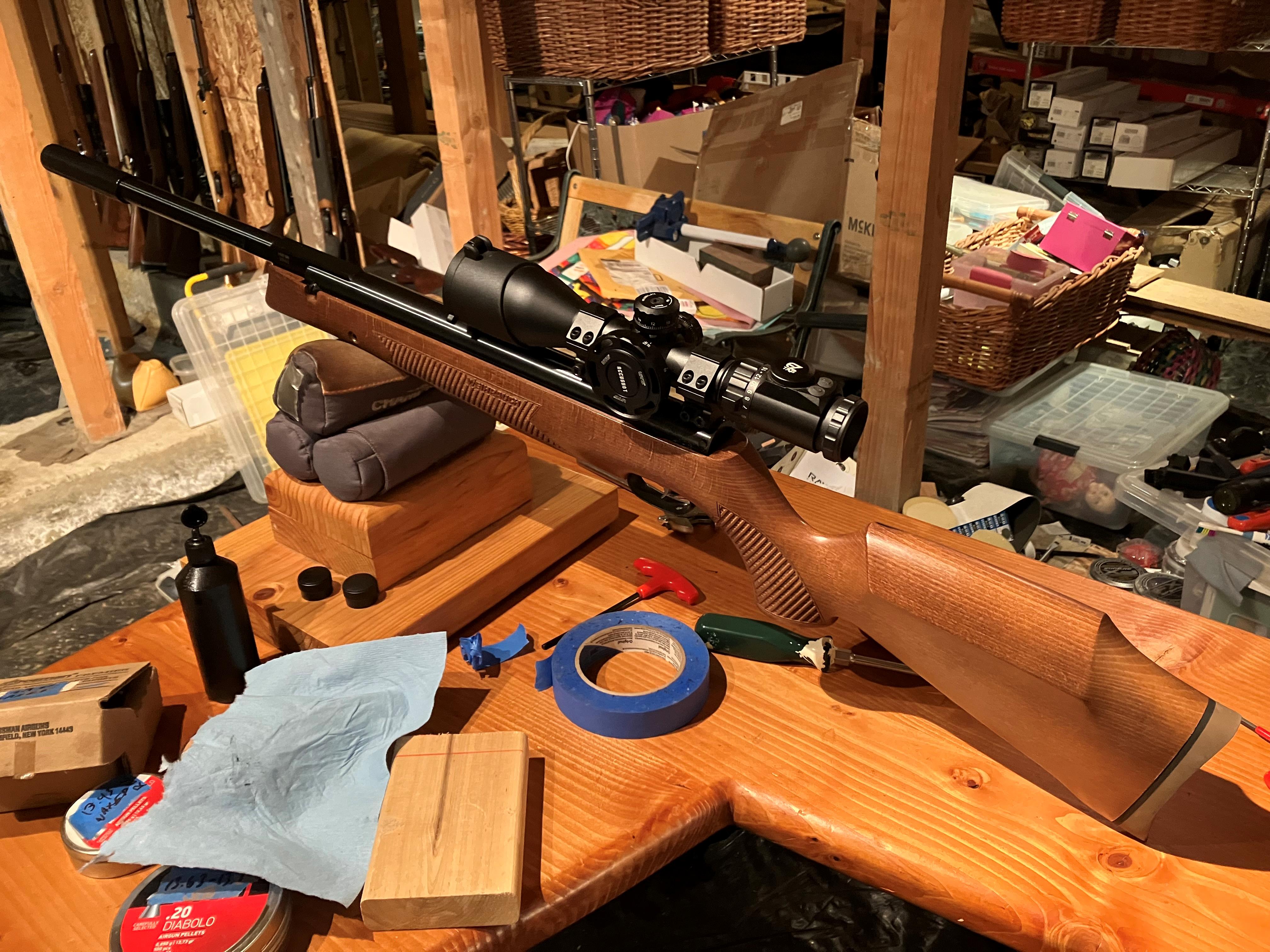

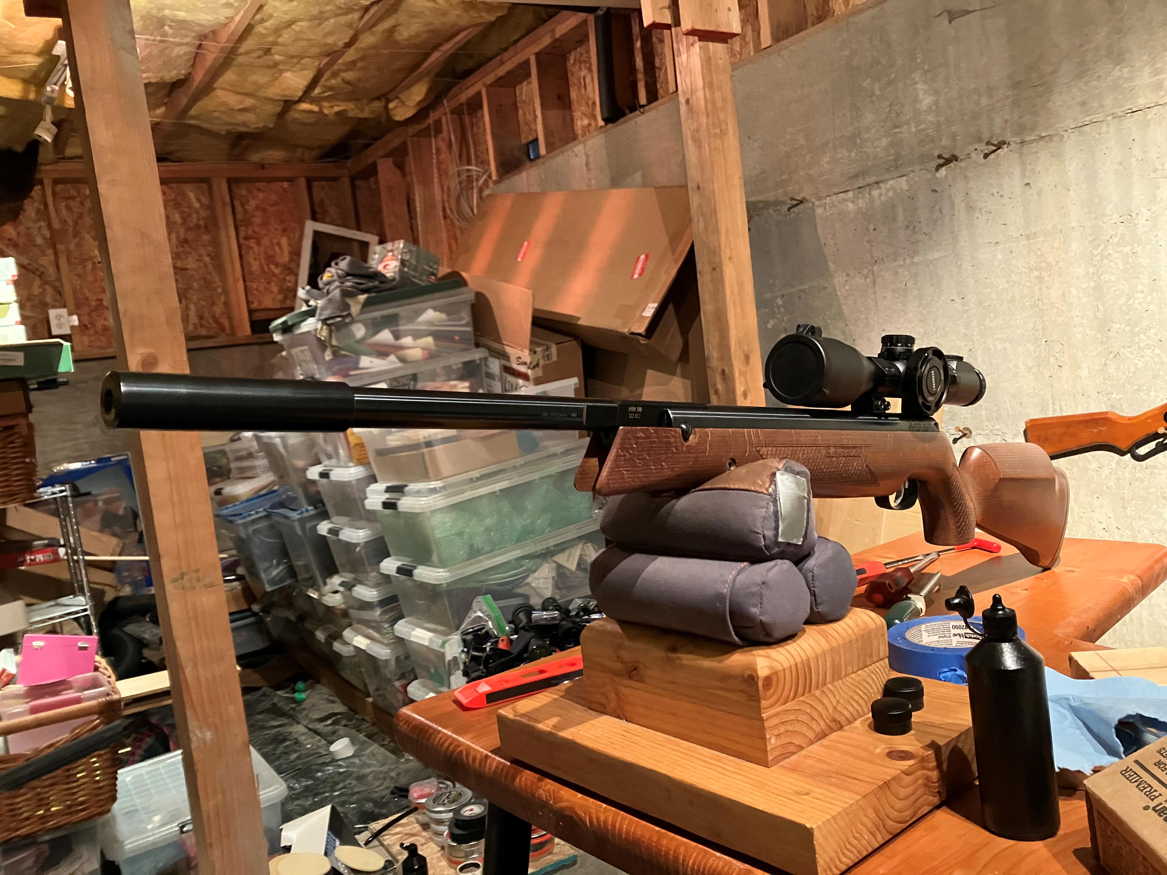

Since I bought and placed a .20 cal. HW98 barrel on my (formally .177) HW80SLK, I got tired of handling the barrel while cocking.
Whether its the cold steel or the fear of rusting/blueing wear, I decided to make a muzzle brake for it like all my other HW's.
The brake completely covers the screw on muzzle end of the HW98 barrel and looks a little wonky as the barrel is roughly 7/8" in diameter.
However, it works great - (y)

Marty, the newer HW80 Lexus stock feels beefy/chunky vs. an older, Beeman Goudy stock.
The former, .177 SLK barrel enabled me to whip it around much easier, but suffered for excessive motion of the 16 FPE shot cycle vs. the .20 caliber (19.75 FPE).
The 98 barrel makes the gun even shorter, heavier and more solid.
Best of all the gun is more stable with the heavy barrel and easier shoot accurately.
I’m almost ready to go after Bayman’s 435 yard milk jug 👍.

Hey A-of-the-B,
The MB just keeps your hands off the barrel and gives a much better grip for cocking.
I always recommend liberally oiling the barrel end before pounding on one of my MBs.
I've taken 3 or 4 off before when I came up with better looking MBs; never saw a rusted barrel tip. However, I'm pretty careful where it's pointed.
Yes, their made of black delrin and are drilled to the barrels dia - for Weihrauch's it either 15mm/16mm.
The front sight grooves provide enough friction; hence they're pounded on with a dead-blow hammer.
Delrin is surprisingly tough stuff, never had a splitter.
