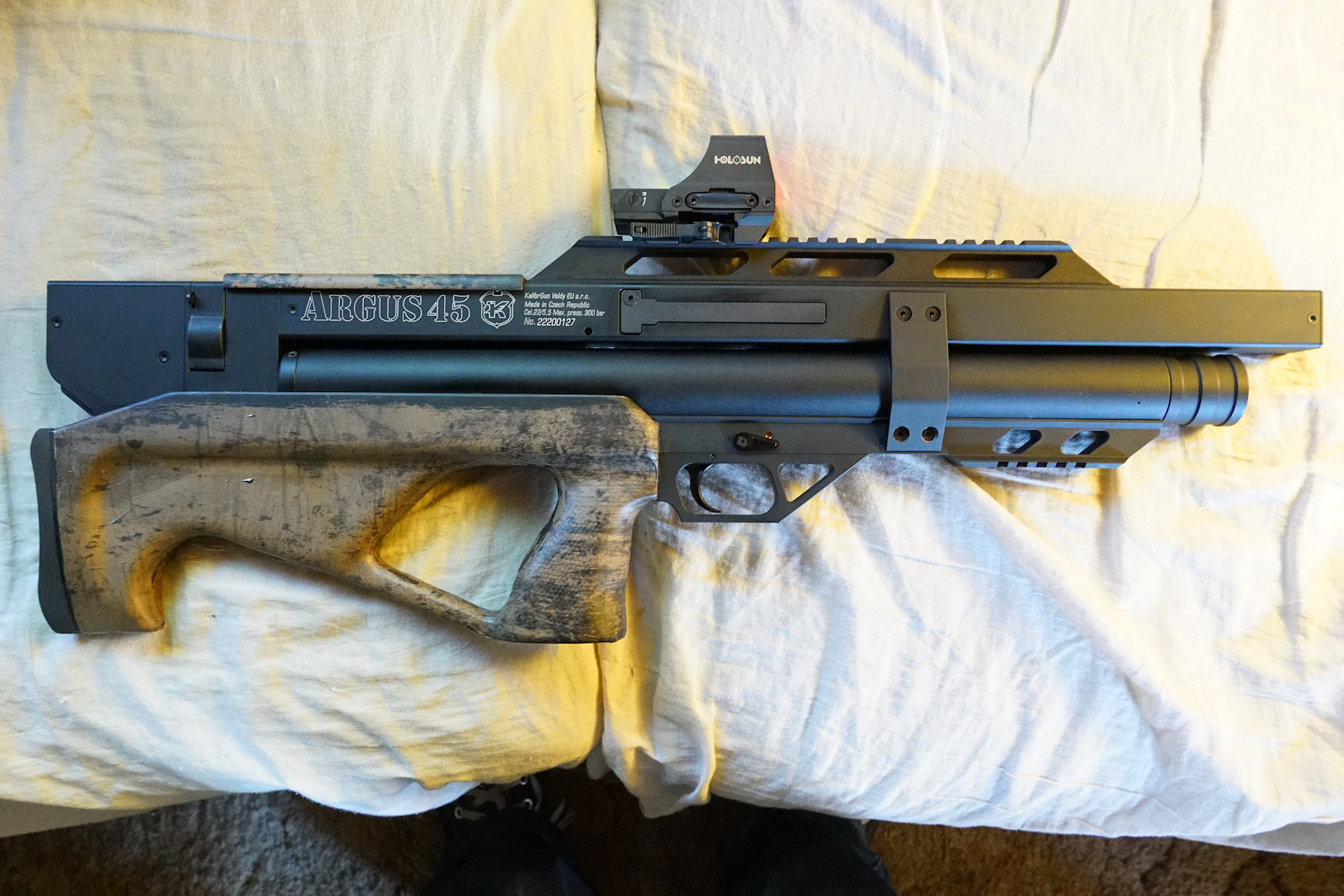

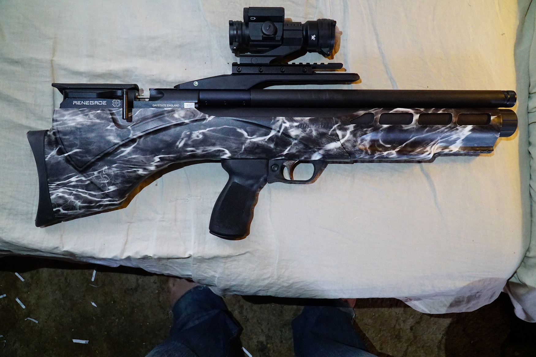

Have you seen the vinyl skins ?
Many, many patterns to choose from. Many different companies to search their pattern list. I buy the "large or extra large sheets", so I can fit it to the gun they way that I want.
A couple of mine.
Mike
