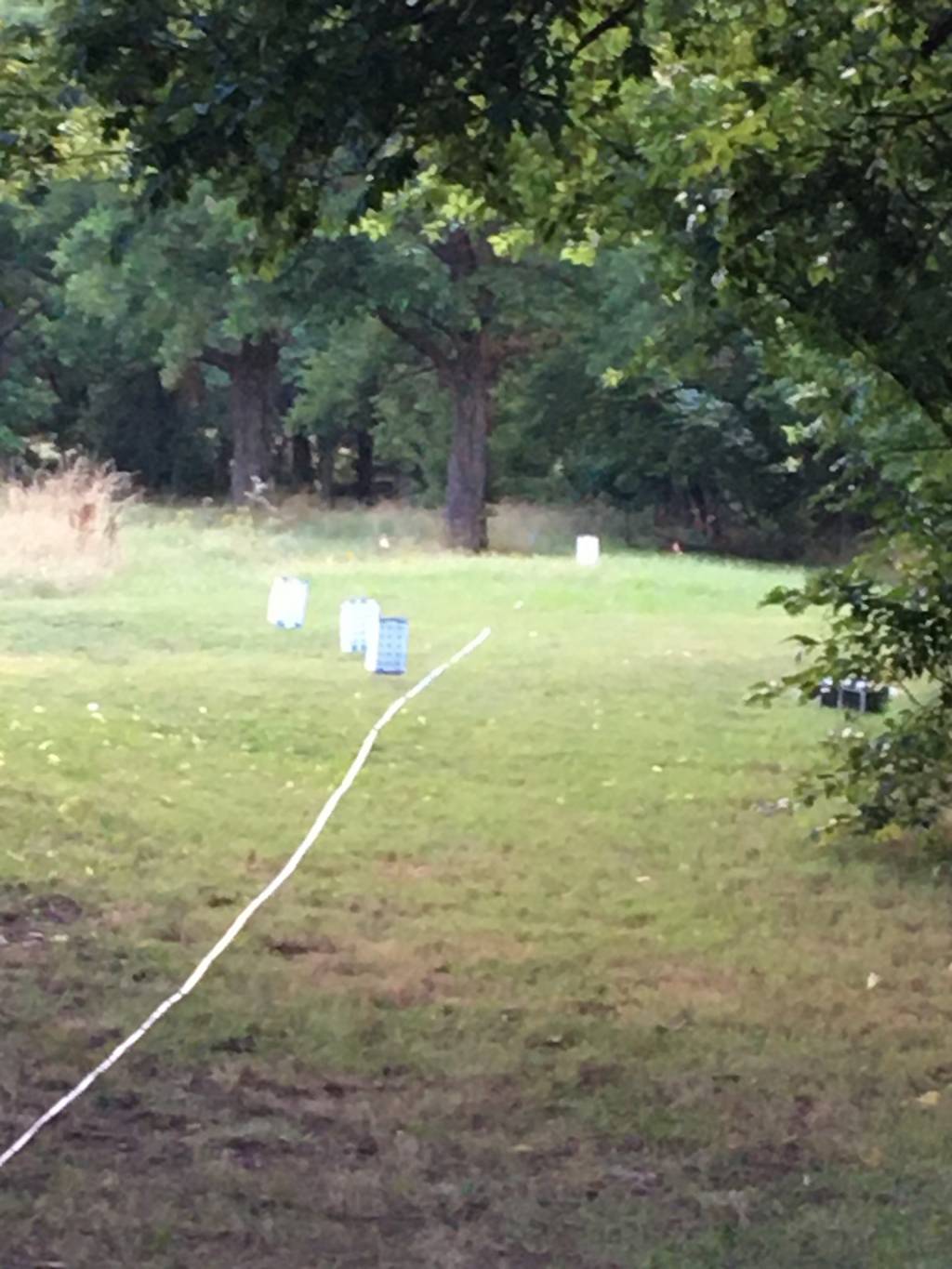

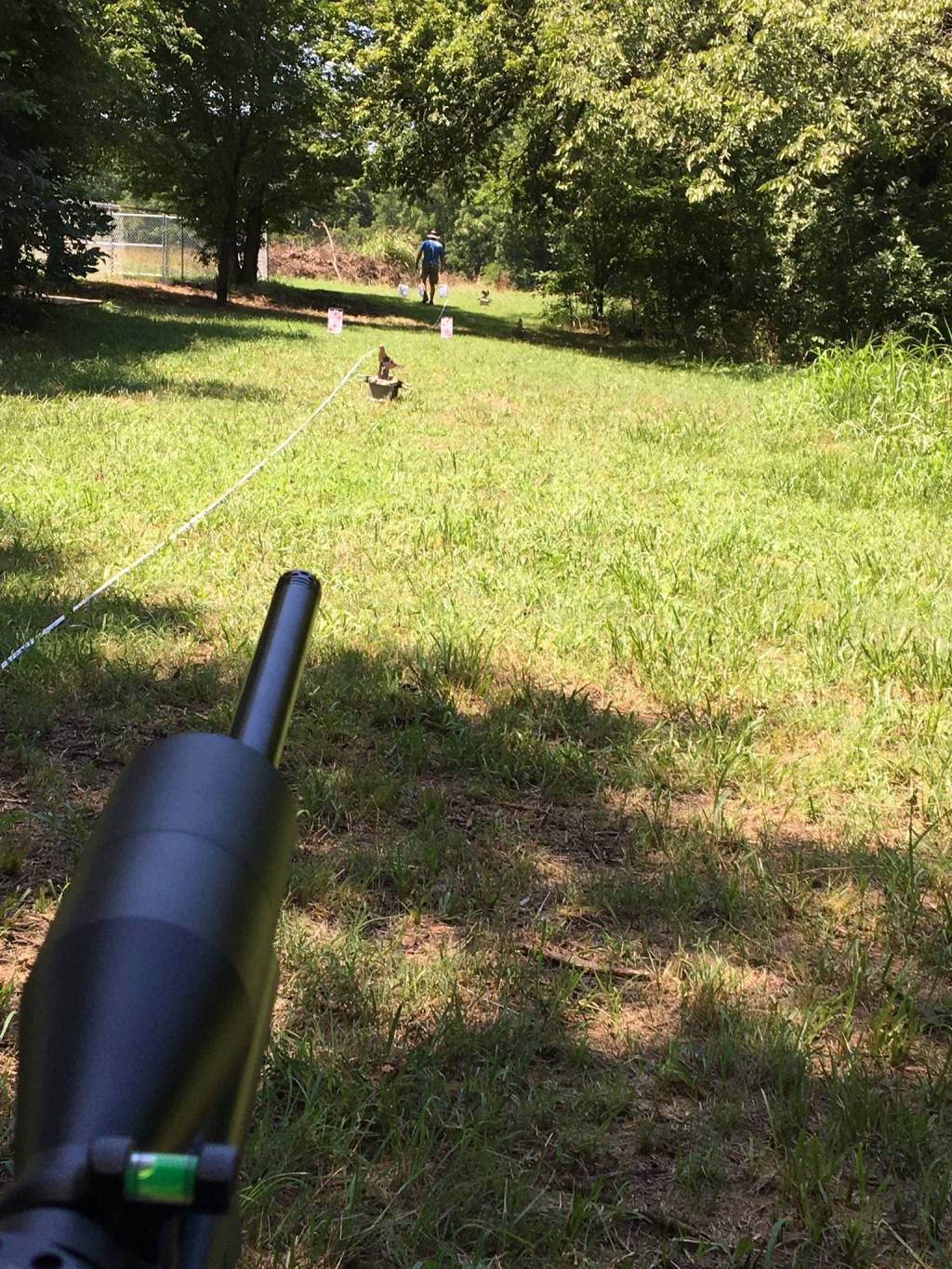

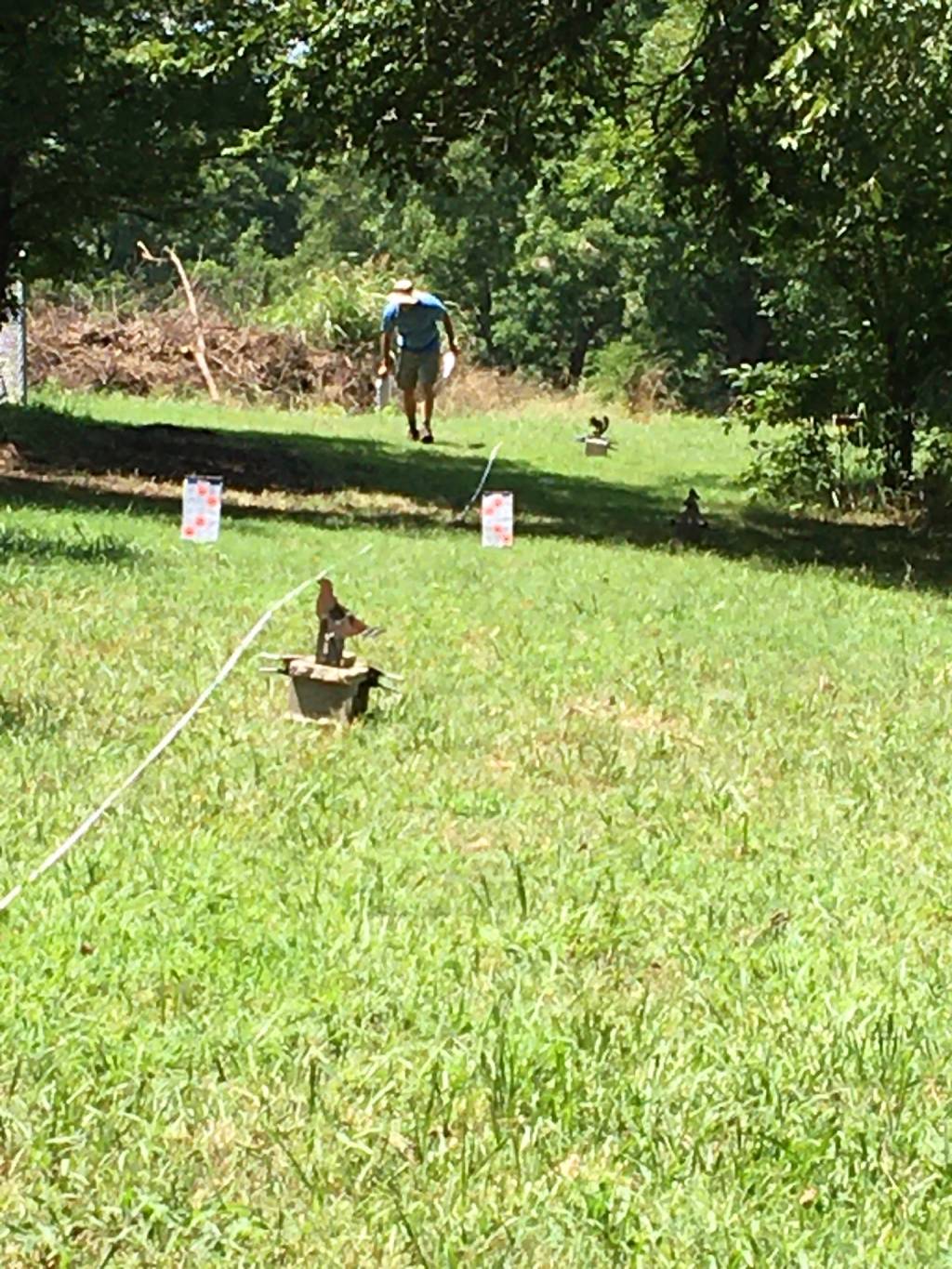

If you’re only shooting out to 55 yards, one of the things my shooting buddy and I do is to roll out a measuring tape we have pre marked from 10-55 yards in one yard increments. We take turns setting out targets and shooting.
How this works is, he puts the target at a distance unknown to me along side the measuring tape. I range it making note of the distance. I take the shot and tell him what I ranged it at. He will then tell me what distance he set the target at. This allows me to make any necessary changes to the ranges on my wheel or to my range card. We do this in rotation of near and far targets and typically use a Troyer scale concurrent to the upcoming match we are going to attend.
we have found this to be very helpful and has improved our scores in the last year.
the white line on the ground is our tape. About $15 at Harbor Freight.
