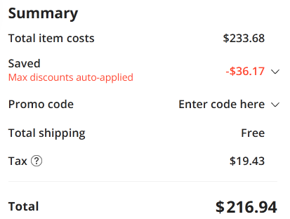

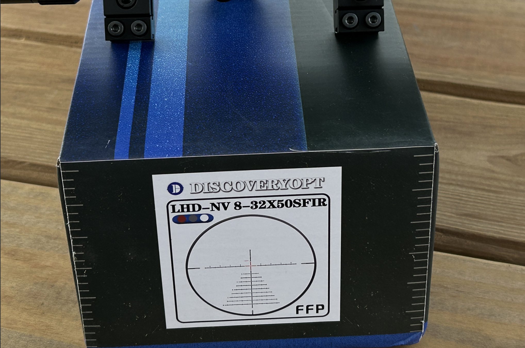

off brand on aliexpress 5-30x56 with 10 yard parallax, 34mm tube @ $376 (super slow shipping)
discovery 8-32x50 30mm tube 10 yard parallax @ $234 (fairly fast shipping)
Both have my favored Christmas tree reticle.
Try USAFF50 for 50$ off $260+
Try USAFF20 for 20$ off $150+
There is an additional 16$ Cyber Monday discount going on now too that ends in 16 hrs.
For the discovery I got it down to $217 shipped.
For the off brand I got it down to $341 shipped.
