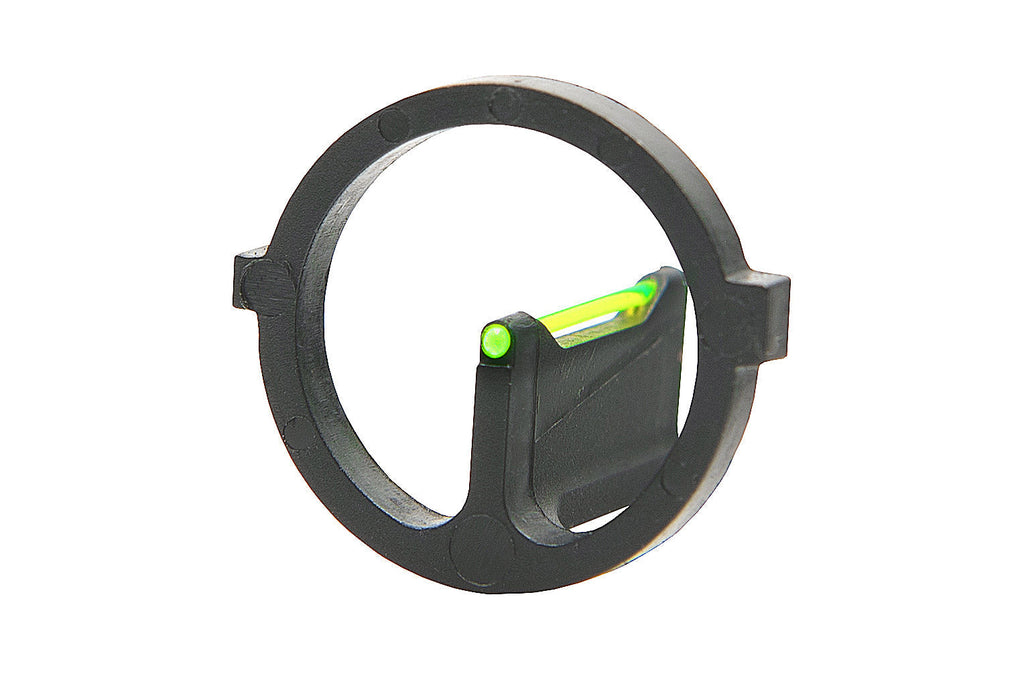

With the long steel breech and Williams WGRS-54 rear peep, the rifle now weighs 4lbs. 2.8 oz. I hope to lighten it a few ounces with an aluminum breech as soon as my part comes from China. I plan on making a fine (.040") fiber optic front sight from the Buck-Rail silencer adaptor that has the front post built in. This is the Williams Western front sight insert which I have and love. They come with extra fiber optic rods. I may even shape the whole assembly with a file to fit into the Buck-Rail dovetail on their suppressor adaptor. I have made skeletonized globes (hoods) from sections of EMT conduit and then epoxying it into place. Putting holes or large slots in a globe makes the fiber optic light up but protects the delicate post.

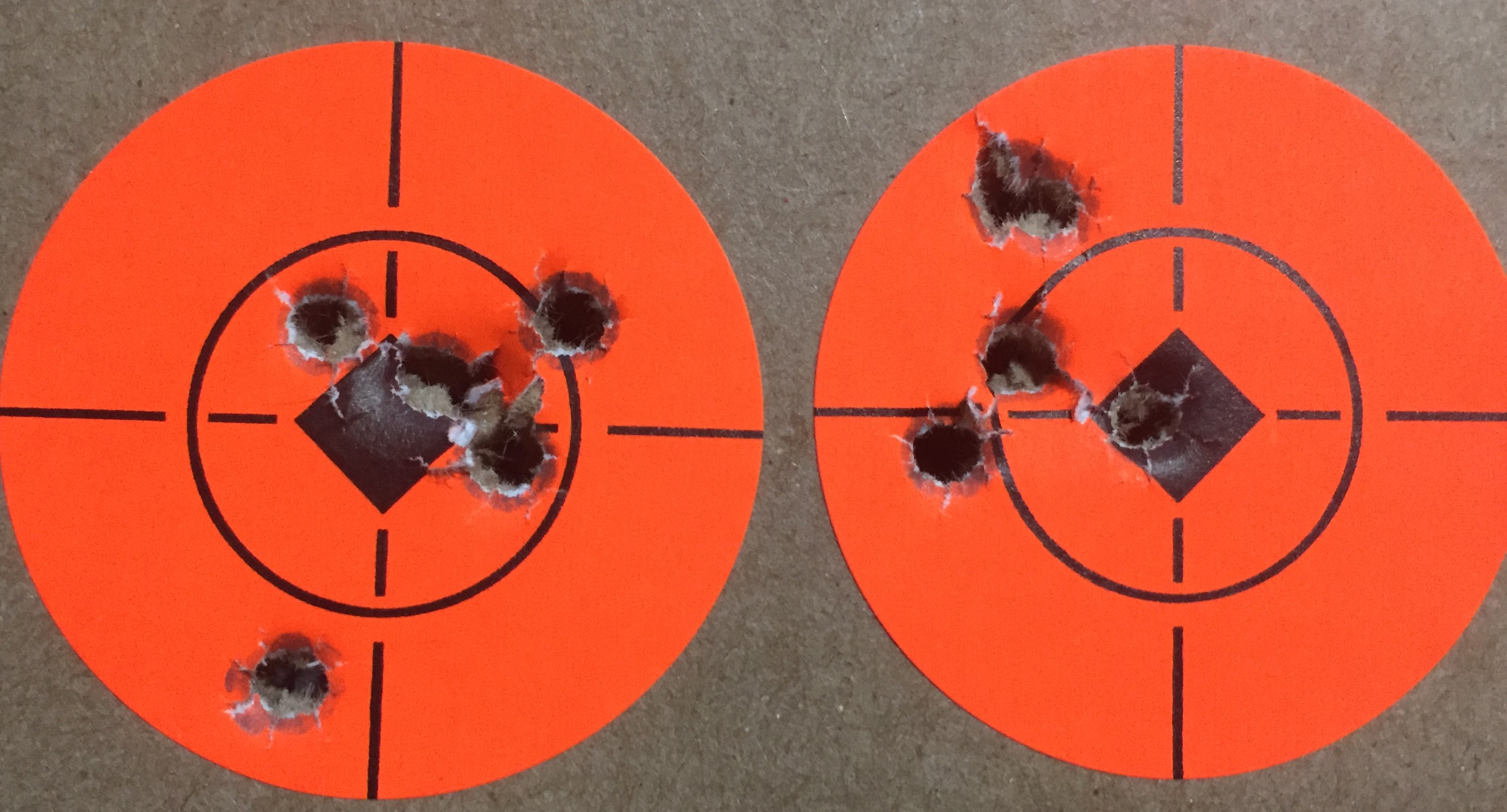

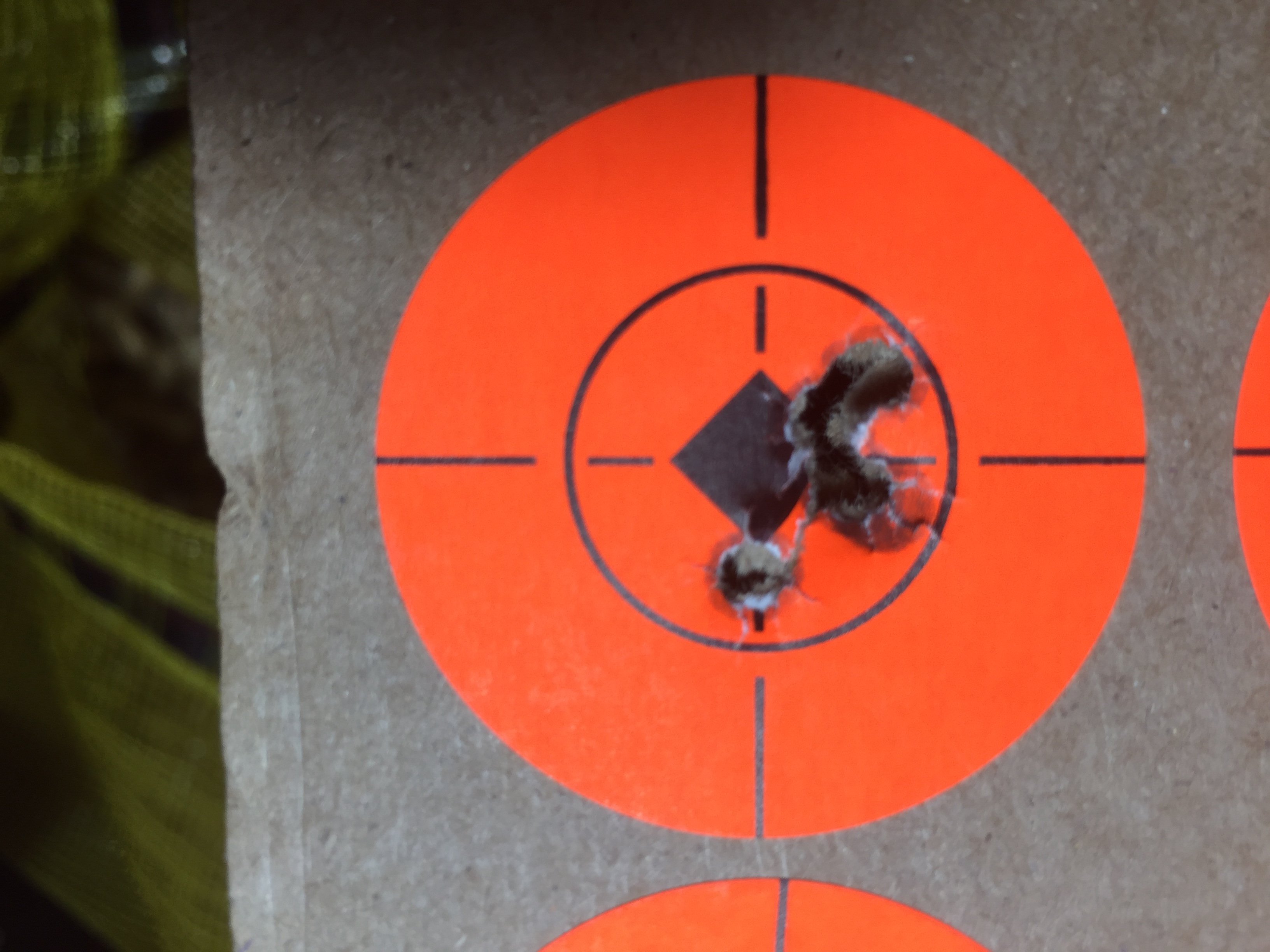

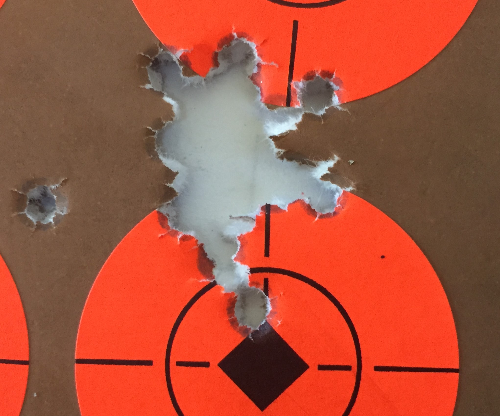

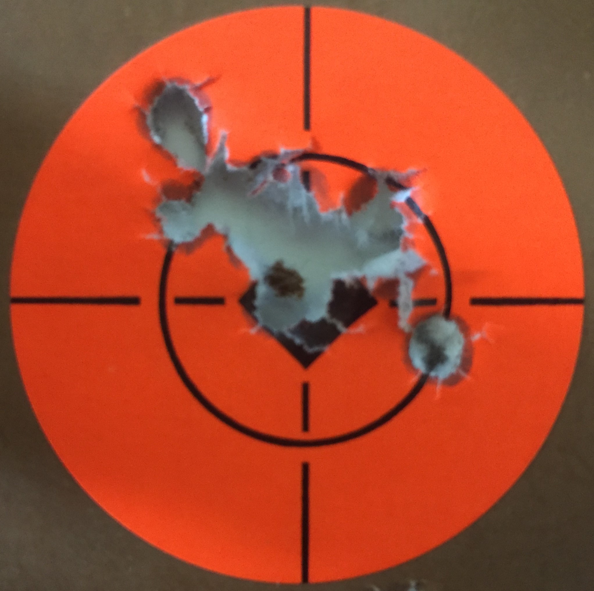

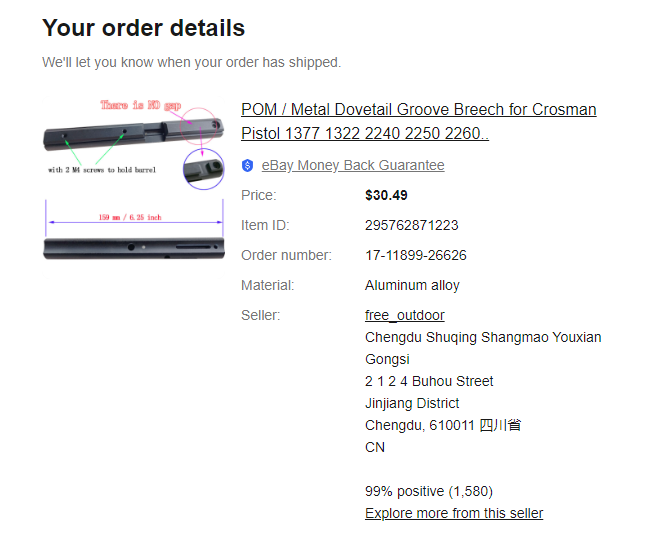

Well, after a few days, I received a Chinese aluminum breech that was ordered from E-Bay
It saves 128 grams over the Crosman steel breech. The Crosman weighs 196 grams and the Chinese one weighs 68 grams. The rifle scoped and suppressed weighs 5lbs 3.30z. At 23 yards (68 feet) I am consistently getting hole on hole groups and the worst are 7/8". A "flyer" is 1/2" off point of aim. I am using JTS 16.08 grain pellets. Those are the accuracy results so far. I hope to test out to 30-35 yards.

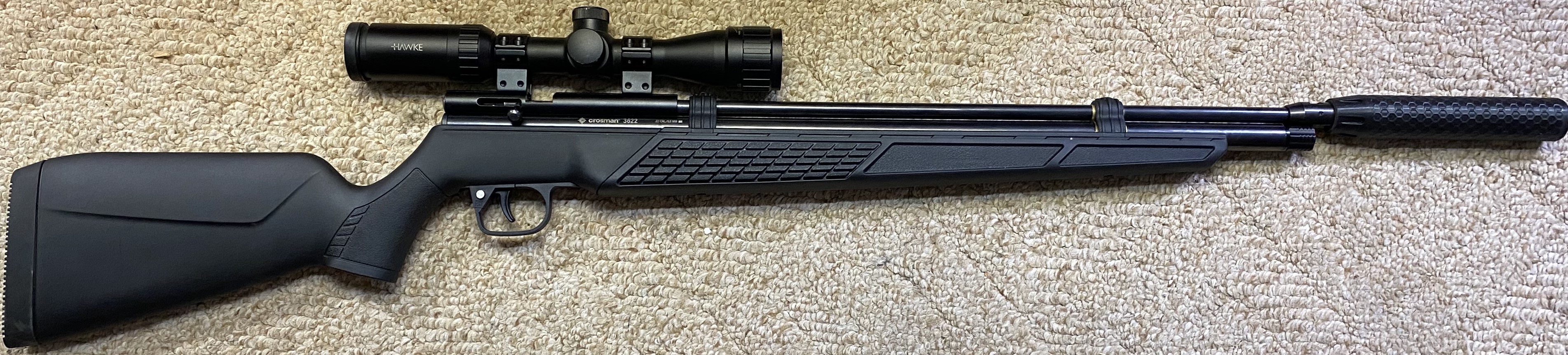

Modifications are such: Aluminum breech
.173" diameter transfer port (Peter Nollan E-Bay)
drilled valve to .173"
drilled barrel port to .173"
radiused short turn inside valve
re-crowned barrel
Hawke Vantage 2-7x32 AO scope
shimmed front barrel band around pressure tube and barrel
Buck-Rail suppressor, adaptor and fill cover
relieved stock to access hammer spring adjuster
short, stiff hammer spring
1/2 turn out on hammer adjuster
lighter trigger return spring
lessened tension on sear spring/safety spring

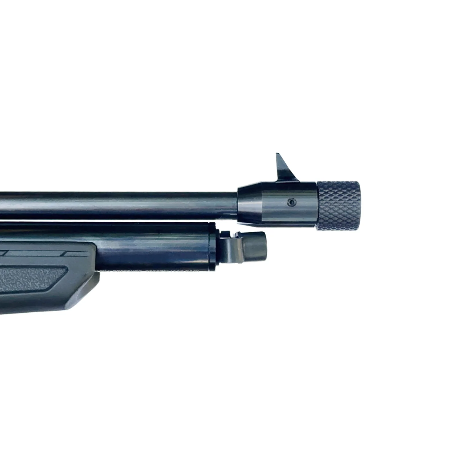

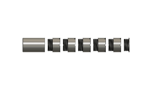

I purchased the modular silencer from Buck-Rail. It is made of Nylon, I presume on his new machines. It can be taken apart and cleaned. The nylon material should be very tough. I have broken one of the old style silencers ( I glued it back together) Terry has replaced any broken pieces or he would have refunded, from what I have experienced. The modular silencer is just as quiet as the other Buck-Rail ones or even my Donny RYU, which is four times the cost. I do love how quick the RYU comes on and off. I would recommend both models. The Crosman 3622 fill nipple cover got moved to the gun in the lower part of the picture and the 3622 wears the Buck-Rail cover.
