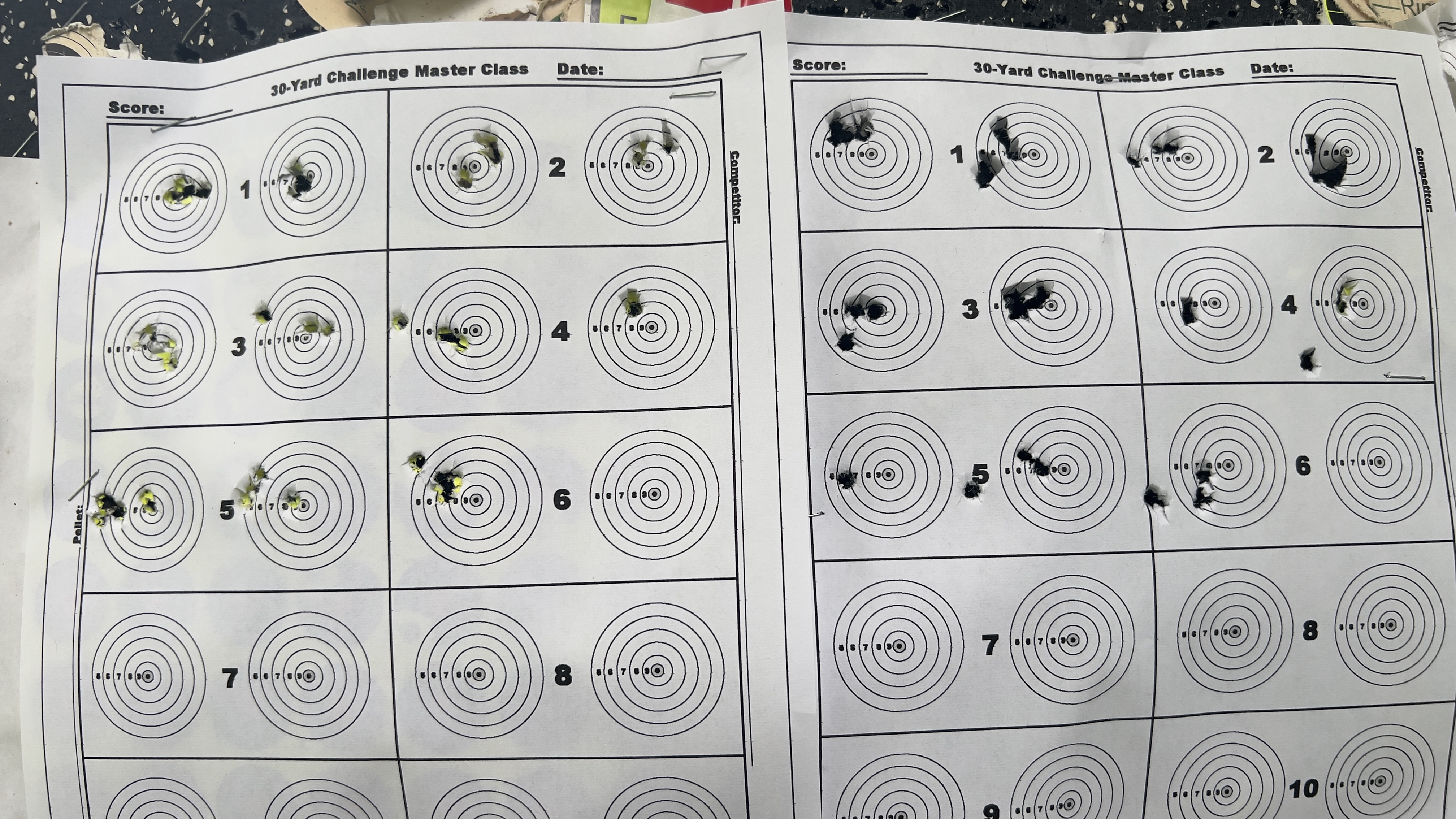

Here's a video from today.
Please take a look at this and tell me if you see a bad grouping problem. https://www.youtube.com/watch?v=FkWw3Dmbxio
Brocock/Brk Commander XL Magnum at 30M with JSB 18.1 pellets.
Personally, IMHO, I am not happy with this poor grouping.

So it's not clipping, right? The first thing I'd do is dial back the power and hammer spring, maybe it's a matter with air flow dynamics. Start fresh at low power with match grade pellets.

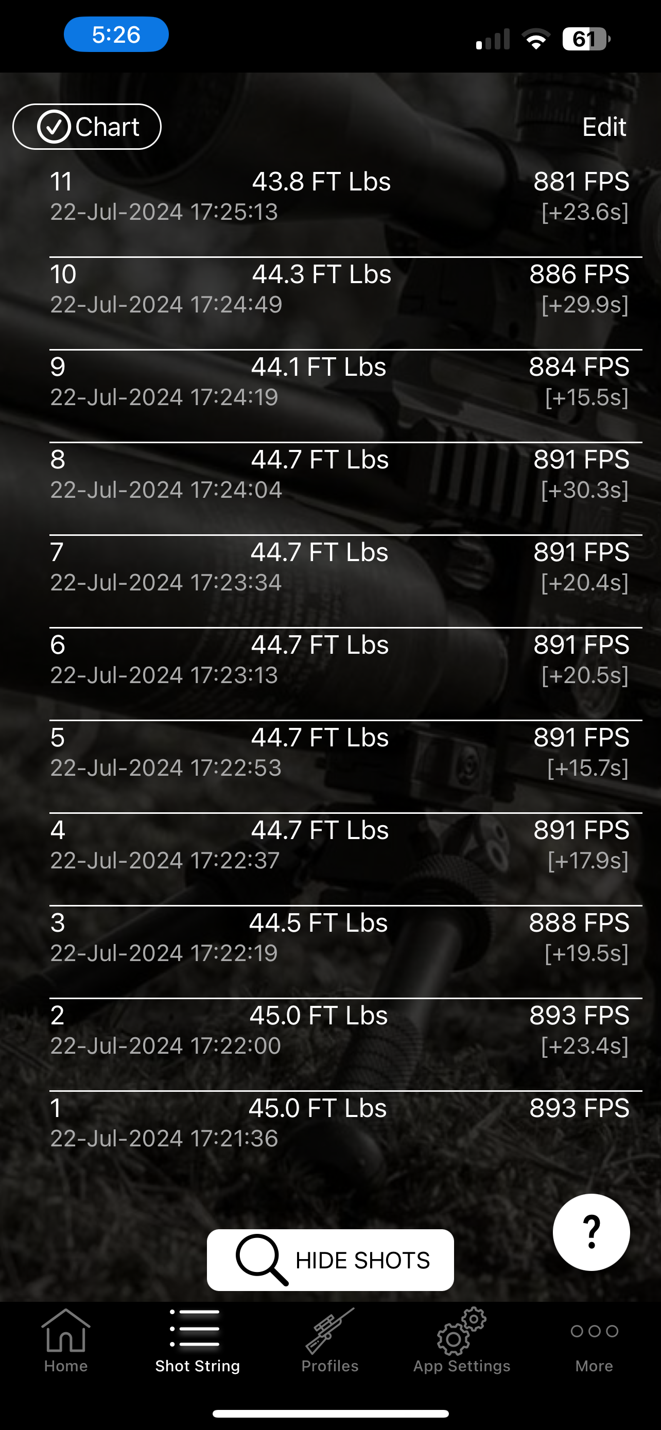

Thanks for your inmput! I always use the best pellets. And I did try the power procedures that you suggested. MY SD is pefect (in my opinion). You can see grouping, sometimes "right-on" and sometimes good grouping but to the left. I have tried with and with moderators, no difference and no clipping. Have a look and LISTEN to the Chrono on tight velocity and energy, which is as good as it gets, IMHO.

So I just finished anoth series of groupings with same JTS 18.1 grain pellet and, at Jared's suggestion, used single shot tray. You'll see that MOST of the shots are excellent spot-on but then rthere's these shots that go right and left and when they do, they group well. Later today I plan on testing again but with JSB 18.13 pellets. Here's video from today with JTS 18.1 pellets and single shot tray

Thanks for your time and recommendations. See attached images of SD which are almost perfect. Jared suggested that I run the 18.1gn at 1000 instead of 890 or so as I have been. Made no difference. Sometimes the shots are dead-on bullseye and then they shoot left and right, mostly in TIGHT groups. Tried 3 different scopes, so scopes and mounts aren't the problem. I'm sending latest results to Jared at PAD and I'll see what he says.
