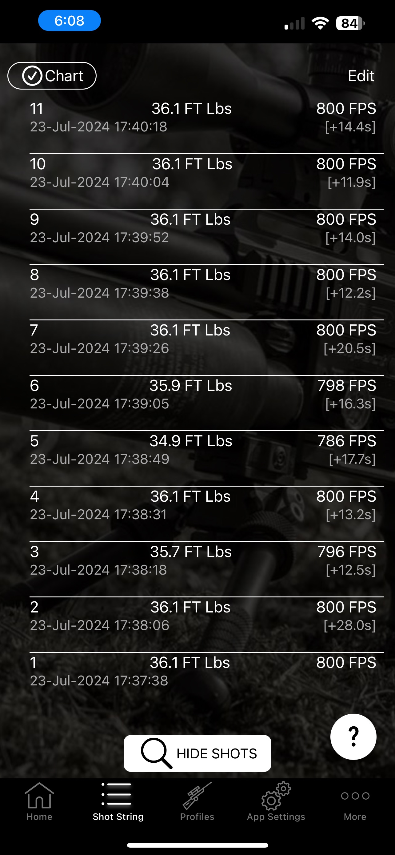

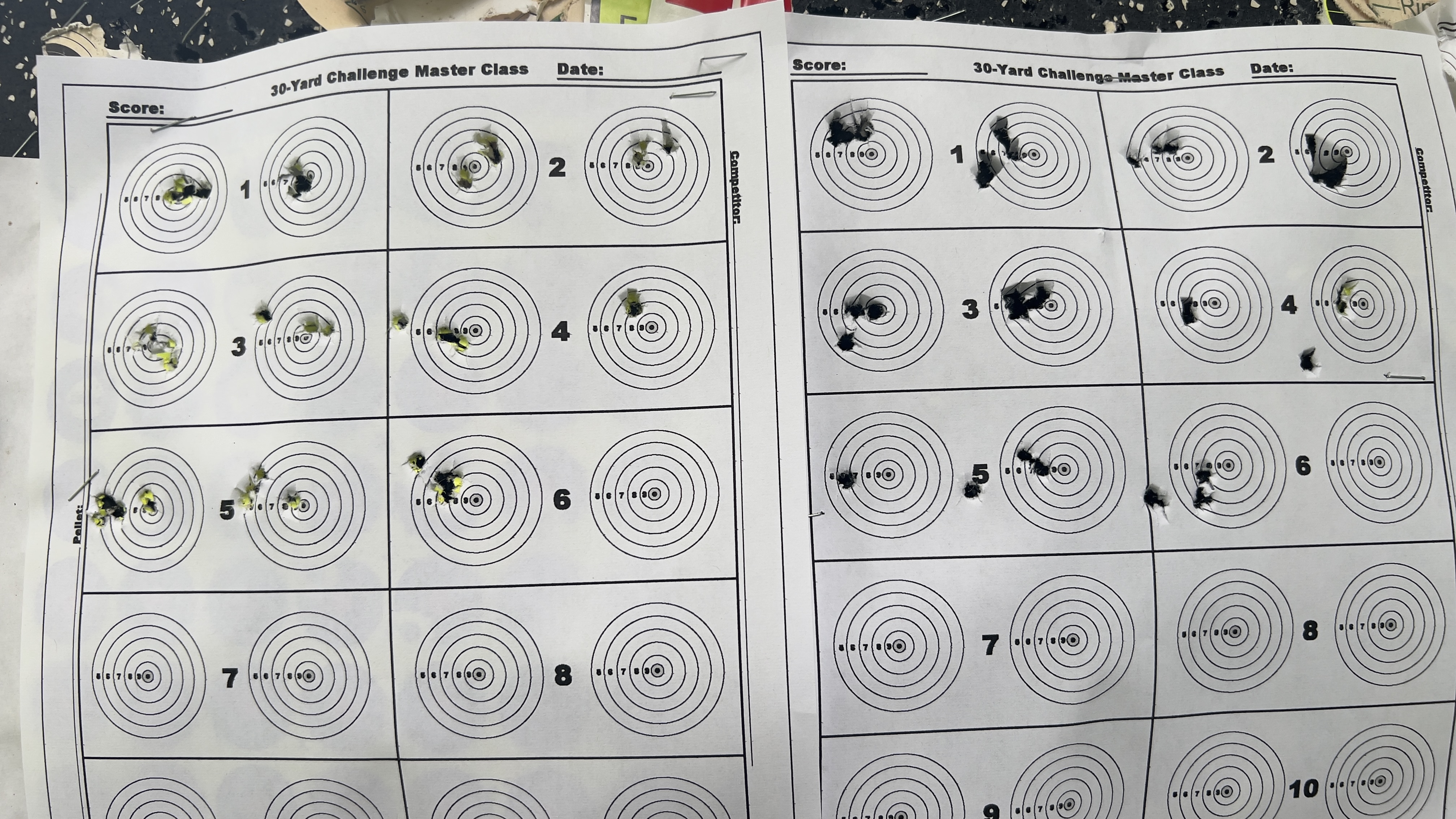

Thanks for your time and recommendations. See attached images of SD which are almost perfect. Jared suggested that I run the 18.1gn at 1000 instead of 890 or so as I have been. Made no difference. Sometimes the shots are dead-on bullseye and then they shoot left and right, mostly in TIGHT groups. Tried 3 different scopes, so scopes and mounts aren't the problem. I'm sending latest results to Jared at PAD and I'll see what he says.

Re my Commander XR Magnum in 5.5mm:
I got it about 2 weeks ago. New. I spent 2 weeks testing virtually every pellet and slug in various head sizes and weights from 18.1gn to 33.956gn. I am obsessed with accuracy and shoot for an hour or three in my backyard at 50m. I demand very low single digit standard deviations in velocity. I am experienced in tuning.
I've managed to get my SDs where I want them but at 30m the all I get is 3/4" or 1" groups no matter what pellet or slug I use. I run my pellets at 888 fps or so and slugs at 1009 or so.
I've checked for loose screws and bolts, The barrel and shroud is tiht as it should be.
I've tested it with moderators on and off. (no difference)
This type of group is regardless of what ammo I am using and I've varied the speeds to see if that made a difference. It hasn't.
I've changed scopes, optical and digital to see if it was a mounting or scope issue. It isn't.
I clean my barrel every 100 to 200 pellets.
So far I've shot well over 1000 pellets/slugs with the Brocock/BRK Commander XR Magnum.
I am not shooting in moderate or strong wind.
I am looking for suggestions as to why can't I get the tight MOA groups that I usually get with my other PCPs
PS: I also have a Commander XR (not Magnum) in 5.5mm and I get MOA accuracy from it at 50m.
TIA.

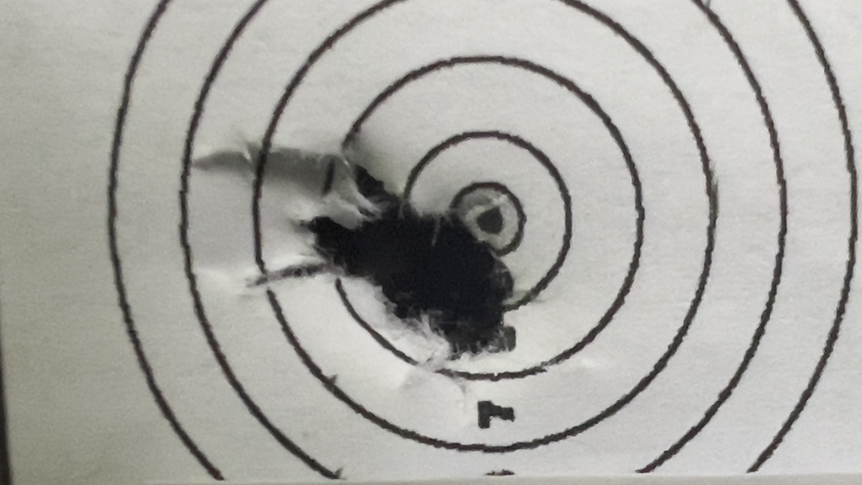

I shot my (non-Magnum) Brocock/Brk Commander XR in 5.5mm today with same JTS 25.39 pellet to compare and see if I got the accuracy I expect from IT and the Magnum.
I wasn't even trying to be the MOST accurate <<I>> could be and here what I got from same bench at same 30m.
5 shot group.
