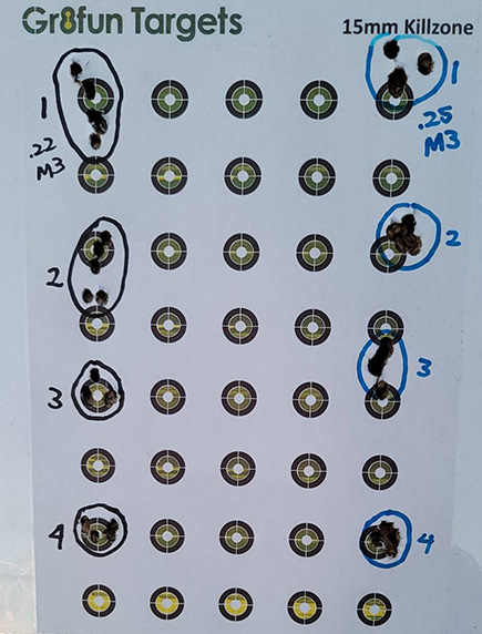

Attached below is the last set of groups I shot tonight. On the left are the typical groups I'm seeing with the 0.22 (I took my time with these groups and tried my best to get them to group (each bullseye is just over 0.5" wide)). On the right, I pulled out the 0.25 as sunlight was running out to quickly shoot some groups for comparison (the first group on top was very rushed and has two fliers but the remaining three, while still rushed a bit, are much more typical of the results I'm used to seeing). You can see how even rushed groups with the 0.25 are way tighter than deliberate groups on the 0.22. Both rifles shot off of a very steady tripod/ballhead combo connected to an ARCA extended rail. WTF is going on here???

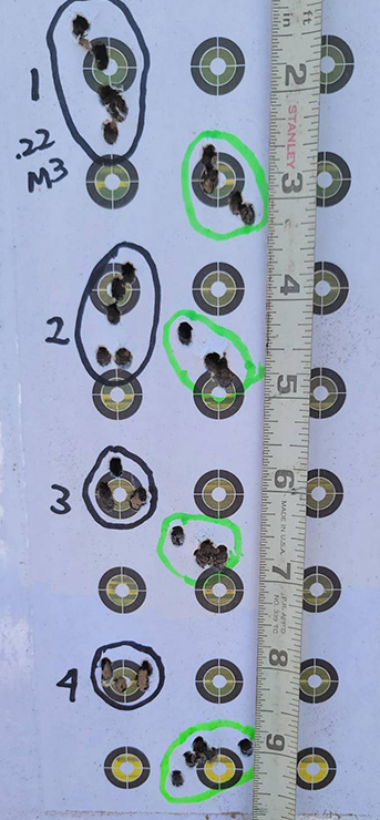

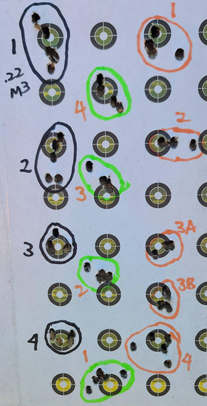

Somewhat encouraging results on the first pass at a redo this morning. Current settings: reg 1: 145bar, reg 2: 120bar, power wheel: 16, QTS: just over 4, valve: just over 4.5 bars - resulting fps: ~921
Groups tightened up a bit with 1 or 2 fliers in each 5 shot group. With 1 flier, I can accept that and attribute it to human error and the fact that I'm not an Olympic caliber shooter. The main grouping minus the flier is closer to what I've been used to with this liner. With the valve opened up more, air consumption has increased to about 2bars per shot whereas before I was only using about 1.1/1.2bar per shot. If/when I get the groups to where I want them, am I going to get greedy and try to get air consumption back down to a lower level? Of course I am!
Groups from this pass (circled in green - shot from bottom bullseye up):
Next round (circled in orange): keeping everything else the same, I tried turning in the valve 1/4 turn at a time to check its effect on accuracy and air consumption. Groups 3A/3B are tighter but just one quarter turn past that, the group (#4) opened up noticeably. Air consumption at the group 3A/3B setting is about 1.4bar per shot; fps is now at ~918fps.

Where I last left off (reg 1: 145bar, reg 2: 120bar, power wheel: 16, QTS: just over 4, valve: just over 4.5 bars – resulting fps: ~921), the results were getting better but as @qball mentioned, there was some up and down movement on the POI. In the MkII, 900fps with these 24.8g NSA was really accurate and I'm trying to end up back there for the best overall accuracy, noise level and air consumption.
So now with the following settings: reg 1: 145bar, reg 2: just over 110bar, power wheel: 14, QTS: 4, valve: 4, fps = ~900), I was able to put three consecutive 5 shot one hole groups! Have family obligations now so can't test further but seems very promising. Consistency is much better, a little less noise and air consumption is back to about the 1.5bar per shot I'm used to.
I think my original setting of 8 on the power wheel from my original move from the MkII tune was not enough hammer spring whereas the 16 I had it at this week was way too much for the 900fps I was after. At 14, it seems like we're getting close. Will shoot some more groups later today and update but much happier with this rifle now!

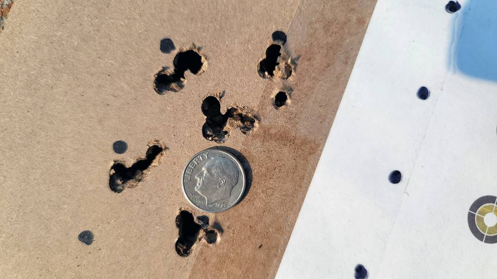

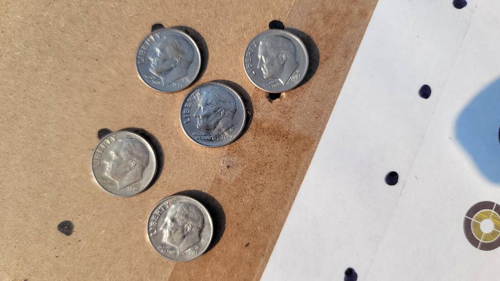

OK, I think I have this thing dialed in. Kept everything else the same and played around with the power wheel between settings 11 and 14 and found that 13 seems to be the lucky number. FPS is a little under 900fps at this setting but I'm loving the accuracy so I'm not going to bother messing with it any further. Attached below are the last five 5-shot groups I just shot - the first four groups were all one hole groups and literally on the 25th (and very last shot), I choked and yanked it a bit low and right to break the streak but pretty happy with the consistency now. Air consumption is now just about 6 bars for every 5 shots so just a hair over 1 bar per shot.
I went through a lot of air and slugs trying to figure this out but it was a great learning experience. Up until now, I'd mostly bought 2nd hand guns that came to me already tuned so this was the first time I had to tune an Impact from scratch and it was worth the effort. The moral of the story is, you can't be lazy and just move a liner from one gun to another and expect the exact same results without putting in some work!
Now the question is, do I fine tune the 0.25 M3 because while it is shooting very well, I lucked out with some random settings and it not nearly as efficient on air consumption . . . or should I just leave well enough alone??? Hmmm, do I ever learn?
Anyways, here are the groups (the black circular sharpie marks are my aim points, not a stray shot)...
