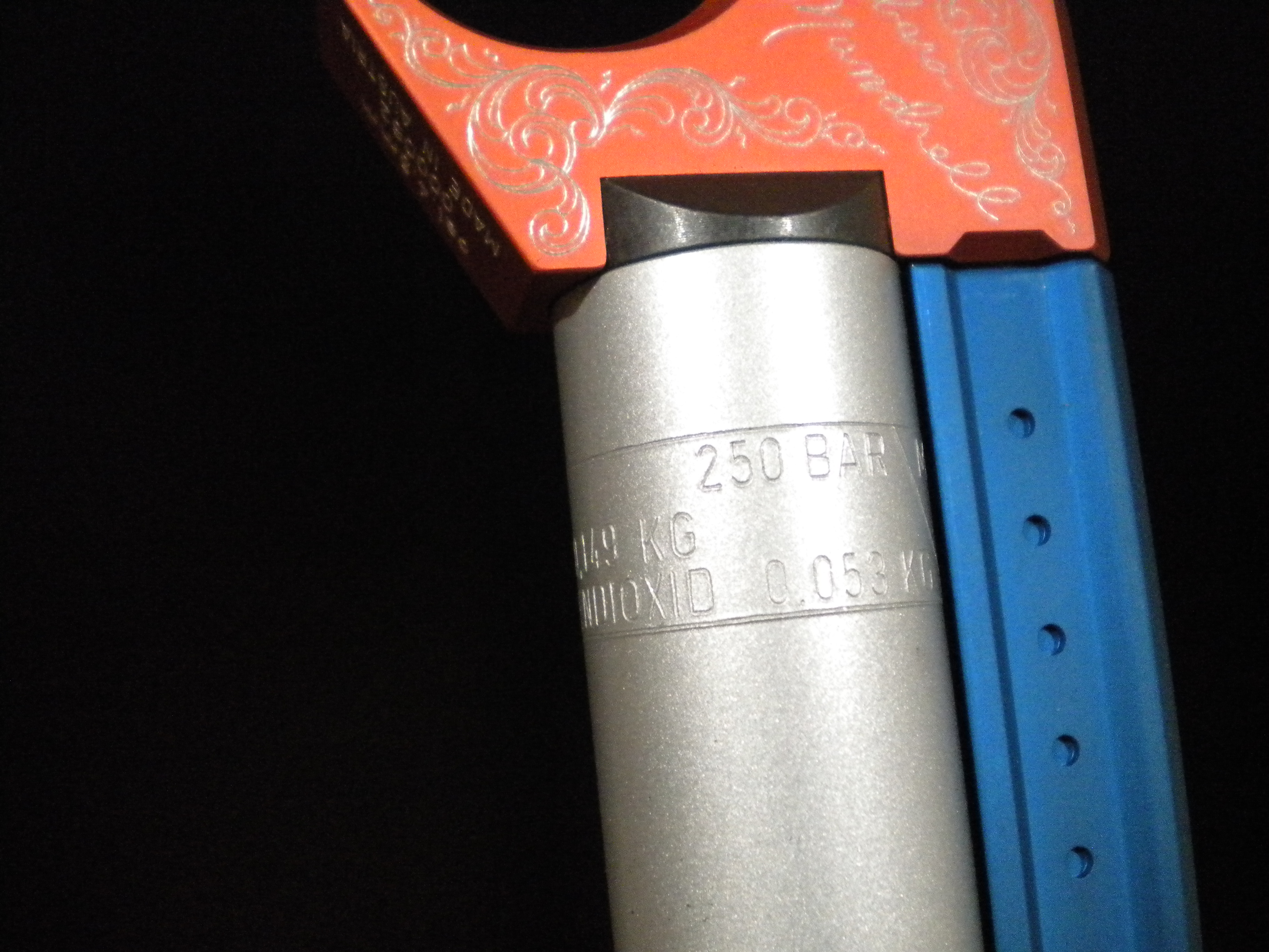

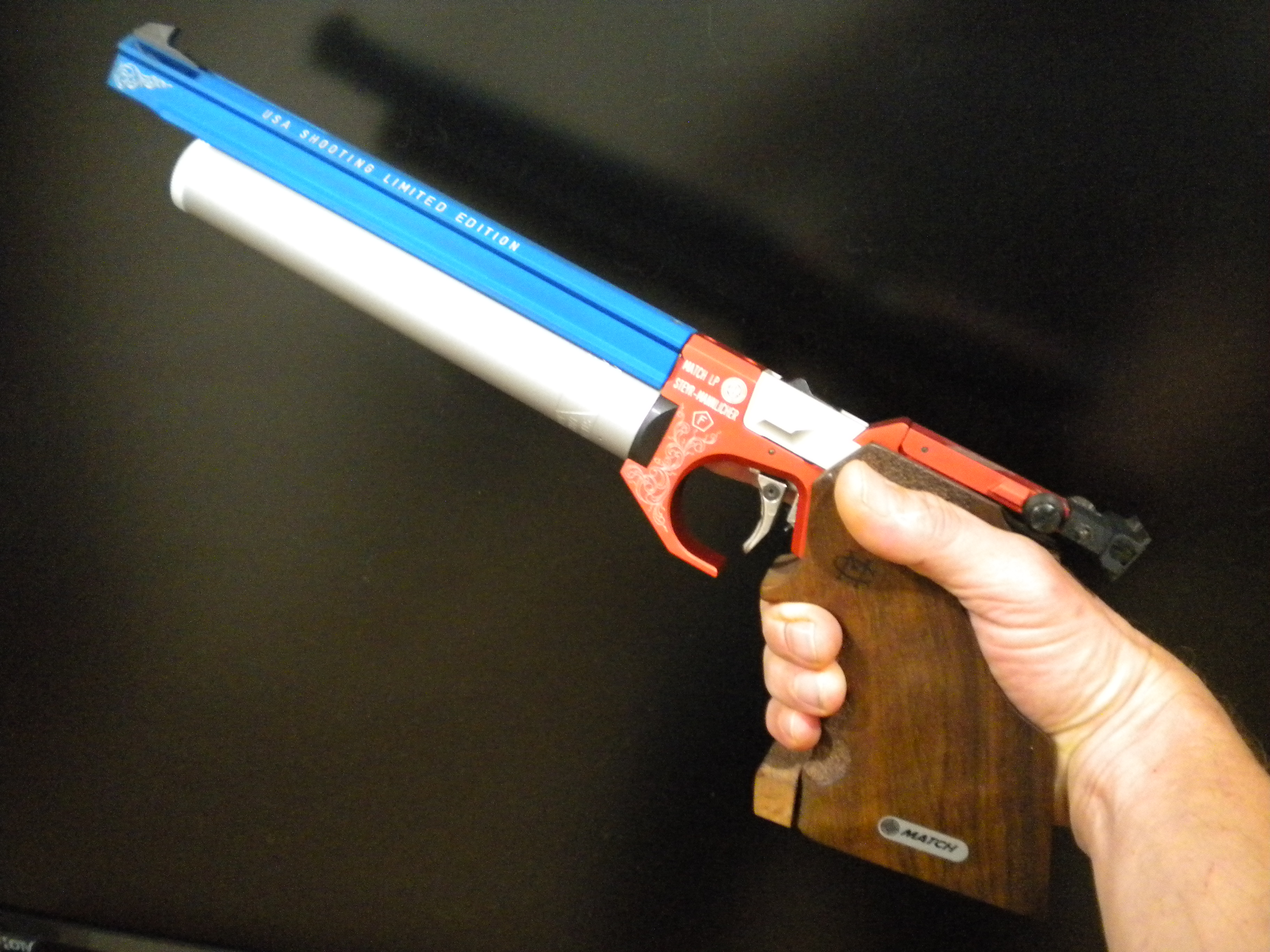

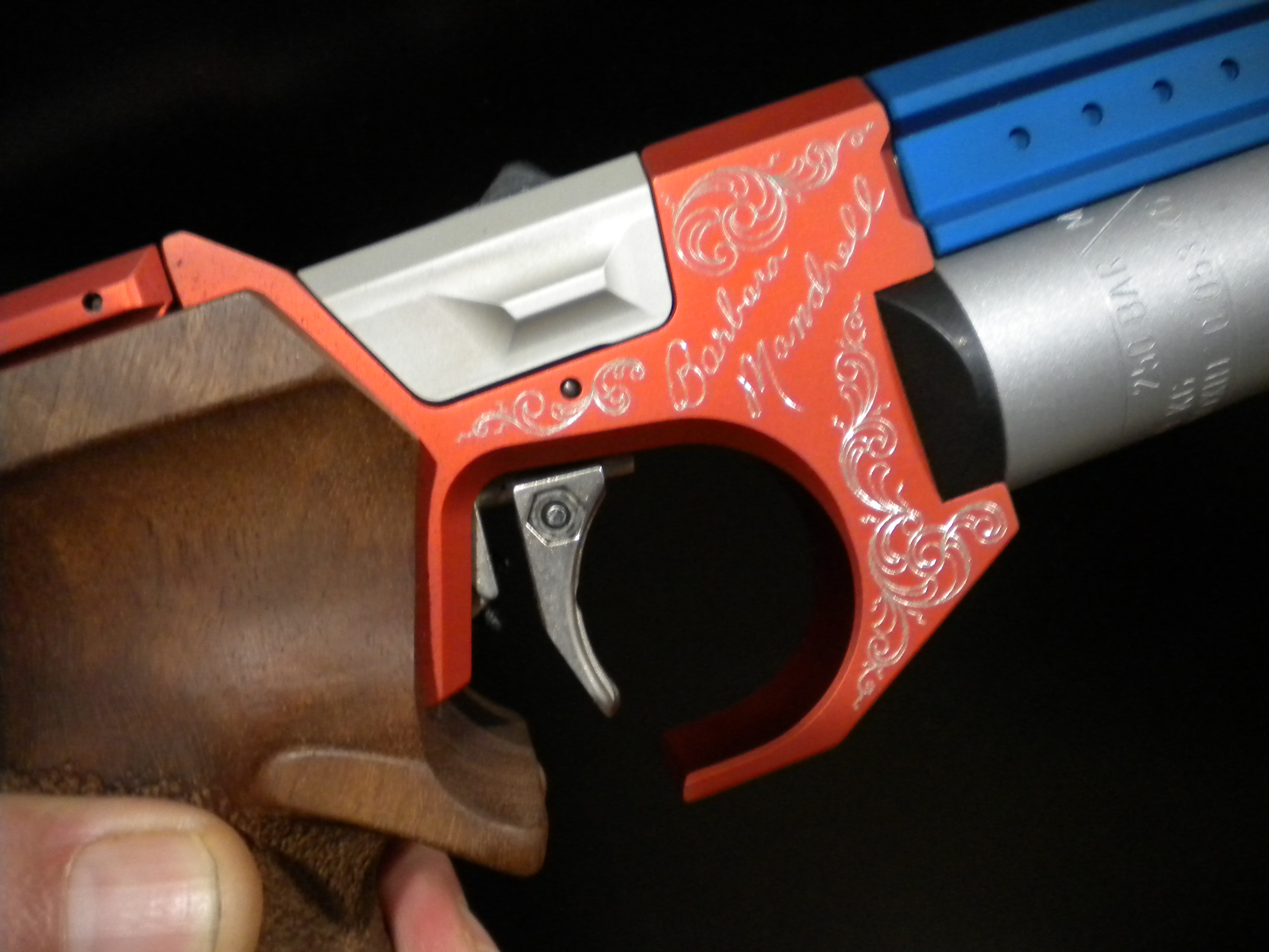

Steyr I can’t unscrew the CO2 cylinder of the pistol LP1. What’s the problem?
The pistol has not been used for a long time.
I don't believe that is a CO² cylinder, though it could be filled with CO². There should be a hole for a probe to fill it to 250bar high pressure air.
Is there a specific concern you are having that you want to remove the cylinder? It might still be under some pressure.
The pistol was converted by Steyr from PCP to CO2.It doesn’t look like there is CO2 gas in the cylinder. When cocked, the shot does not fire, only the click of the firing pin is heard.I want to return it to its original state, to do this I need to at least unscrew the CO2 cylinder. The cylinder is refilled from the thread side.
Try here-
My best guess is that it still has some pressure left or maybe reverse threads. Either way, one of the above manuals should help.

i would take the barrel cover and barrel off the pistol so you can get a good grip on the cylinder and unscrew it
and they would never take a PCP and convert it to CO2 that would make little sense, they did them the other way around
take the barrel off is my though the tank is just screwed on

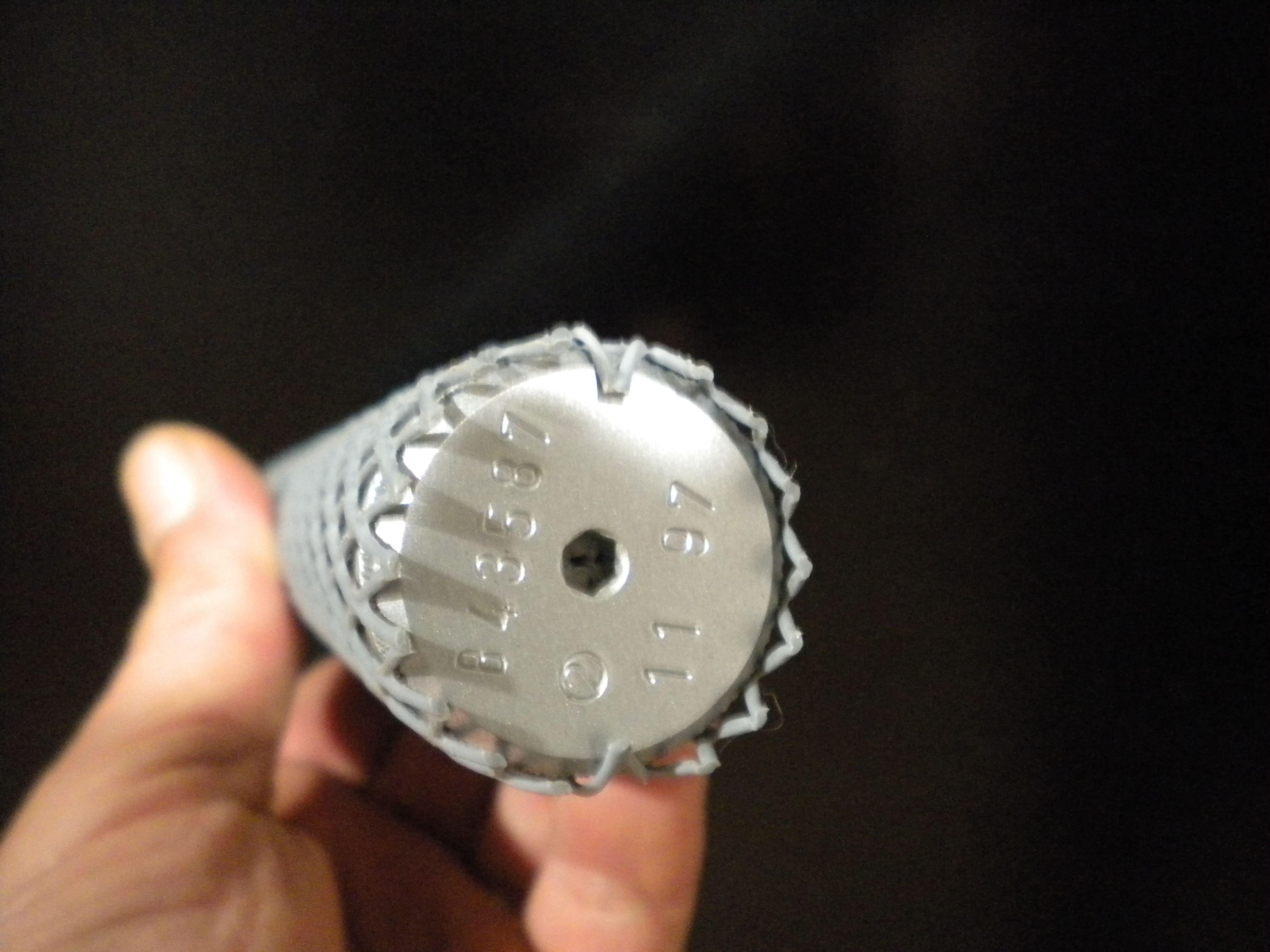

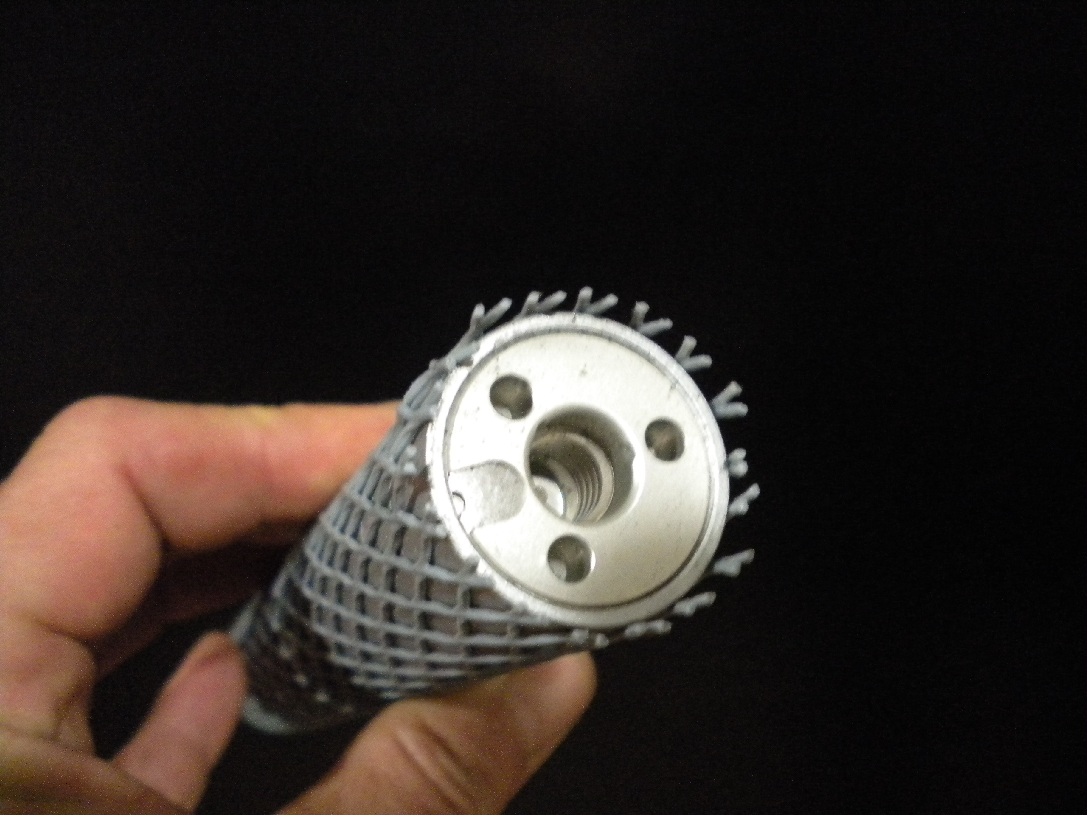

My pistol has never been listed on eBay. Yes, of course I know the history of my pistol.I didn’t know about 67 pieces, I thought there were about 100. but thanks anyway, I’ll try to unscrew it using your method. In my Tau-7, I use a special key to unscrew the CO2 Cartridges that was included with the gun. I also have all the tools that were included with LP1, but for some reason there was no tool for unscrewing the cylinder.
well there was a LP1 BM model in the last month and sold for 1000.00 and i thought that was cheap and it looked new for sure
i saw the hex also but wonder is that to tighten the cylinder or take the cap off

It isn't left-hand thread, nor should it require a tool to remove. I agree it probably wasn't converted by Steyr from PCP to Co2. The LP1 was one of few Co2 models that evolved at the manufacturer level to PCP; I had an LP1 and a Hammerli model that did.
Just because the gun doesn't fire does not mean it isn't under pressure. The firing valve might be broken, therefore not opening when the hammer/striker falls. That would be a very bad-case scenario, as it would render the problem virtually irreparable.
Hopefully the chamber cylinder is just stuck for whatever reason. Was it me, I'd apply heat to the juncture area, very JUDICIOUSLY. Heat often works wonders with stuck pieces, but I'm always careful to apply just enough heat to break loose the stuck parts without enough heat to melt seals.
Regardless, you'll achieve much better application of force on the chamber cylinder with the barrel/shroud off.
