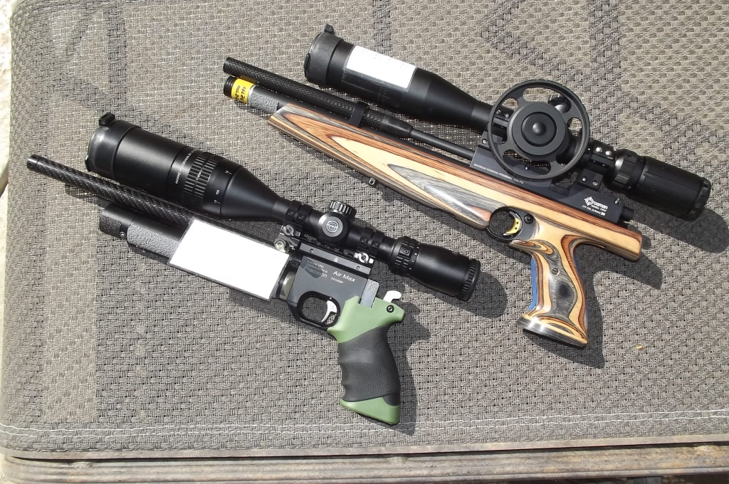

I could use a little guidance tuning my regulated 1720T

Nervous and Scott, thank you both for the input! I will open up the transfer path to .120" and see where that takes me, if I need to go bigger from there I can take another crack at it. Is there any reason I shouldn't just do some lightening on the stock hammer? I have a nice drill press and an X/Y vice so I can make holes in the hammer. The stock hammer weighs 58.6 grams, how much weight am I looking to loose, 25%? 50%? With the lightened hammer will I use the stock hammer spring which I calculate to be 8.5 lbs? I am calculating the poppet spring at 25 lbs, what should I be changing that to, and any advice on where to buy that spring?

I'm pretty happy with where I ended up on my tune. This is the basic final configuration I got to after much trial and error. I installed the Huma regulator set at 1300 psi. Opened up the valve exhaust and transfer port to .120" and the barrel port was already .130 from the factory. I was able to lighten the factory hammer to 42 grams with some judicious drilling from the rear of the hammer. Installed a lighter poppet spring that changed the static preload on the valve from 9.5 lbs to 4.5 lbs. I tried a significantly stiffer hammer spring but was not happy with how hard it made the gun to cock so I shortened the factory hammer spring by .250" (which did make the spring constant a little stiffer) and I am happy with the way that is working. The shot cycle 'sounds' good to the ear, nice and crisp. With 10.3's I am right on 11.5 ft-lbs but with the 8.4's I can only get to about 10.8 ft-lbs. I think I would either need to open up the flow path a little more or bump the reg pressure up to maybe 1400 to get the 8.4's shooting up at 12 ft-lbs. It doesn't really matter because it shoots the 10.3's better than the 8.4's and looking at the trajectory of both out to 35 yards there just isn't enough to gain by shooting the 8.4's.
String data;
AV = 710
ES = 6.59
SD = 1.41
38 shots from 3K to 1300 PSI.
I have some .750 Delrin in hand so I may make up a much lighter hammer at some point in the future to give that a try. But for right now I think I am just going to shoot it and have some fun!
Thanks to you both for all of the help!
Chip
