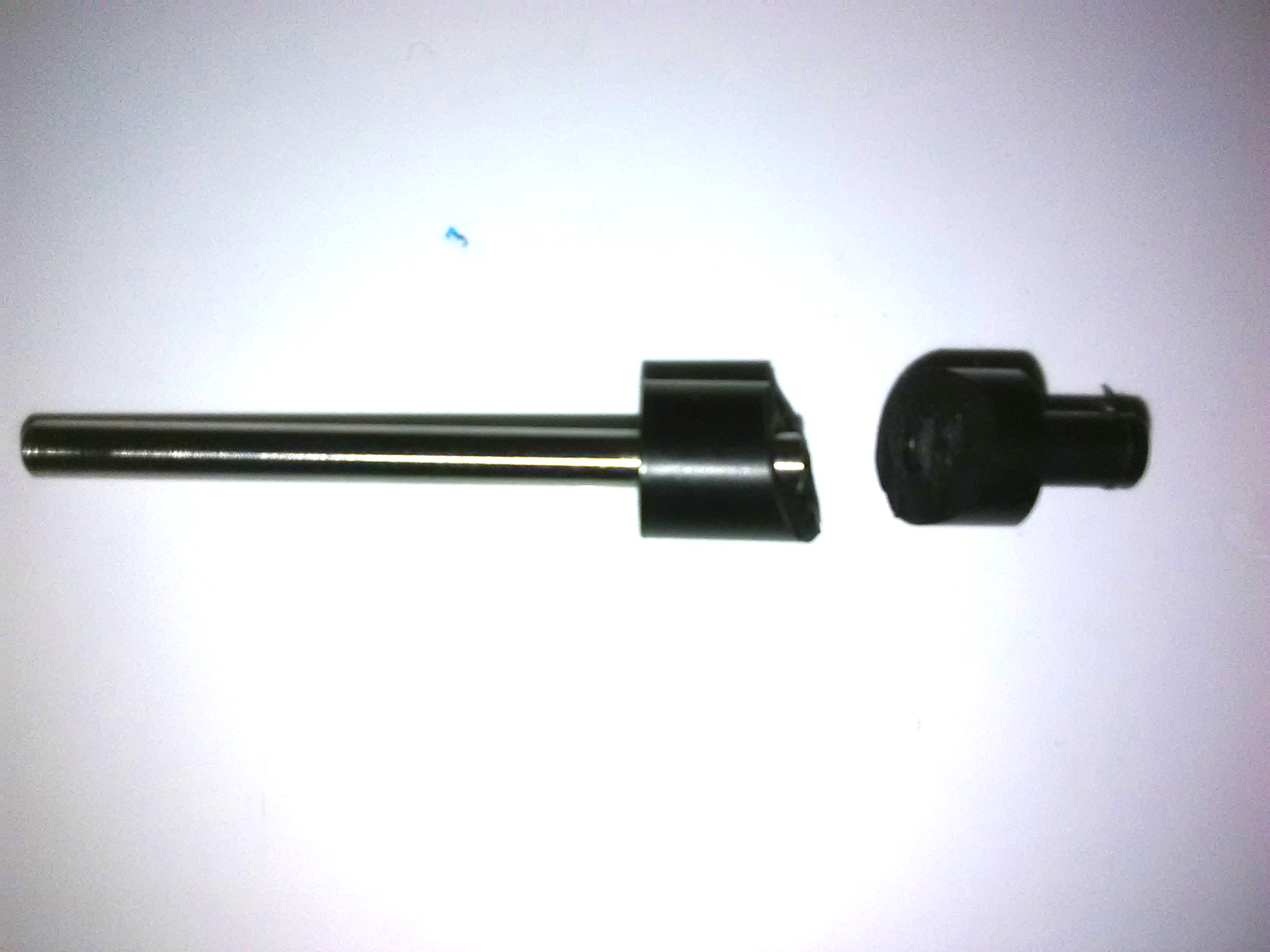

Bought Max .25 in October 2022, still trying to make a go of it. Problems began when worker failed to tighten shroud stack bolt, next was securing "warranty fix" spacer for unsupported stock center, followed by clipping caused by out-of-round shroud. Currently, two (OEM and replacement) broken valve cores (picture), due to unwanted "self-adjusting" of valve spring threaded cap, as suggested by Nervoustrig. (Firewalker is making a stronger replacement core while I try to purchase OEM from JTS.) Bright side of Airacuda ownership is knowledge gained of internal PCP functioning, my other PCPs don't require any such effort. 45Bravo has a series of YouTube videos which walk viewer step by step thru repairs, a highly appreciated effort. I feel your pain, having several higher end .25 PCPs in the fold, prior to Max purchase, has been a positive. WM

Bought Max .25 in October 2022, still trying to make a go of it. Problems began when worker failed to tighten shroud stack bolt, next was securing "warranty fix" spacer for unsupported stock center, followed by clipping caused by out-of-round shroud. Currently, two (OEM and replacement) broken valve cores (picture), due to unwanted "self-adjusting" of valve spring threaded cap, as suggested by Nervoustrig. (Firewalker is making a stronger replacement core while I try to purchase OEM from JTS.) Bright side of Airacuda ownership is knowledge gained of internal PCP functioning, my other PCPs don't require any such effort. 45Bravo has a series of YouTube videos which walk viewer step by step thru repairs, a highly appreciated effort. I feel your pain, having several higher end .25 PCPs in the fold, prior to Max purchase, has been a positive. WMView attachment 446313
