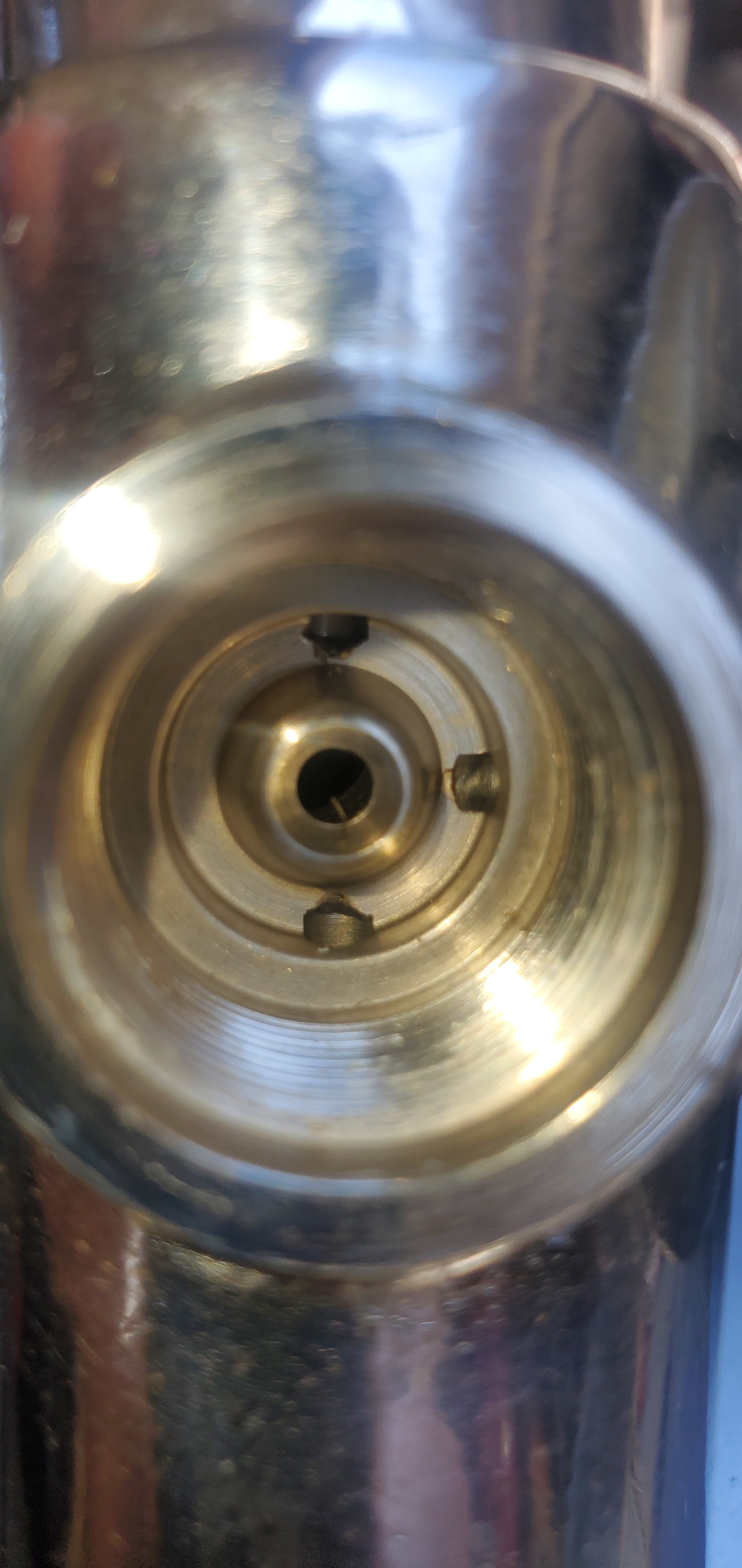

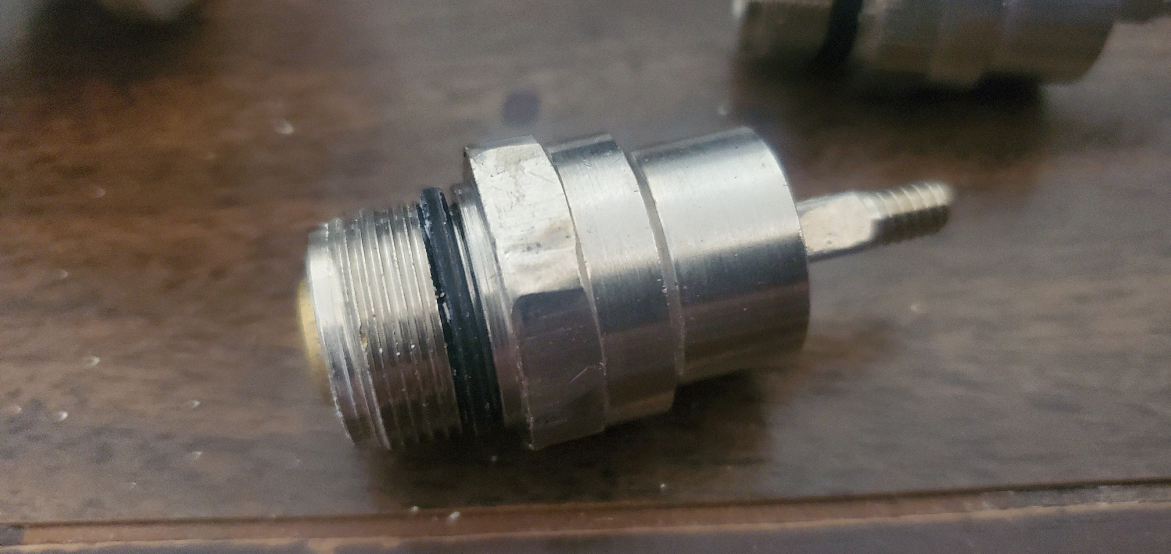

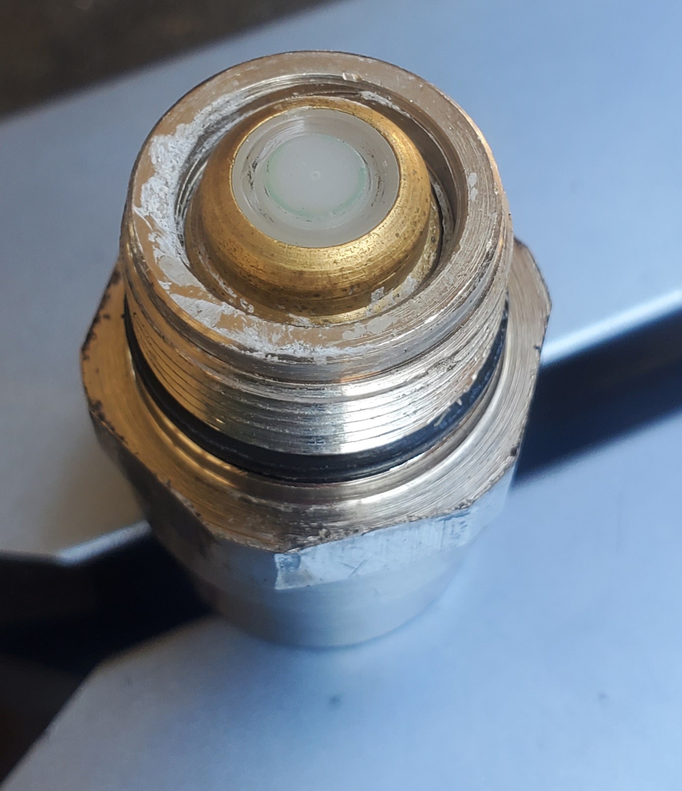

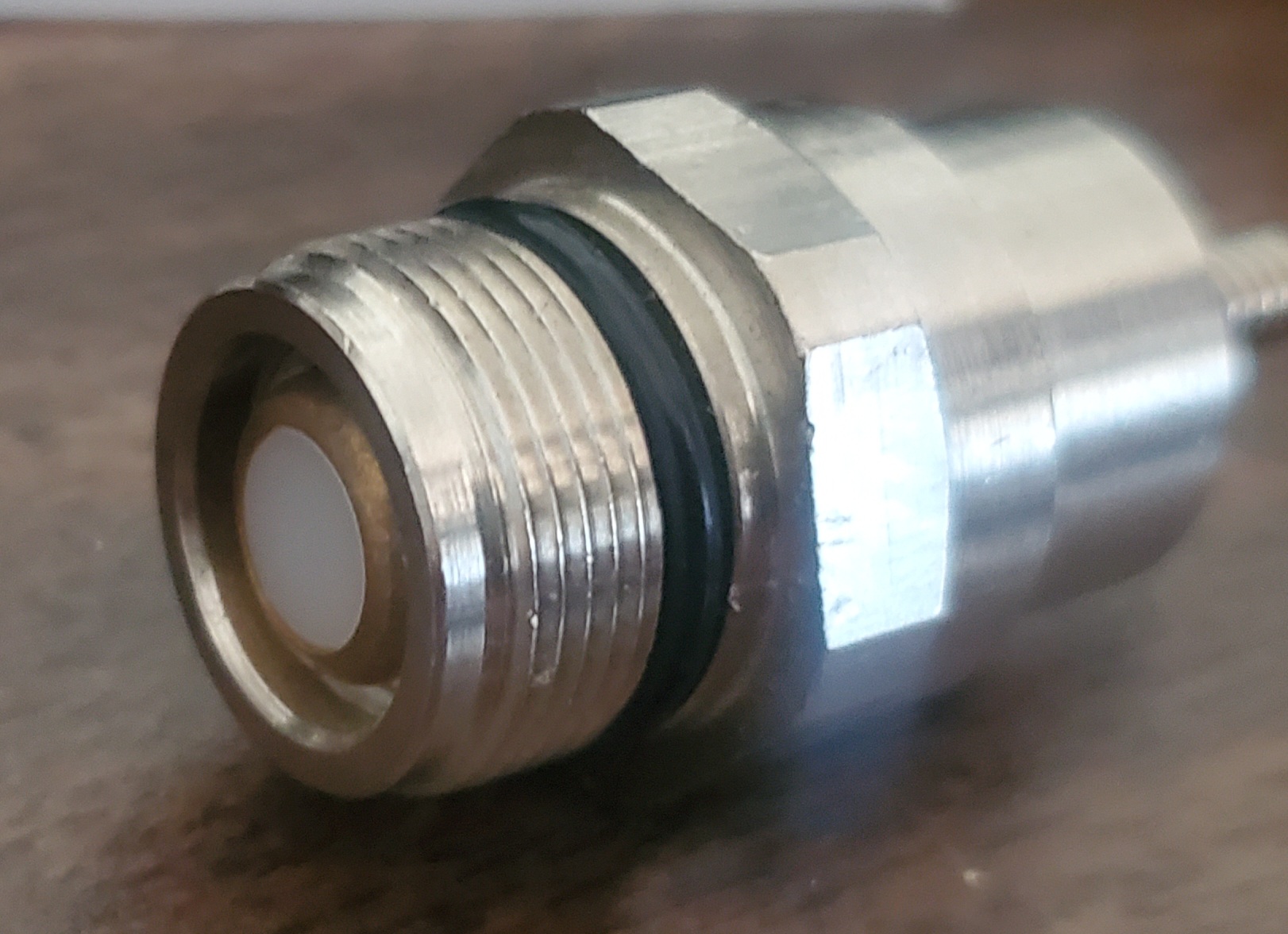

Here is the seat on the old valve. You can see the depression in the plastic seal
Vs. the new one.
Although it may still be good because I found this at the valve.
See the piece of brass there? 🤔

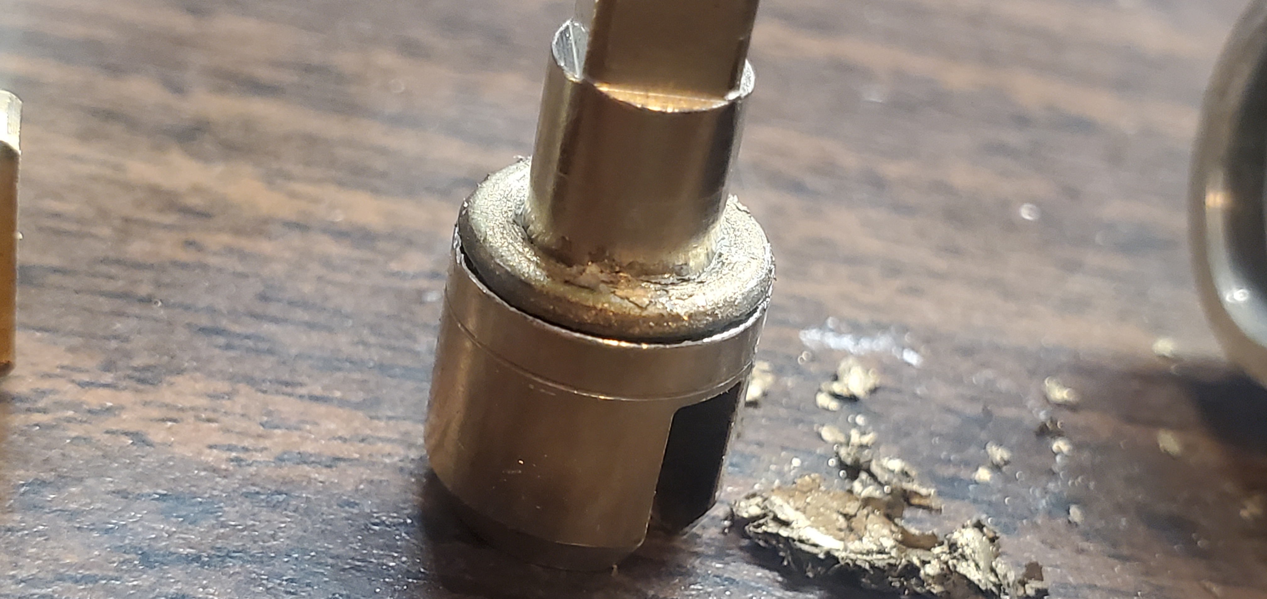

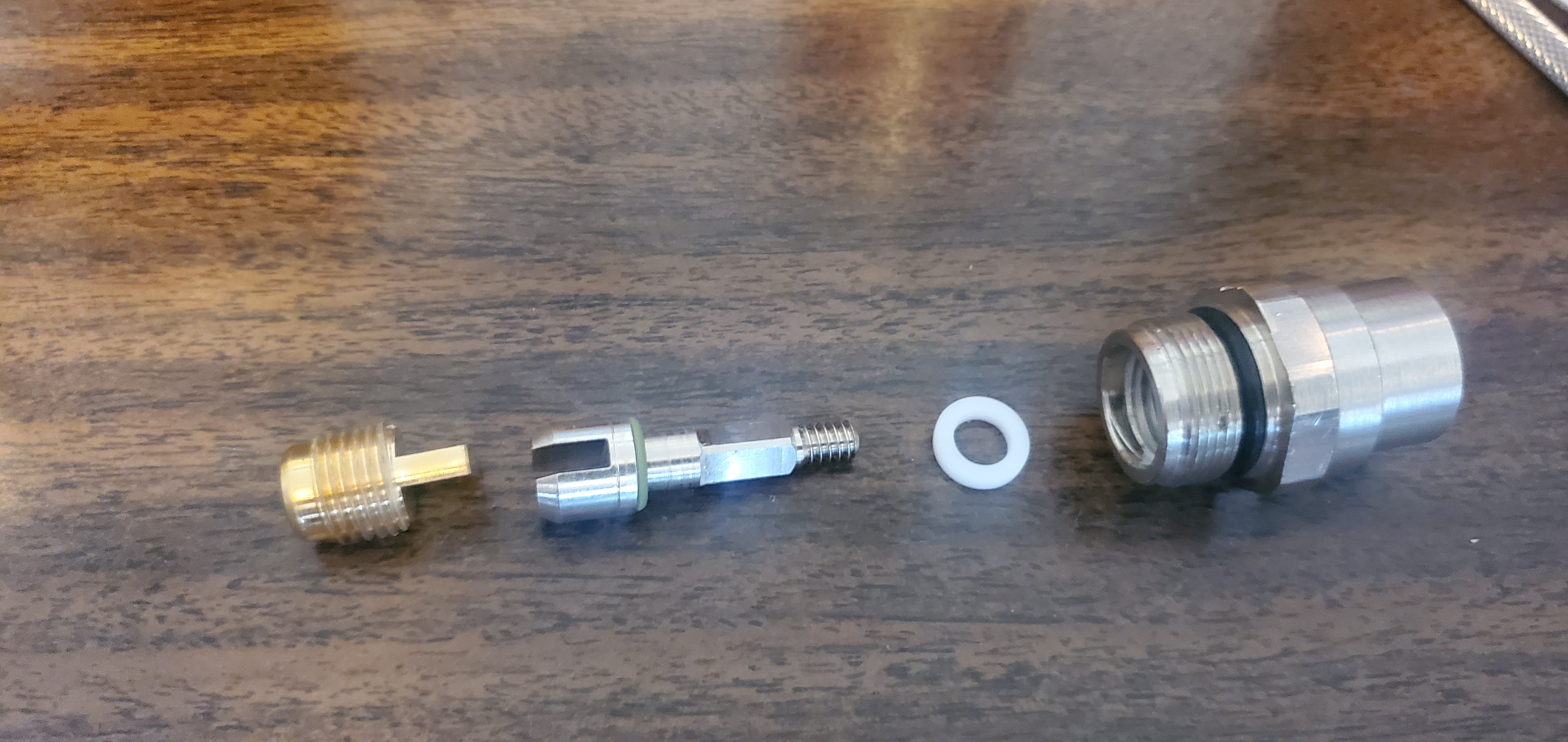

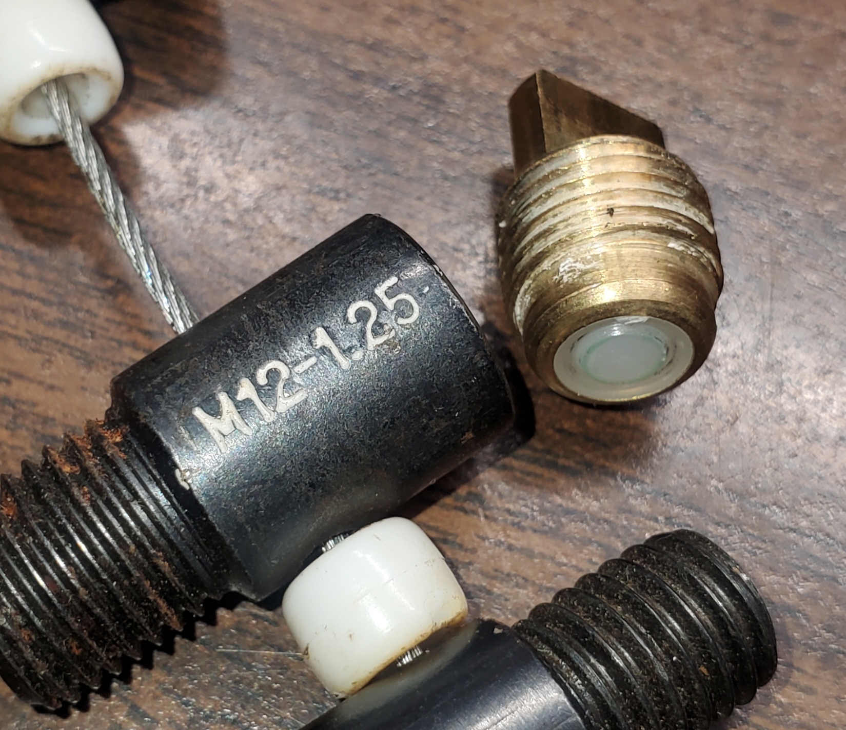

But it still leaked thru the stem when I had my finger over the opening. I tore apart the valve seal assembly and this is what comes out.
It looks like a brass or copper washer that disintegrated. Which is kind of weird as the new valve assembly doesn't look like it has one.
And yes my old assembly does have the delrin bushing in it it's just kinda locked in the old housing. I did notice that there a whitish cake like substance on the stem side. Maybe a dried out lubricant?

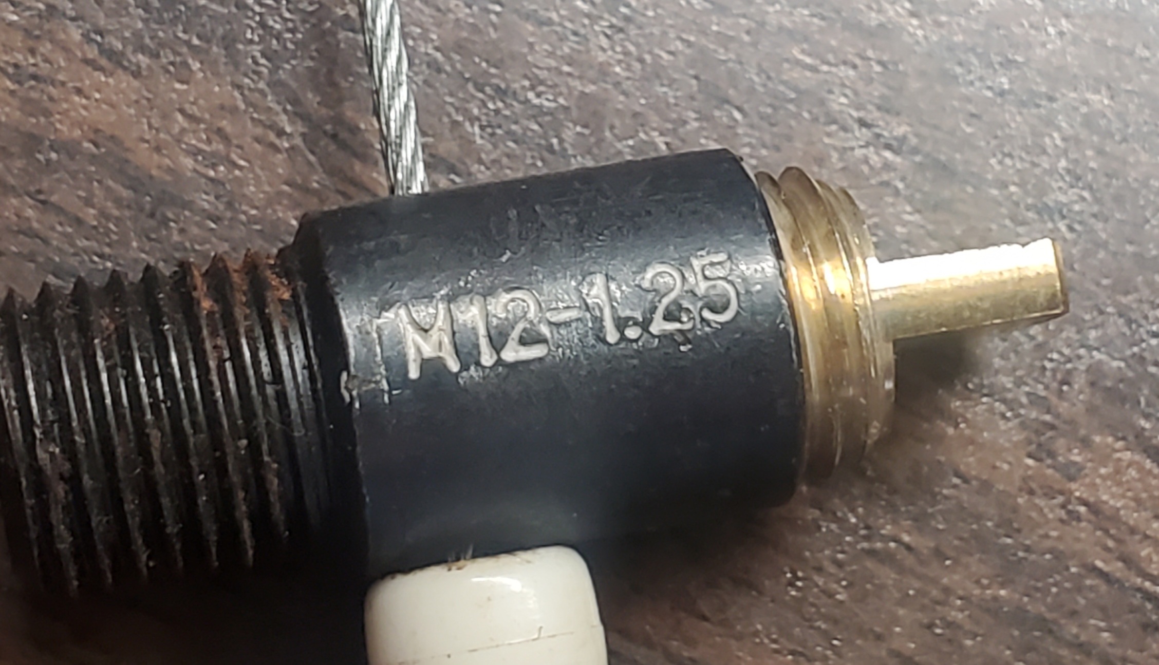

I was going to just go to a scuba or scba place that delt with air tanks or high pressure air but I only had Saturday off to go. Joe was open and more convenient that day. If you have re-sealed your JB valve please comment as to whether or not you were able to find a capable valve seat at a aftermarket source and if you know what valve would interchange with this.
The valve seal is a right hand metric threaded M12 x 1.25 , it does look very similar to other scba and scuba valve seals that were available on the net. I just was not sure of the thread size of the seal. Apparently many of the valve seals available that state the size are standard thread 1/2 - 20 unf.
