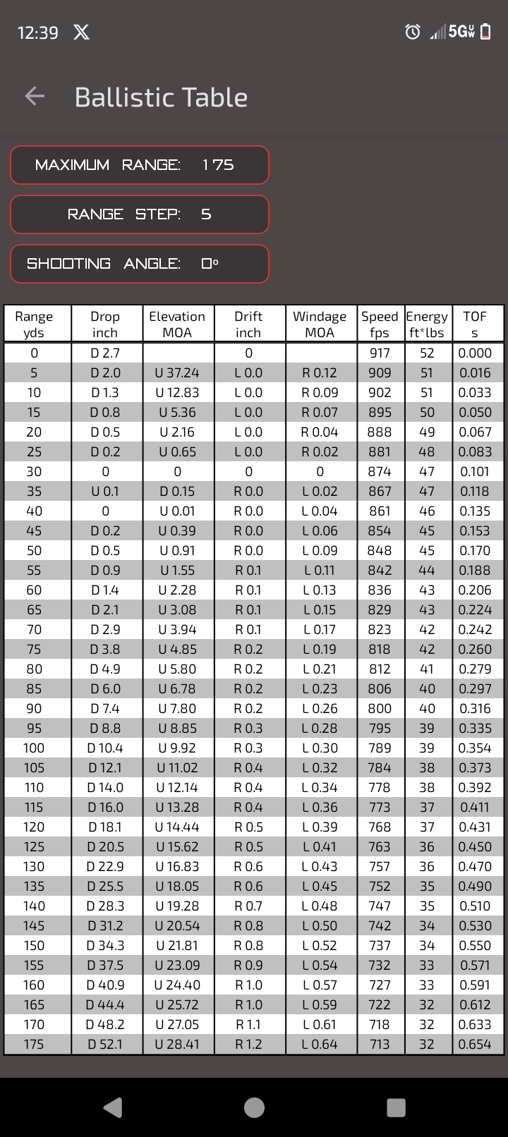

I've been trying to find a slug since April that performs great out of my .25 Dreamline's standard superior liner. By great I mean performs nearly as well as 25.4fx pellets in terms of accuracy... tried a QUITE A FEW. Nothing performed anywhere near as well as pellets, not well enough to give up the near perfect grouping capability of this gun with the 25.4 pellets. Why sacrifice MOA performance out to 100, 120 on a good day for some extra energy and range... Most shots aren't made at 120+... Best I got was H&N30... But at low velocity, pushing the 30gr past 900 from a dreamline sacrificed a lot of air. This weekend I got a bug up my butt and wanted to try one more slug. Hybrids were just OK, NSA didn't agree with my barrell, the original ZAN formulation was one of the worst performers, knockouts at 34gr was just too heavy. Then I saw zan changed the slug recently. (Recent to me). I bought a single pack of 28gr .250. holy crap. At 917.6 average. Hole on hole. This is at 50 and I'm holding groups no more than 10-15% wider than the AEA 25.3s I'm currently using as my new preferred projectile. I've seen the question asked before.. give the new ZAN slugs a try. Specifically 28gr .250. 915/920 is a good starting point. I tried them at 860,880,900 and 915... Every single increase tightened the pattern. I'm going to tinker a tiny bit more with pressure and velo. But actually excited. 40 ft lbs at 100y compared to 22fpe is huge.. still going damn near 800 at 100y

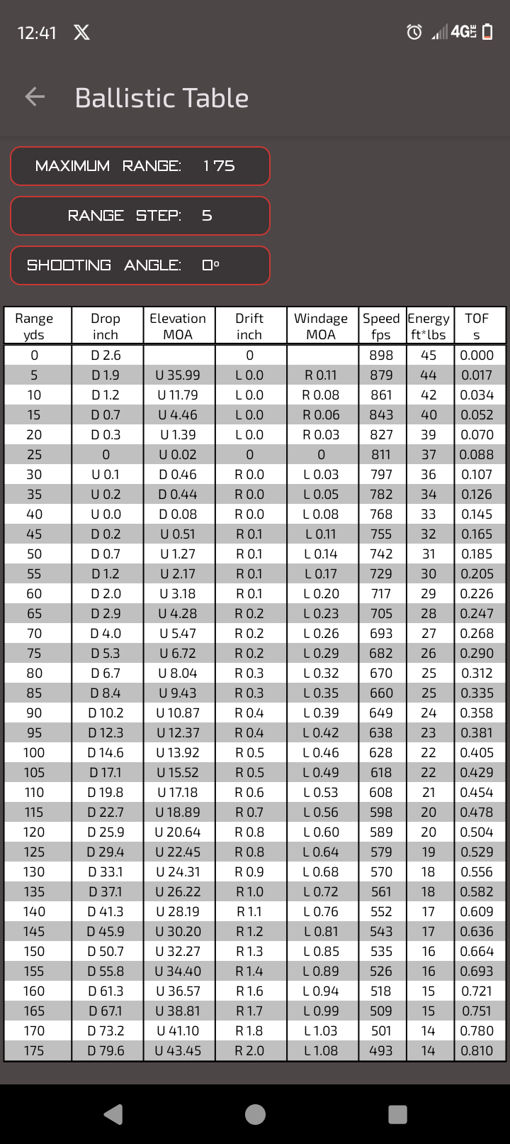

Look at the comparison.
Zan slug
AEA 25.3
