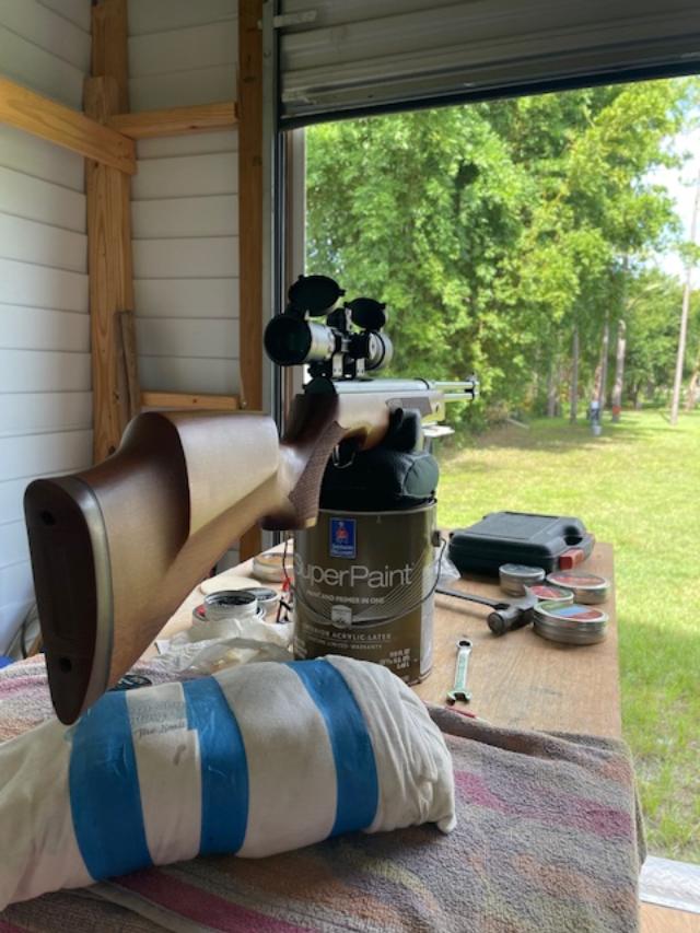

Off bags on a bench it's tricky. I find an old camera tripod with a foam pad on top works easier than bags. I find that holding the rear of the rifle rather than a tail bag works best. The rear rest makes more difference than the front one. I shoot circular patterns with a bag in the back. Things calm down when I just hold it against my shoulder.
The first rearward recoil will run into your shoulder and down a bit. This tilts the gun up slightly. Then the piston slams forward violently and jerks the gun up more. In my experience a springer will always shoot a little higher from a bag. I think it is because the gun only has one way to go...up.
Gel knee pads or seat cushions work well up front. Still a rested springer can be squirrelly from a bag. The little tripod seems the easiest way to get it under control. I have used two wide bags along the full length of the forestock and just held the rifle in the back letting the weight of the gun dampen the front. It works good with a long gun. Short ones not so much.
