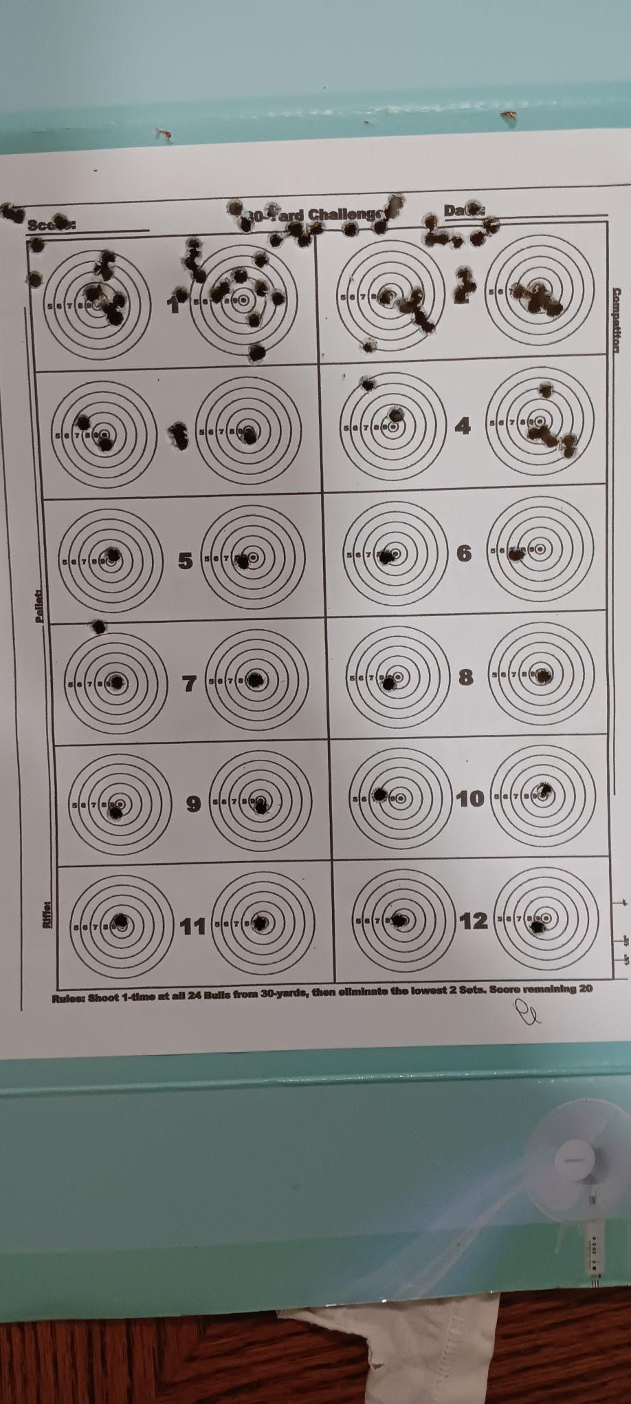

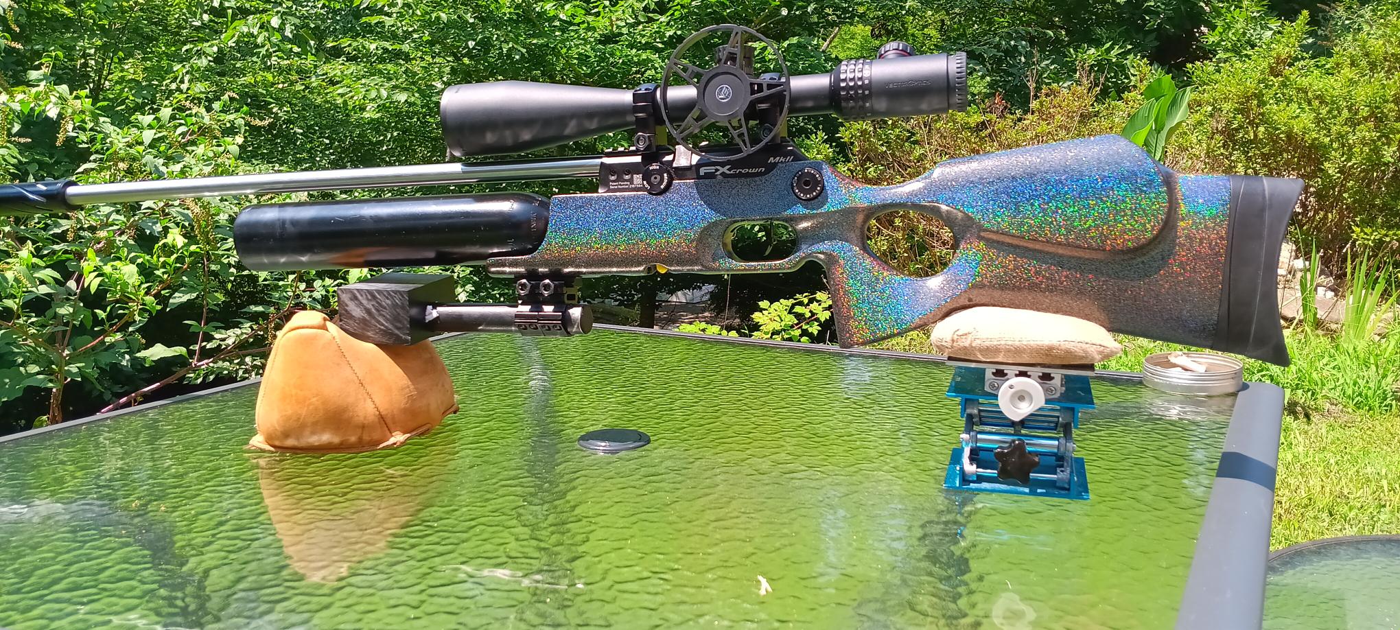

I have owned my FX crown for about a year and a half and have never been happy with it due to drastic point of impact shifts . I played with it until I gave . up and put it in the safe. It was useless a a competition BR gun . I like the features of the crown with it easy adjustability but in my opinion the barrel liner shroud system sucks . I have been wanting to put a LW barrel on it and finally got around to doings so . I sent the gun to Richard at Airgun Revisions and he put a WL stainless 22cal barrel on it . Richard is a master airgun smith and he does great work a reasonable price and he looks to improve the design however he can to do the best job . I been playing with it and find it to be very pellet fussy but it does like Air Arm pellets . No more POI shifts Here is a target that I shot today at 35 yards . I just cleaned the barrel so it too 40-50 shots on the top of the target to get the groups to settle down . Once it settled ,I shot a pellet at each target and was very happy with the results . I will keep experimenting with the tune to see if it can be tweeked but it certainly shows great potential for a competition BR rig . Here are a couple of pictures
