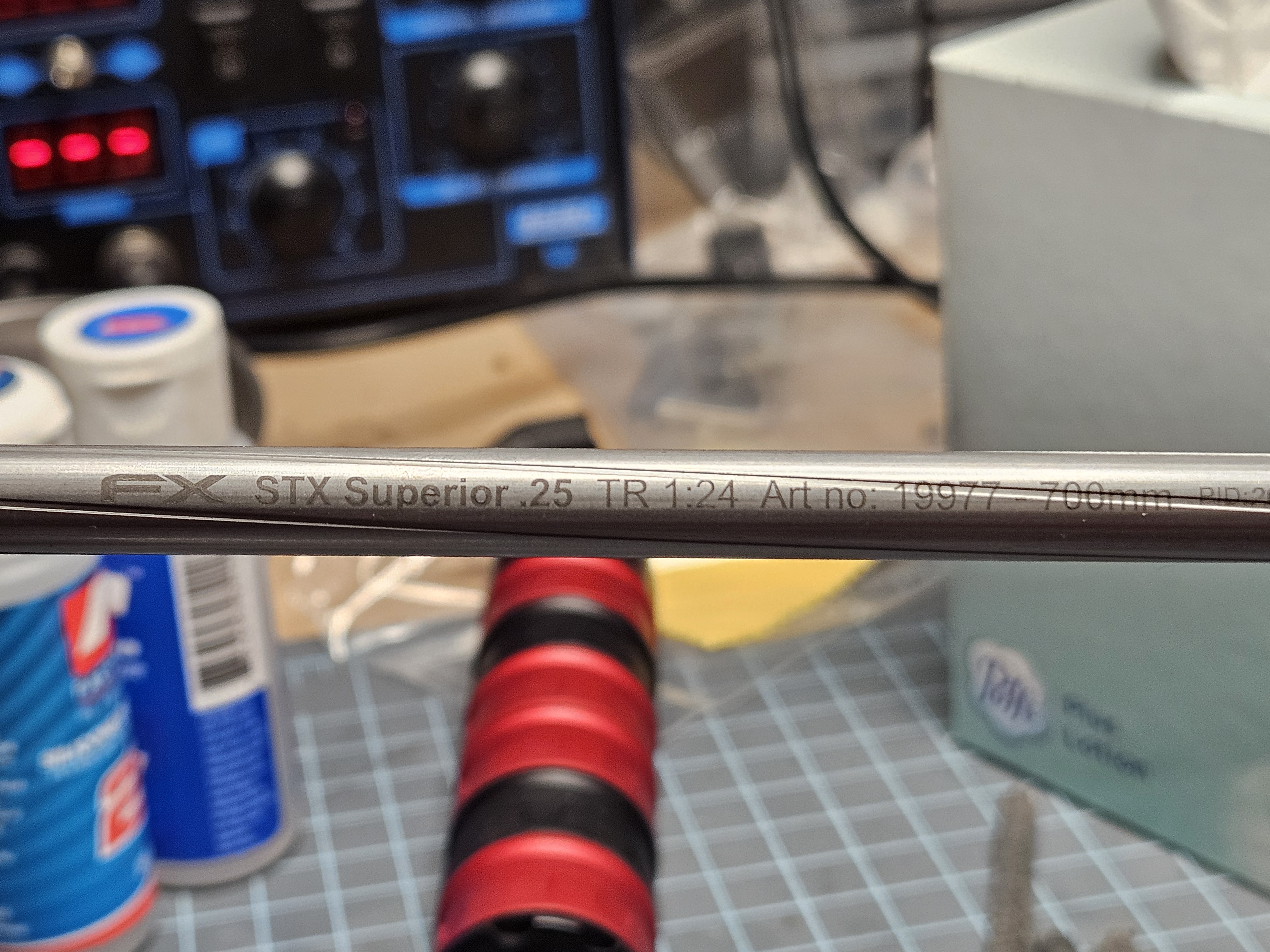

You have no choise - the heavy liners in .25 are with 1:18 twist rate
There are "slug liners" - 700mm in .25 with 1:16 but most of suppliers do not make difference between both :(
THAT is because FX in their infinite wisdom, or lack there of, uses the SAME part number for the barrels. Suppliers would actually have to look at the barrels to find the twist rate. Just like they change o-ring specs but don't update their drawings.

Easy way is to call them and ask them to look at the laser engraving on the liner to confirm.
It's definitely a 1:24. I really need this gun to shoot slugs. I need a projectile with a better BC and better energy retention for 100+ yard pesting. I'll give it one try and order a heavy liner and some heavier gr slugs. I'll try some JSB, Zan, and NSA slugs. If I can't get a good 100 yard group outta one of them I'll turn that liner into the most expensive fireplace poker ever and send FX a pic of it LMAO.
