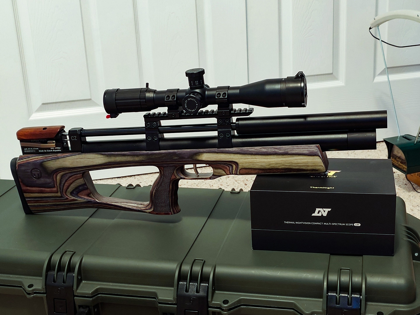

I just received earlier my Taipan Veteran 1 in .25 caliber! Pictured on top in the green laminate stock. I've had the .22 Long for 4 years and sold it a few months ago for the .22 Standard. I wasn't planning on buying another gun so soon but when I found out from a conversation with Taipan that the stock Talon Tunes had of the OG Veteran 1 .25 and .22 calibers both have CZ unchoked barrels, I had to jump on it. I've been thinking of getting a .25 caliber gun for a while now and now seems to be a perfect time to get another Taipan Veteran. Yes, yes, I know... CZ barrel, LW barrel perform the same... but I've just always wanted a CZ barrel on my Taipans.
I also bought a tactical stock for the new gun but I might leave the laminate stock on it for a while.
I haven't really shot it yet but in stock configuration, untouched as it came out of the box, it shot the JSB King Heavy at 789 FPS/47 FPE. With just hammer spring adjustment, it maxed out at 879 FPS/58 FPE. The hammer spring was not the limiting factor as it reached maximum velocity way before it was even close to the point of not being able to cock anymore. I then backed out the hammer to 2% less velocity to get 860 FPS/55 FPE. I have a Huma Air regulator for the gun but I might just leave the stock reg in it for now especially since it's practically already set to the velocity that I want to shoot the King Heavy at. I'm not sure yet about the shot count, but reading other people's experiences with this gun, I'm estimating around 30 to 35 shots on the reg at the 55 FPE power level. One thing I observed is that the hammer spring on the .25 caliber is noticeably heavier to cock than the .22 caliber.

I also installed the cheekpiece that came with the Tactical Stock. It looks a bit off with the green laminate stock but I really don't like the cold metal against my cheek. This was the green laminate stock that came with my Veteran Long (I sold that with the red laminate stock that came with my recent .22 Standard) and I found a renewed appreciation for this laminate stock. It also sets the .25 rifle from the .22 one that is in the Tactical Stock.

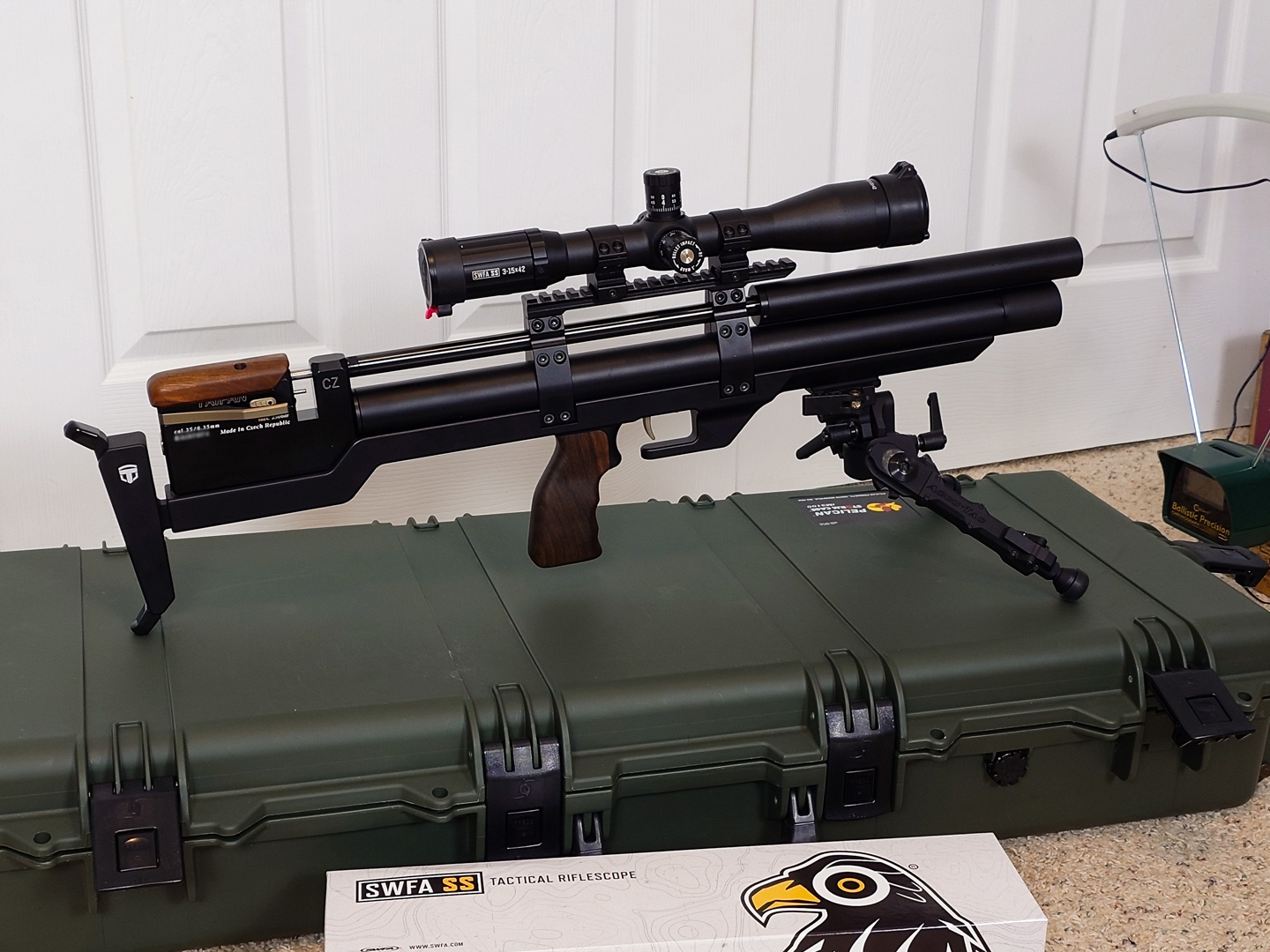

I finally had the chance tonight to do the initial sighting in of this rifle since I was able to sort the scope situation with it. It's the first time I shot this rifle shouldered and it has a noticeable kick compared to even a .22 at 40 FPE. I have it shooting the 33.95gr JSB King Heavy at 52 FPE.

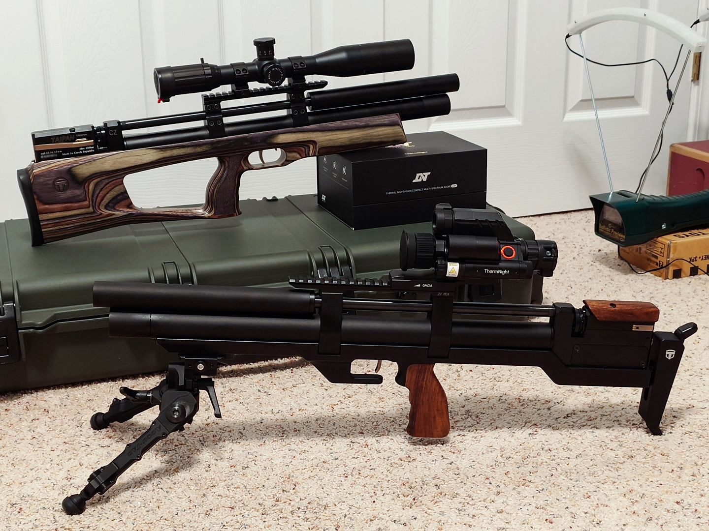

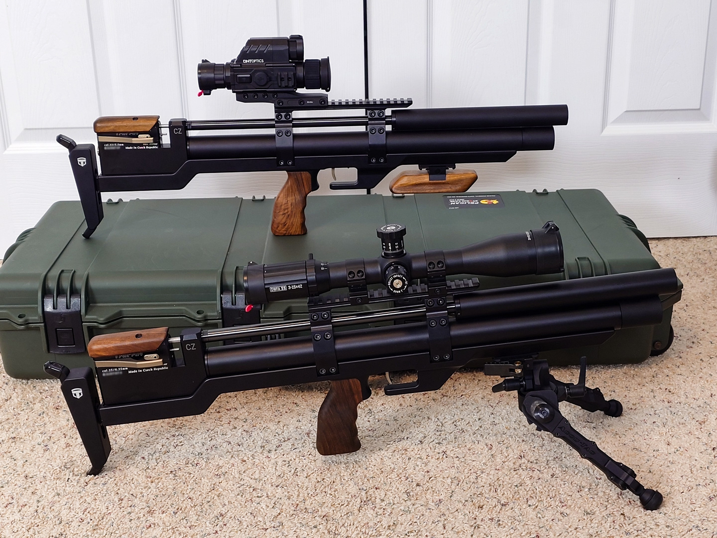

Here are the final forms (for now) for these two rifles. .22 caliber on top with the night scope, and .25 caliber at the bottom. Both have unchoked CZ barrels.
The .22 has the Huma regulator set to 88 bars shooting the 15.89gr Hades at 883 FPS. Gets a smidge over 60 shots from a full fill at 27 FPE.
The .25 has the Huma regulator set to 128 bars shooting the 33.95gr King Heavy at 835 FPS. Gets a smidge over 30 shots from a full fill at 52 FPE.
