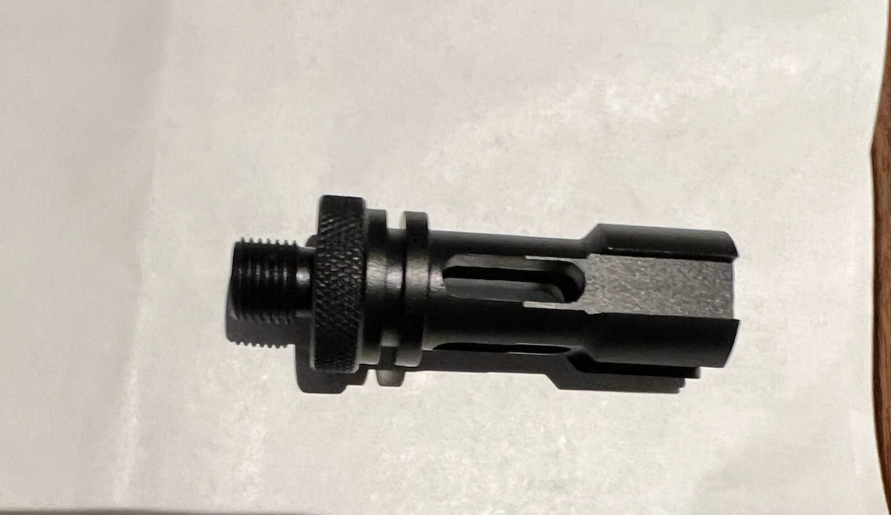

I have everything off the barrel I just can't get the shroud off the moderator & OEM adapter. Need to get my new adapter into the shroud, screw that assembly onto the barrel and then my Fatboy onto the new adapter. It appears the AOA adapter just press fits into the shroud.
I have everything off the barrel I just can't get the shroud off the moderator & OEM adapter. Need to get my new adapter into the shroud, screw that assembly onto the barrel and then my Fatboy onto the new adapter. It appears the AOA adapter just press fits into the shroud.View attachment 356842
Put a strap wrench around the knurled muzzle adapter. Then put the baffle insert in a vise(or vice grips). Put a leather belt in the jaws of the vise to prevent damage. You can buy a cheap strap wrench on amazon
You should not need to. The AOA adapter should thread onto the barrel inside the barrel shroud, then screw the Fatboy onto the end of the AOA adapter.
The OEM moderator assembly is pressed into the CF barrel shroud so tightly (or possibly glued) on my rifle that I could not get it out. I talked to a tech at AOA and he said some of them are this way. I'm going to get another barrel shroud when they get them back in stock and use that one with the new adapter/DonnyFL. AOA evidently sold right out of the replacement barrel shrouds, I'm not surprised. Thanks again for everyone's help here.

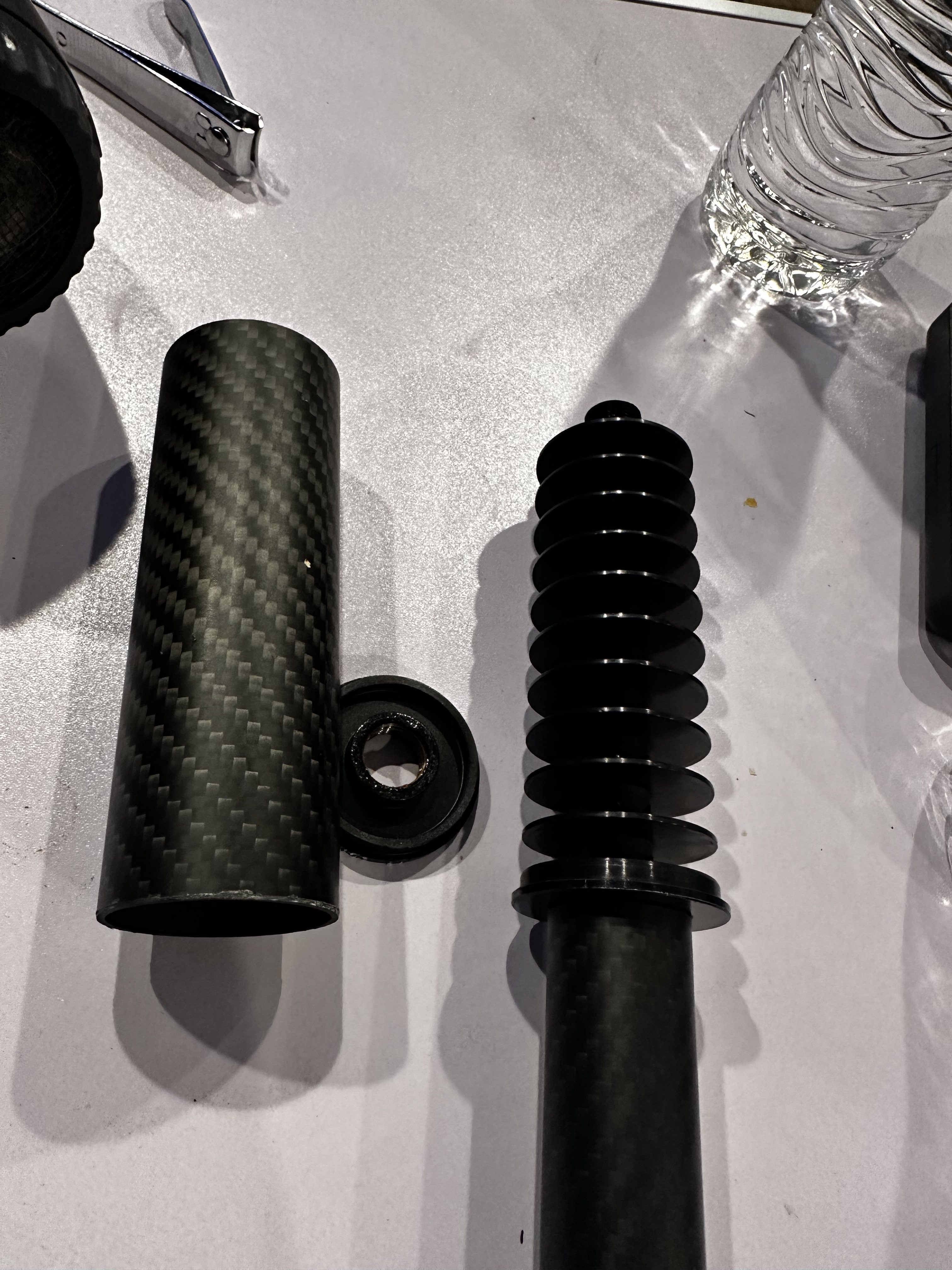

Sung: how did you separate the moderator cover from the baffles? Does the end cap unscrew or pop
The end cap is screwed to the baffle and the baffle is screwed to the barrel. So just unscrew the end cap that will allow you to remove the CF sleeve that covers the baffle, see picture. Then, unscrew the baffle, which is attached to the barrel. Once the baffle and outer barrel assembly is detached from the barrel, the baffle just pops out.
