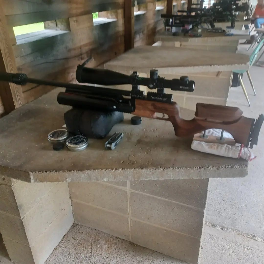

He did score well recently in a 100 yard bench rest competition with his unregulated Krale Bighorn. https://www.airgunnation.com/topic/first-outing-for-the-kral-bighorn-audad/#post-1262390
View attachment IMG_20220528_182114_300.1653778814.jpg View attachment IMG_20220528_182114_376.1653778814.jpg

My one unregulated gun is a Prod which has a Bstaley but the ES is still over 20 fps. My two regulated guns are generally better although the Avenger gets up to 30 sometimes. The P35 was 13 last time I measured it. You benchrest gun looks interesting and maybe it can get to this sort of velocity variation but my little Prod cannot.
