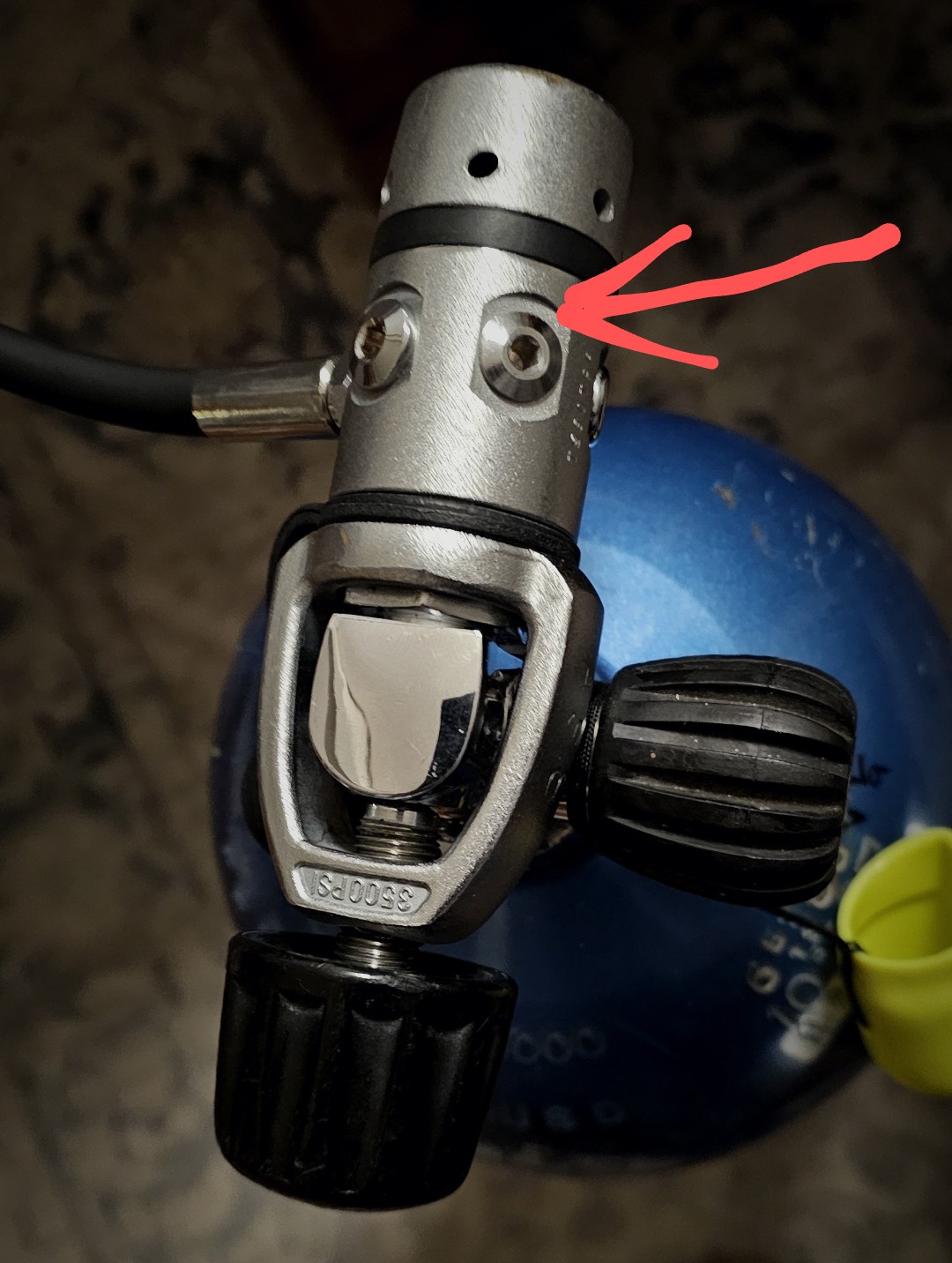

With the tank valve shut off, can one of these screws be loosened to drain the hose?

Having worked on hundreds of scuba regulators in a dive shop, an easy way to relieve the pressure would be to close the tank valve and then slowly unscrew one of the screws pointed at in post #22. There might be one or two ports on the scuba reg that have HP stamped near the port, it stands for High Pressure, don’t loosen that one, loosen one of the other ones, they only have 130psi under them. Just loosen enough for the O ring to extrude out (along with a startling POP and then brief air release. You can wrap the reg and your allen wrench with several layers of a towel to minimize the POP. You will need a new O ring for that port plug. No big deal.
