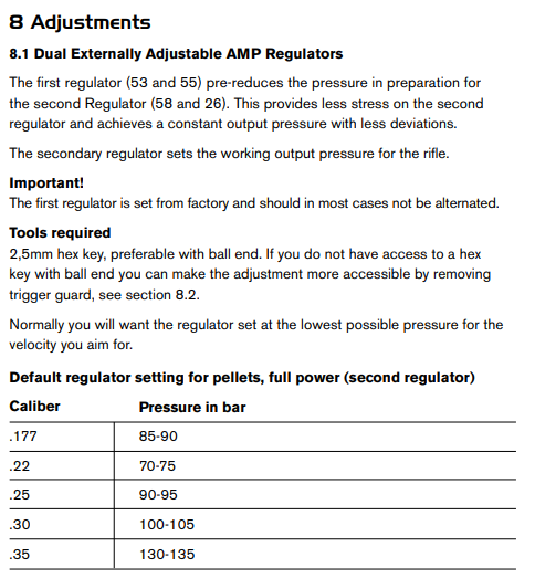

The gun has been stored in a case in a cool, dry closet. It has been stored with tank pressure is 210 bar.
The 1st reg was set to 200 bar and the gauge reads 200bar.
The 2nd reg was set to 150 bar and the gauge reads 155 bar, so it has crept 5 bar during the 6 months of storage.
That's an insignificant about of creep in 6 months. I would dry fire a couple times to make sure your reg resets accordingly. Also why increase the 1st reg to 210b rather than just removing it? Genuinely asking.
That's interesting. Your M3 came with the first set to 200 bar?
if you have upgraded to the power block and other odds and ends along the way these would be somewhere around 10bar lower because those upgrades actually make the gun that much more efficient.
