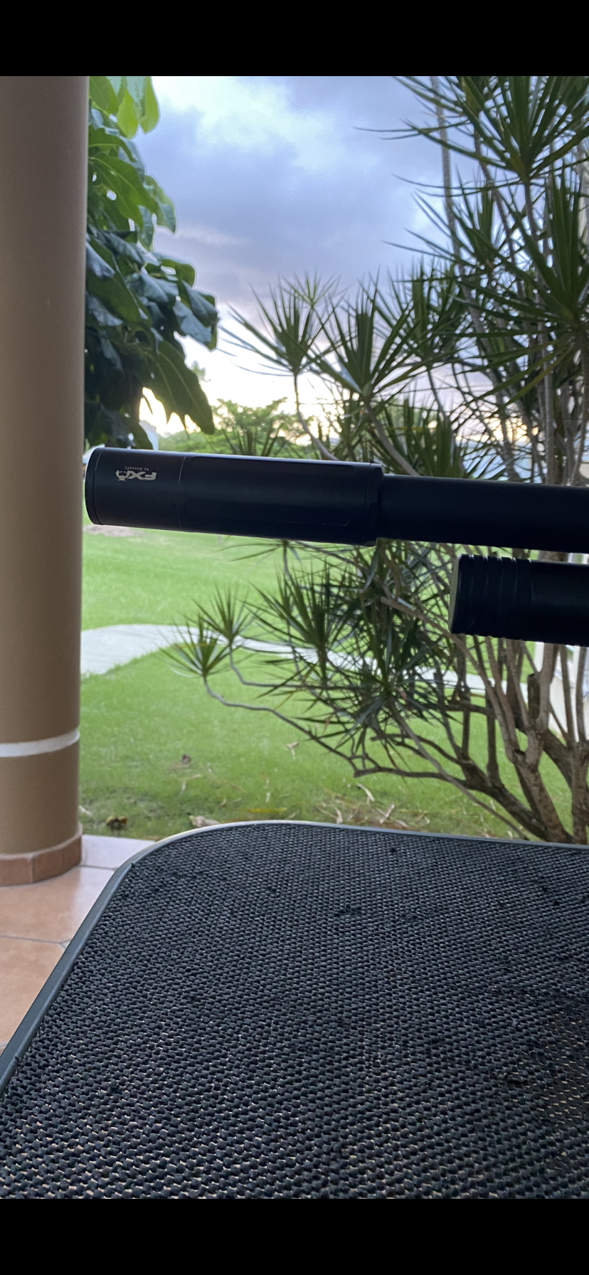

This are my others two airguns with the Sumo and FX moderators attached to each one. I also have another first generation wood stock Avenger that I am selling locally since I don’t live in the states.
