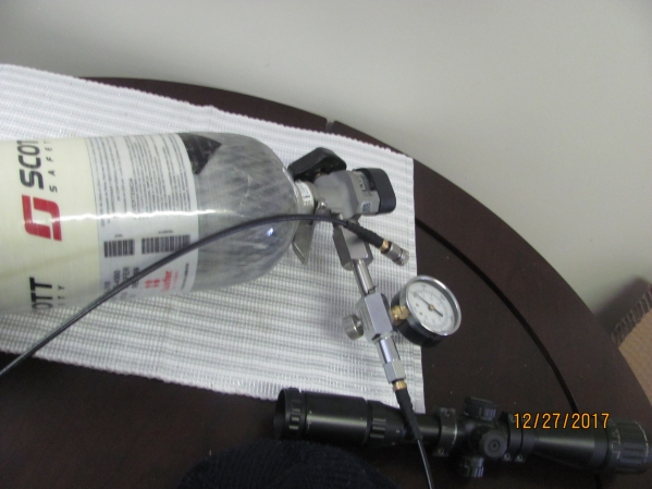

A Fireman tank is an " scba " tank, easy to research.
Does it look at bit like this?
If so many of the sponsoring dealers carry what you need.
You could also go CHEAP and chance an unknown chinese ( other ) adaptor but do keep in mind yoand or loved on es can die if something lets go.
I went with the lowest cost fill unit I could get from a well know U.S. dealer.
John
"LSS152"I am not sure. My brother got the tank for me, and I pick it up on Friday . It is a Fireman type tank. I called a local dive shop and they said as long as the Hydro was ok that they would fill it for me.
Did the Scuba place say they will fill it to 4500psi? Some will only fill you to 3000psi. Ask them. If you get the right equipment, you can fill your tank yourself. Just discussing the Shoebox F10 on sale right now for $500? I guarantee you will go through that tank fill faster than you can imagine, at least at first.
