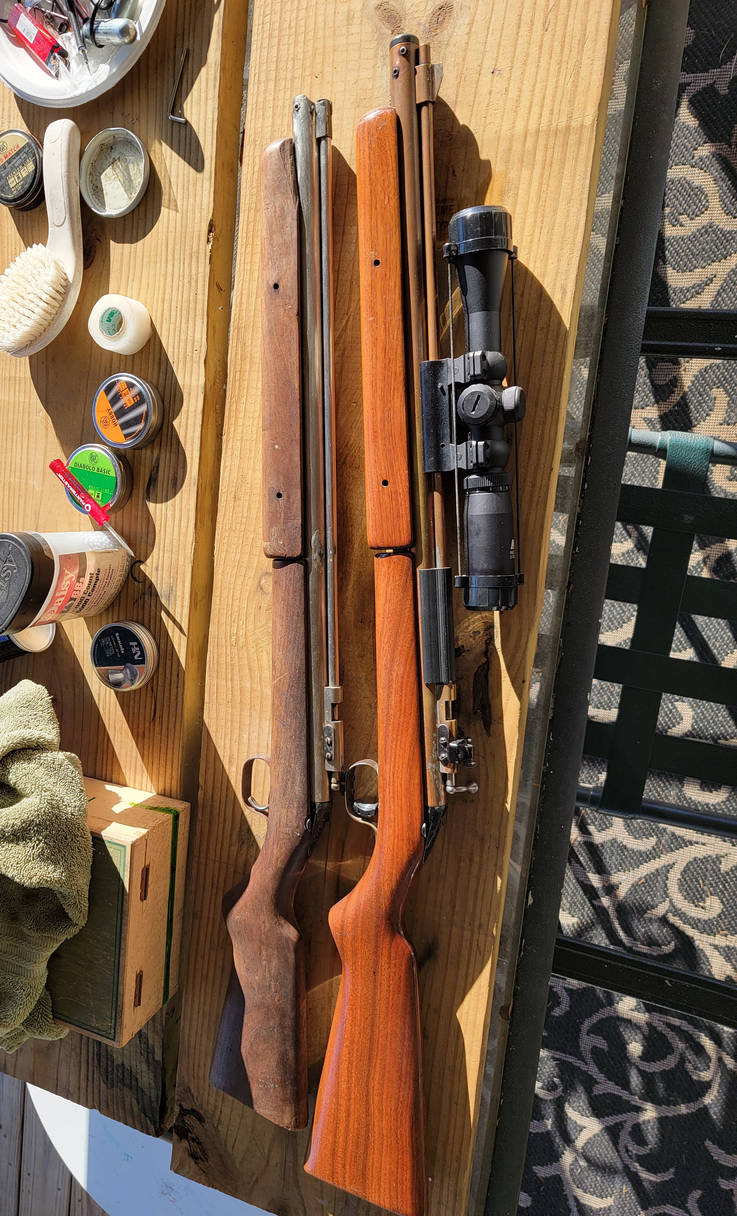

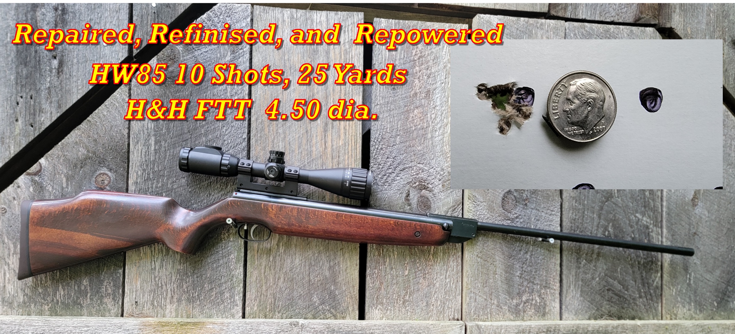

So glad that I took the time to bring this rifle back to life. I purchased two HW85s from the same gentleman. One of them was functional, while the other ( the rifle pictured ) had a broken cocking shoe, a torn piston sleeve and a badly split stock on the under side of the forend where the cocking lever blasted through it when the cocking shoe let go. The stock was rough. Full of dents, scratches, and gouges. The metalwork was still pretty nice. Some light surface rust that left some freckling after I buffed it off.with the time tested OOOO steel wool and Balistol. Otherwise, considering its age and evident lack of care, the bluing was surprisingly decent.
I tore it down and thoroughly cleaned every part. I installed an ARH Hornet kit and lubed the gun with the proper lubes in the proper places, and then I went to work refinishing the stock. Took her for a spin tonight. Time well spent on this one...

i see the rifle is a shooter and the pride of bring a gun in disrepair back to what you have is always a nice feeling
but i well ask, are you happy with the stock ??
Thanks. While the stock job was admittedly not my best work, I am pleased with it. Especially, when I take into consideration the condition that it was in when received.

Well that stock refinish is definitely something to be proud of. That group at 25 yards is also something to be proud of. Great job. I do hope that I bestowed the proper amount of attention required for the effort that you put forth. Any way... "you done good"!
Kenny
Thanks Kenny. Very much appreciated.
