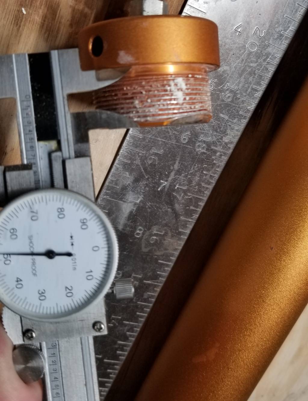

Hey Off_target, glad you escaped relatively un-harmed! It would be great if you could take some detailed photos of your failed filter and post them. Looking at Centercut's filter it looks like the wall thickness is much greater and the threads go much deeper, farther down the inside diameter. Makes me think that the threaded area on your cap much be much shorter since the threaded area on the tube is shorter. A lot of us use these filters (me included) so being able to compare what you have that failed to what we have will help us all make a decision to keep using what we have or not. I would hope you would also send photos of the failed filter to the vendor so that if he has any moral compass at all he will stop selling them. Once again, glad you were able to walk away from that disaster!

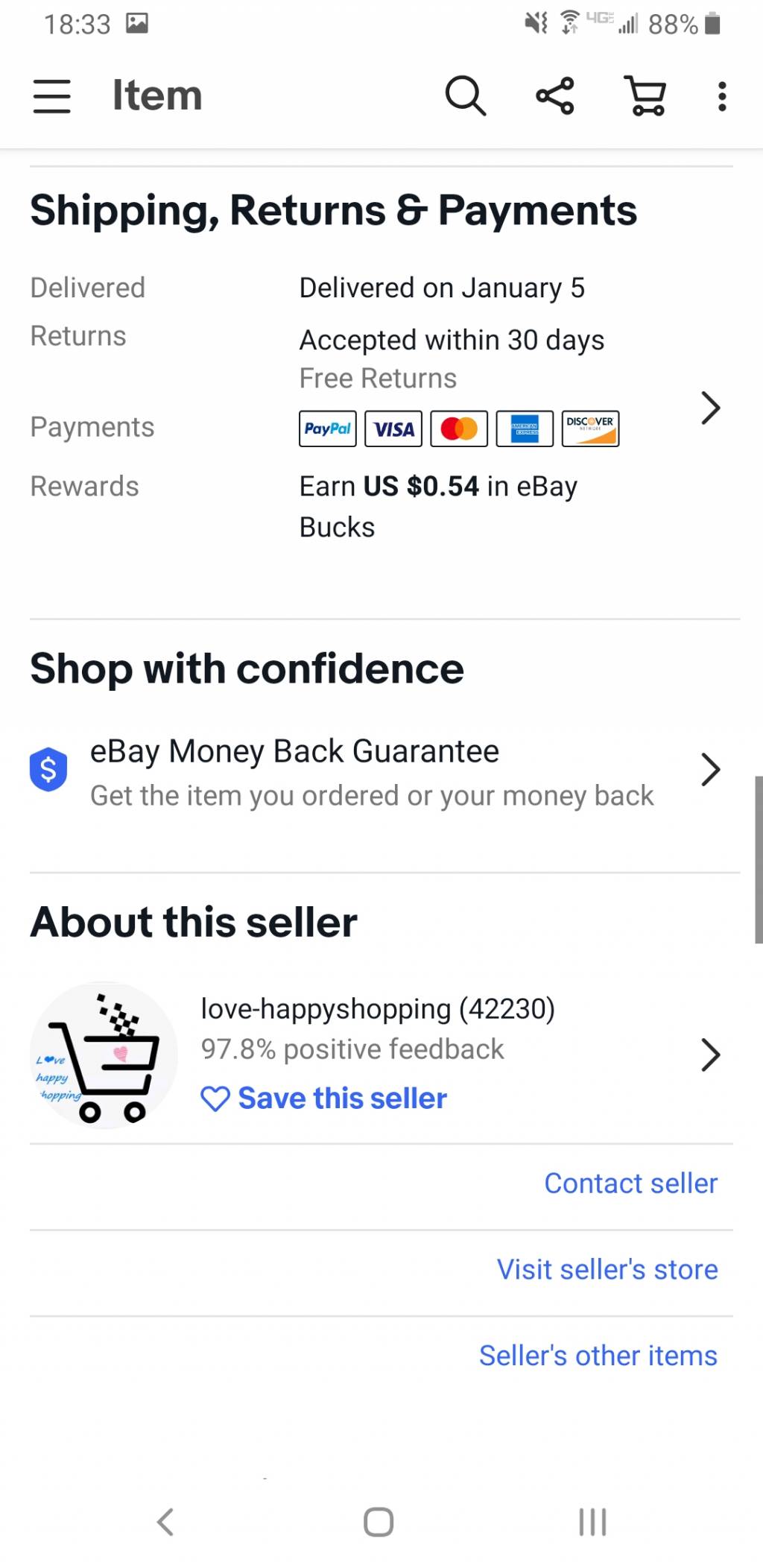

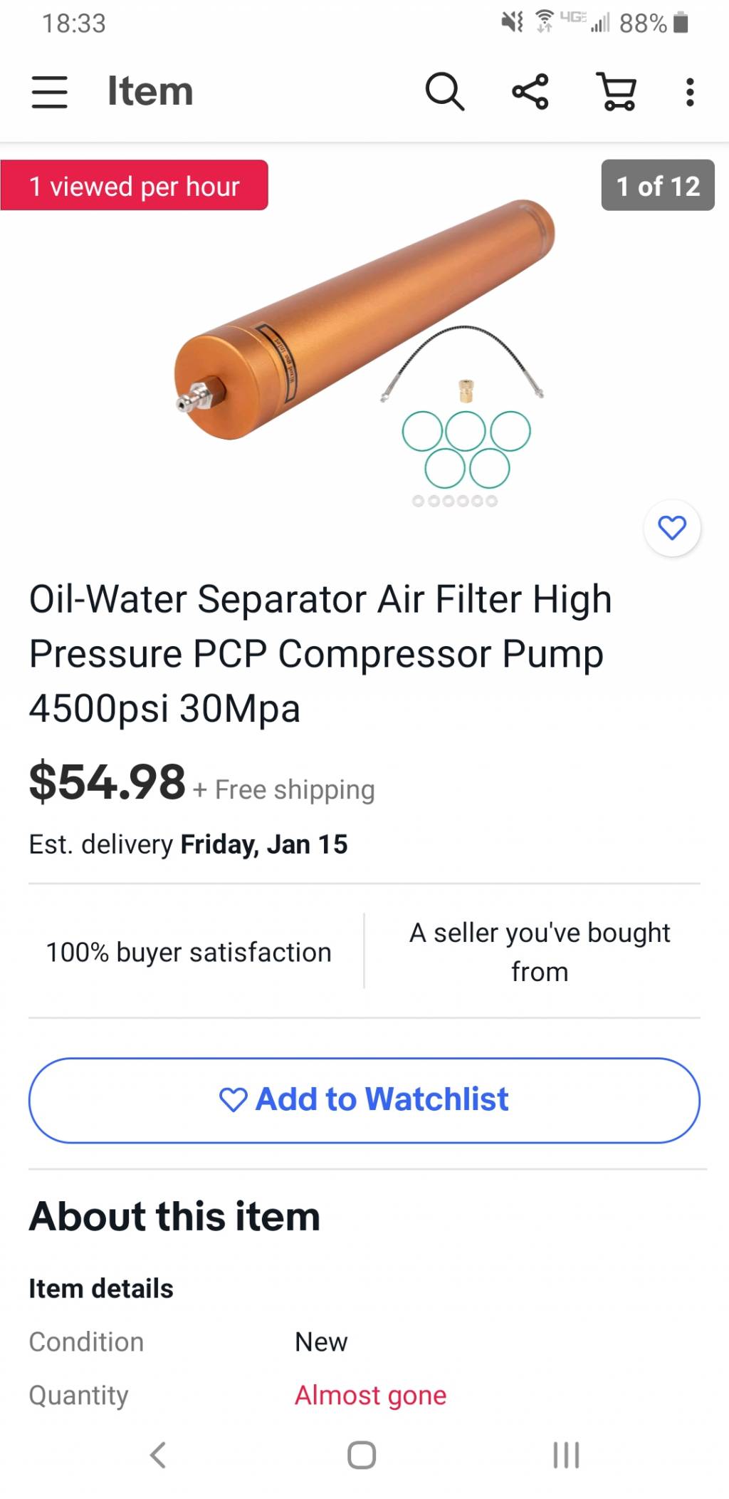

So contacted ebay and the seller, the listing has been removed. But I'm I'm theres more out there
So I have to take some blame when searching for a tuxing filter this one came up and from a seller I bought from in the past. So it's not a "tuxing" brand and didnt realize since the water separator is thick with a lot of threads.
The wall is only .183" thick, the threads .752" ish and is 13.8" long.
Now looking back the add never specified wall thickness. So make sure you pay attention to it!

I have been looking on Ebay and that same seller has multiple listings for this same product still up for sale. I'm sure he is not the only seller that has these listed. Off_target, maybe open a complaint with Ebay and send them the photos? Really glad you didn't get hurt but these cheap knock-offs are going to get somebody killed if they keep getting sold on Ebay to the unsuspecting new guys.
I had to pull teeth to get ebay to do something on my one listing. I do see the seller has similar and/or the same listings. The seller still hasn't responded, hopefully they listen to me and remove like listings of these.

Off_target, if you are looking for a better filter option the 'genuine' Tuxing gold filter has 8mm (.320") wall thickness and much longer threaded end caps & is available on Ebay for around $120. This is the one Centercut recommends and I have been using mine for 15 months with no issues.
