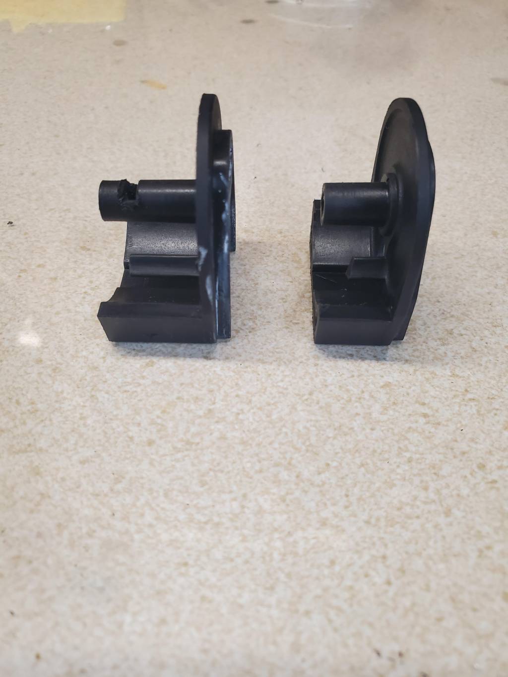

Anyone who has a Ataman and wants to shoot slugs or even predator pellets know the magazine that comes with the gun will not hold slugs or fit the Predator pellets. The .357 M2R is a awesome gun but since the mags only hold pellets that means the only thing that works is the JSB 81gr pellets. Anything else needs to be single loaded. I wanted to shoot slugs and have a repeater. While looking it over I came up with a idea to get the Bulldog magazine to work with it. I had some issues to over come. 1st is the Bulldog magazine is too long. I had to take apart the magazine and remove about .22 inches on the cylinder and the housing.

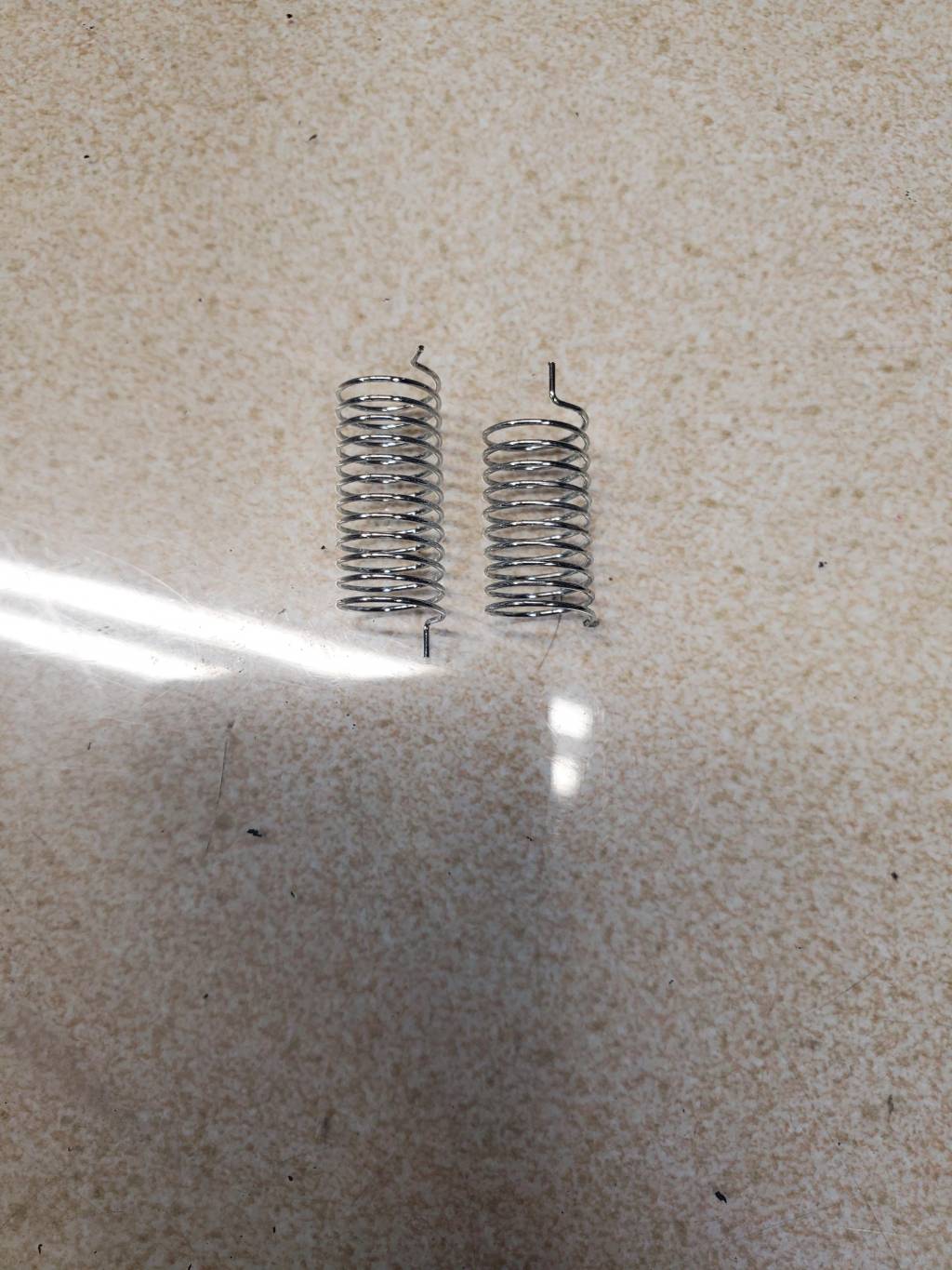

 I also needed to remove 2 coils off of the spring.

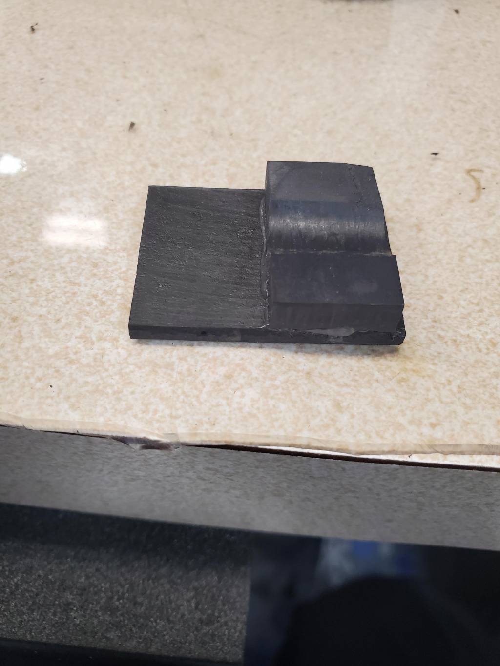

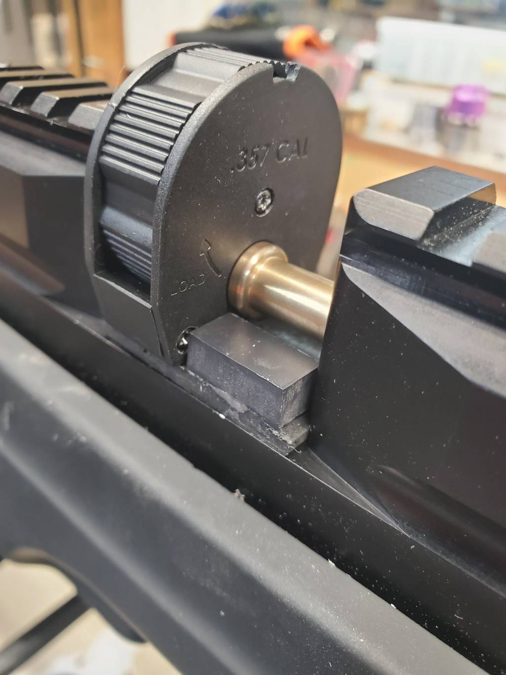

The way the stock magazines fit into the gun, they slide in from the side. I wound need to make a support so this is what I came up with.

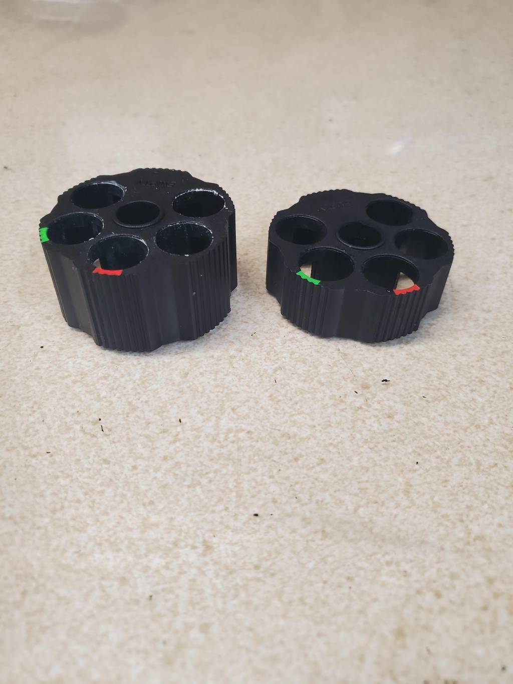

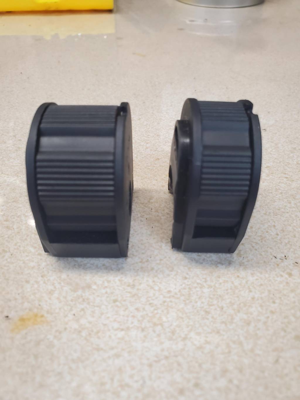

Here is the modified mag next to a stock one.

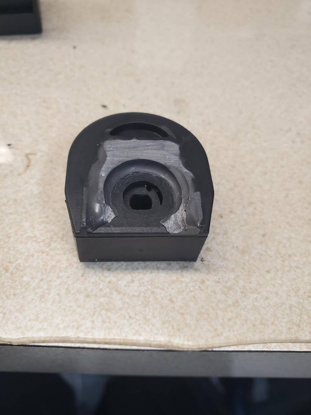

The hardest thing was getting the magazine to slide in from the top and hold in place. What I noticed was the back of the mags have a raised area, all I had to do was fill it with jb weld and cut out the area for the barrel.

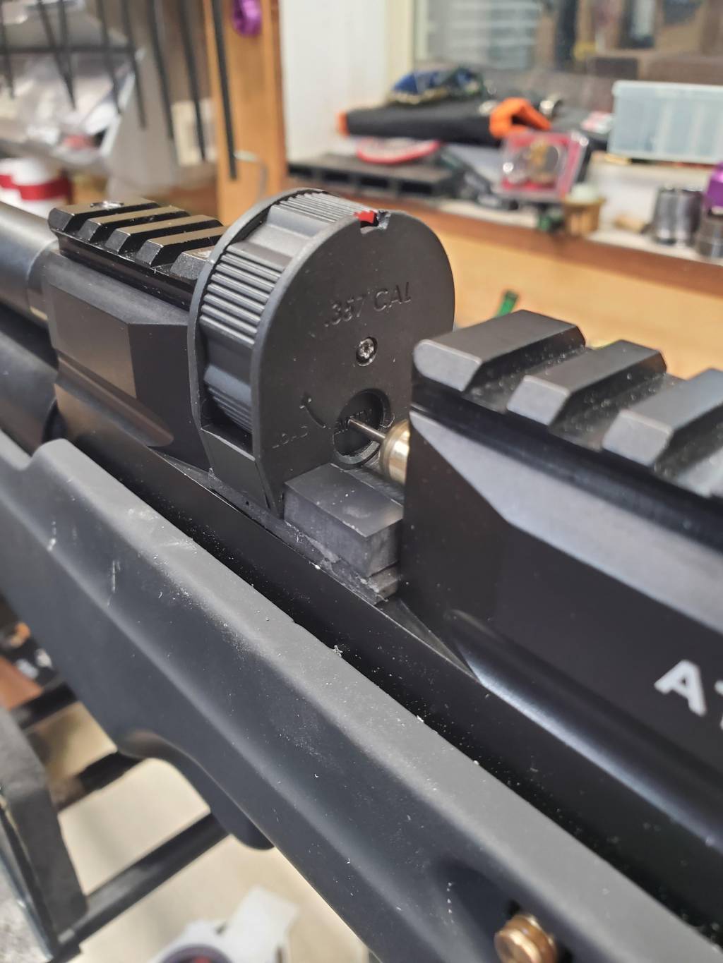

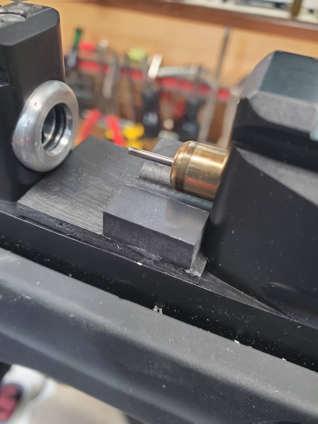

So now with thr plate in the magazine just slides in.
It works great. I might try to make another and have it more like the stock one with the magazine fixed to the plate and have it slide in from the side. Now I got a mag that will hold slugs. Looks like the heaviest one it will fit is thr 93gr Nielson.
