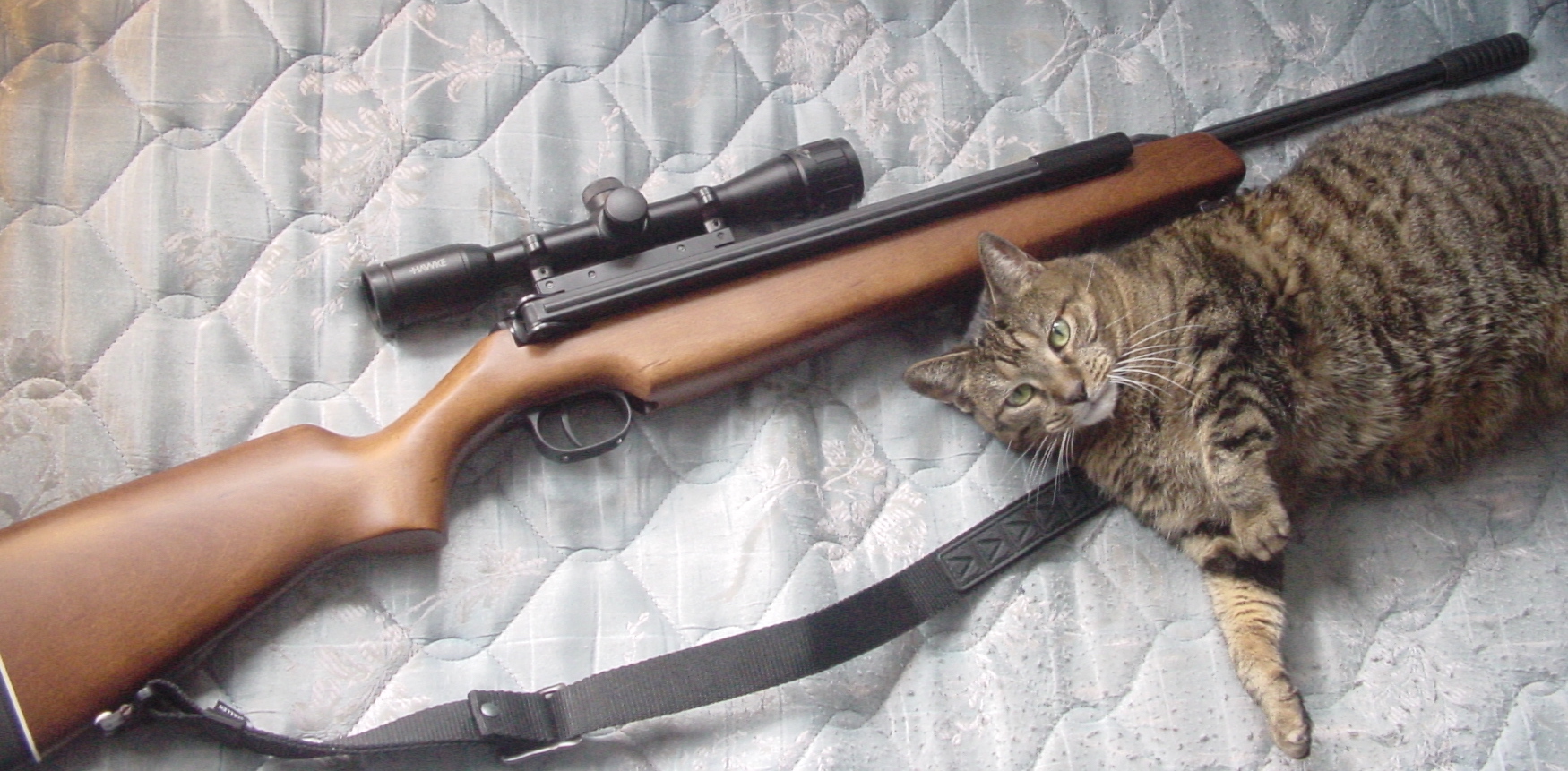

HW/Weihrauch I need a lot of practice w/ my HW95.............................................
A front rest/rear bag combo ain't working too good for group shooting. I'll try this artillery hold thing next decently warm day but I only have partial use of my left hand and I'm not very steady shooting off hand so this airgun thing may be a big $700 mistake.
