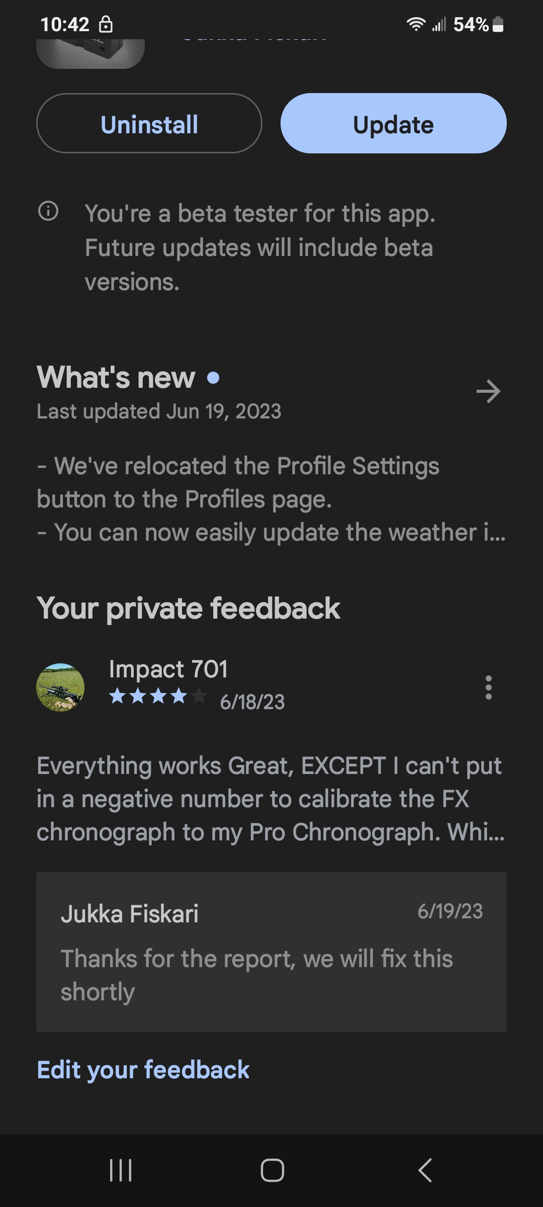

It consistently reads 15+ fps faster than my Pro Chronograph which seems to read the correct velocity, confirmed by Stelok.

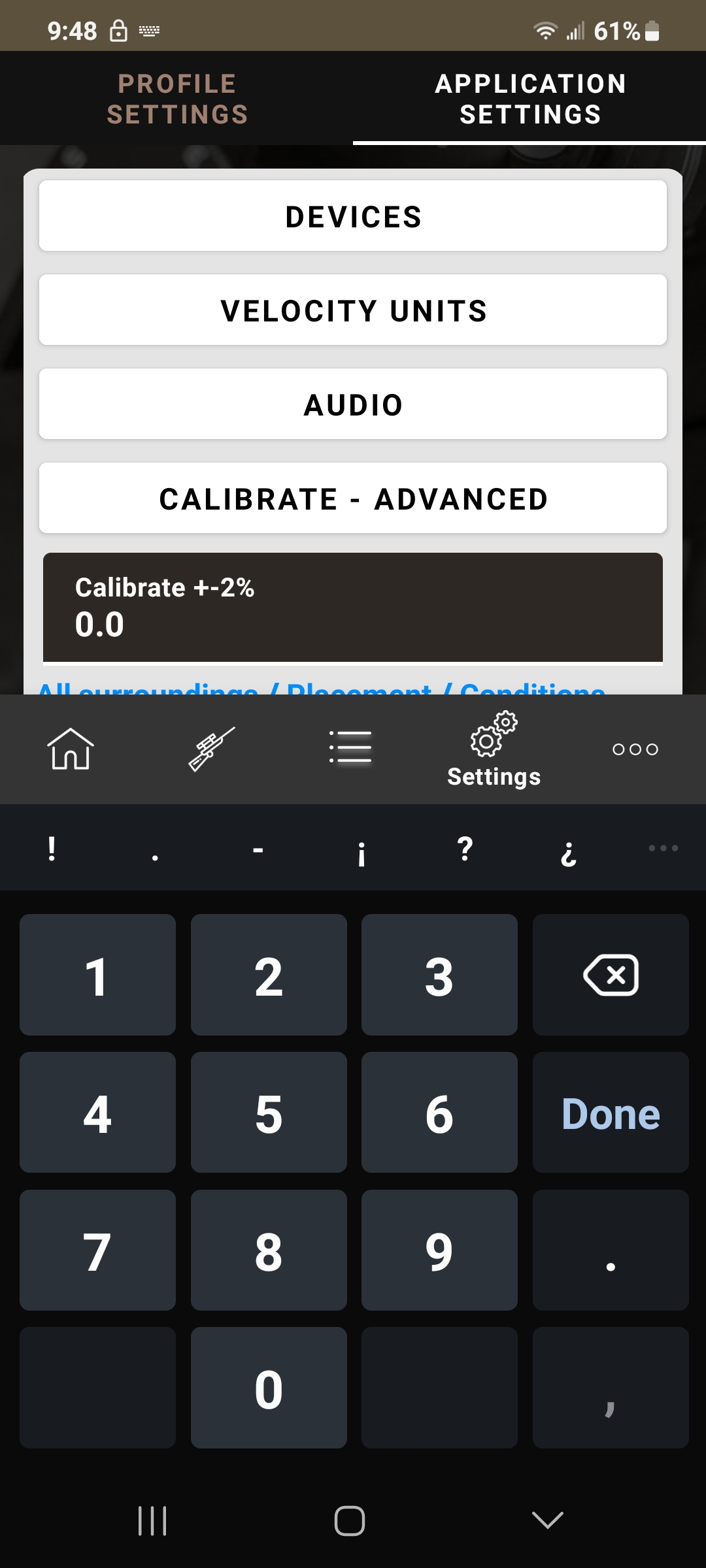

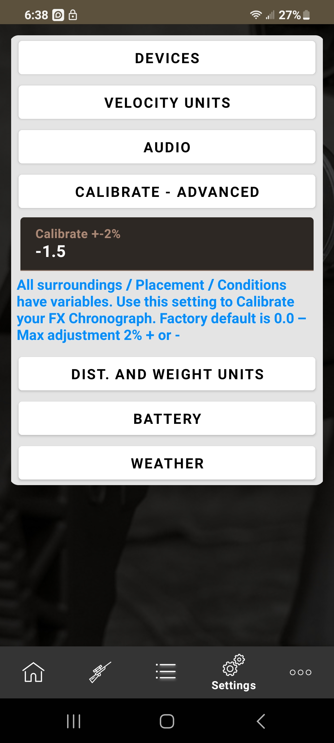

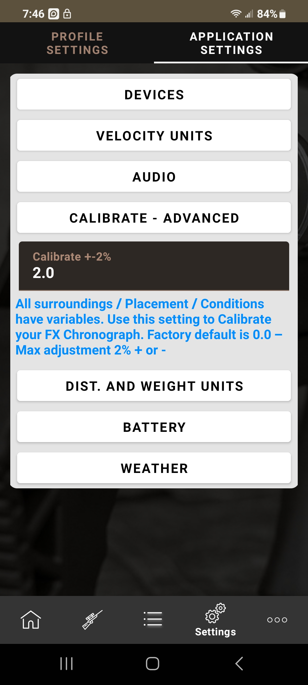

I have tried to calibrate it to read the same as my Pro Chronograph but there seems to be a glitch with the app.
According to the owners manual you should be able to change the velocity + or - 2%
I'm able to add velocity but I cannot lower the velocity.
Thanks in advance

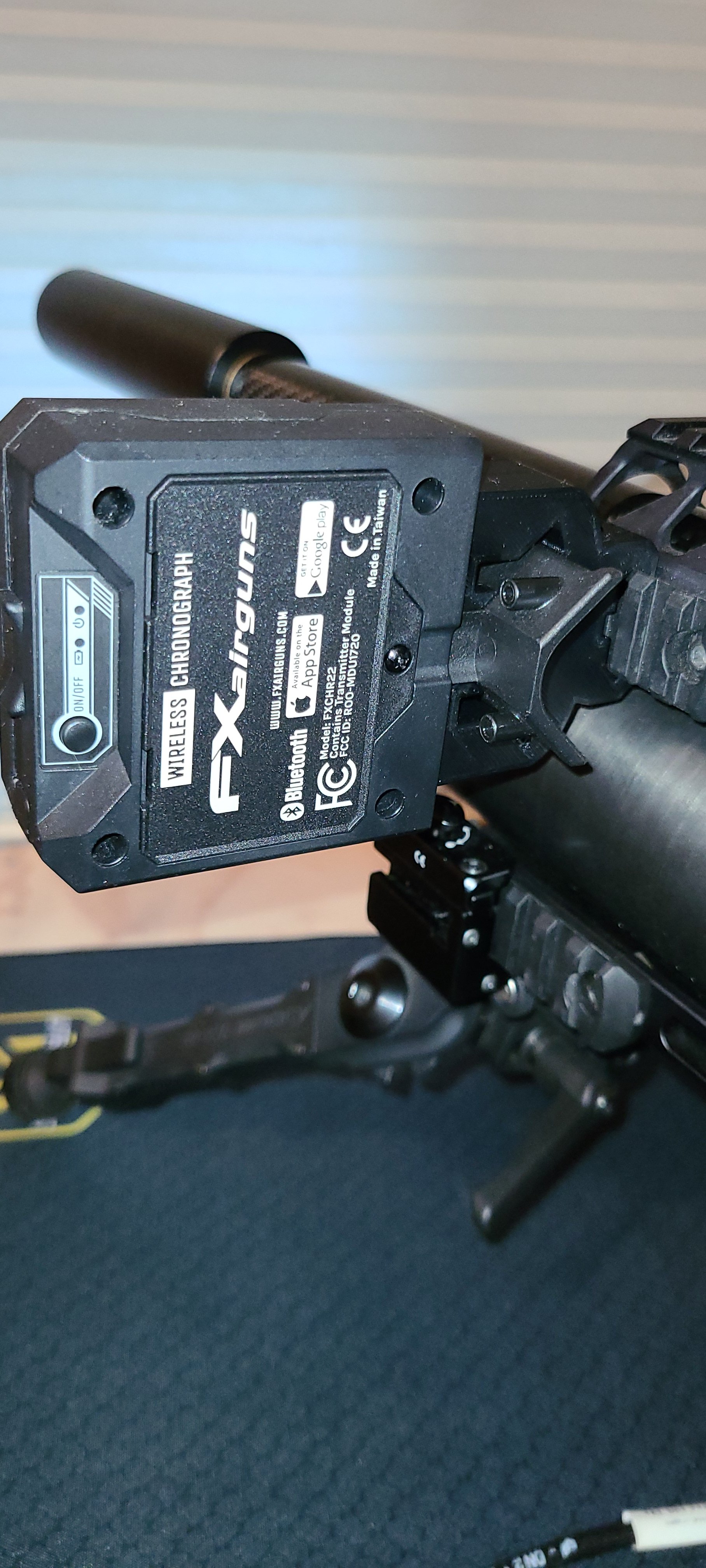

With FX radar pretty much you need to place it where is no echo from surrounding objects, behind a muzzle alligned with the path. On my Impact I mount it below and on my L2 on the side of the barrel.

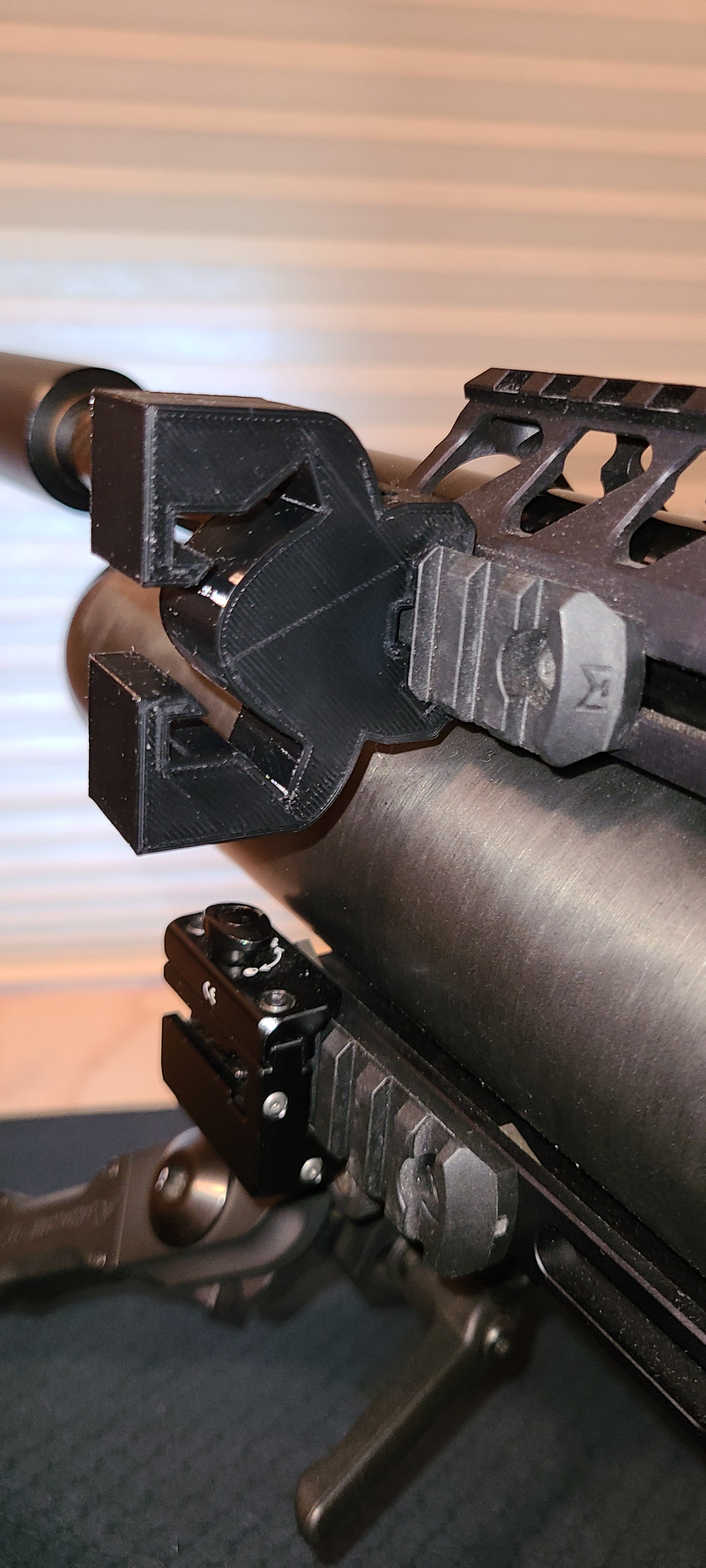

Try using this mount for your FX chronograph.
I have shot hundreds of shots and reads them all.
I have the angled one for side mounting
