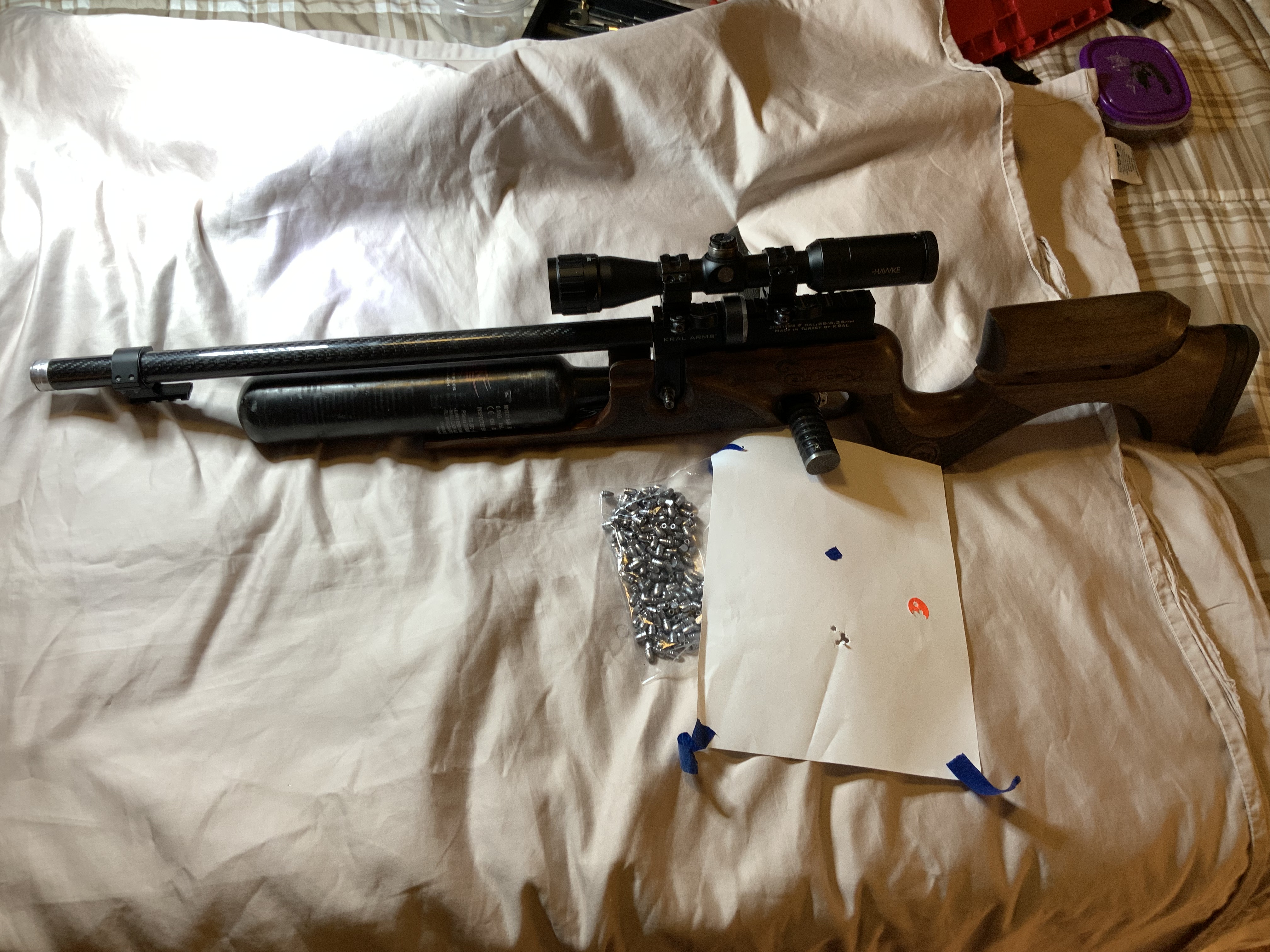

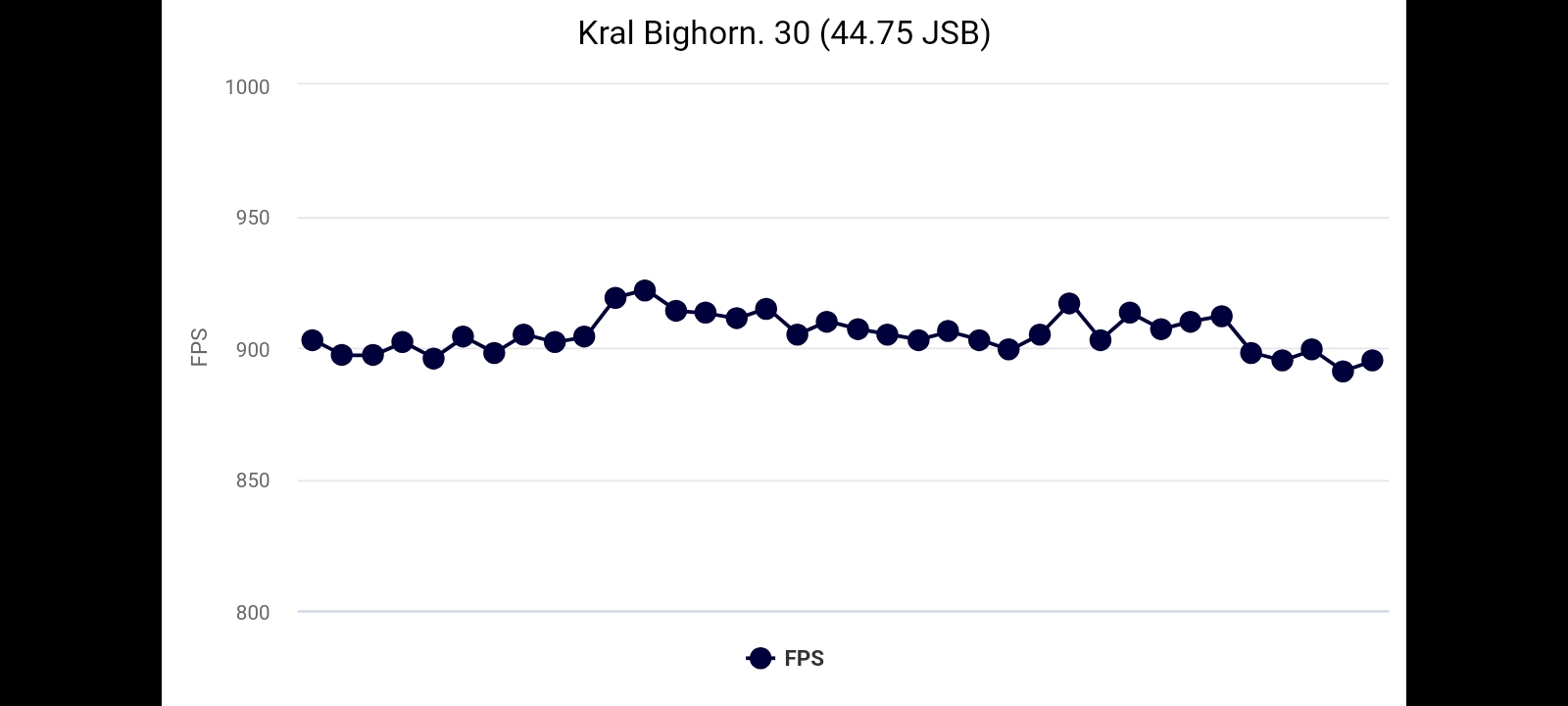

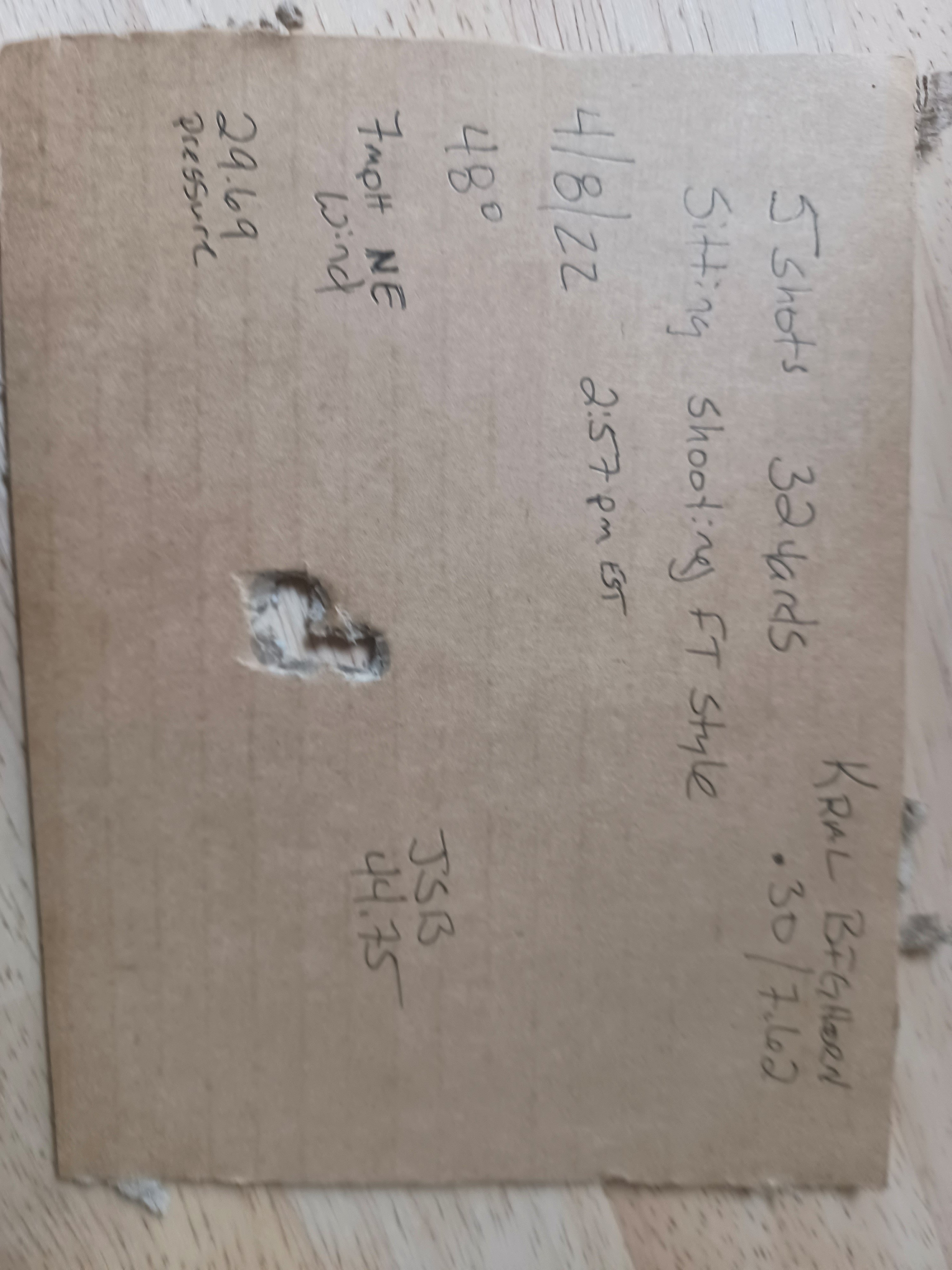

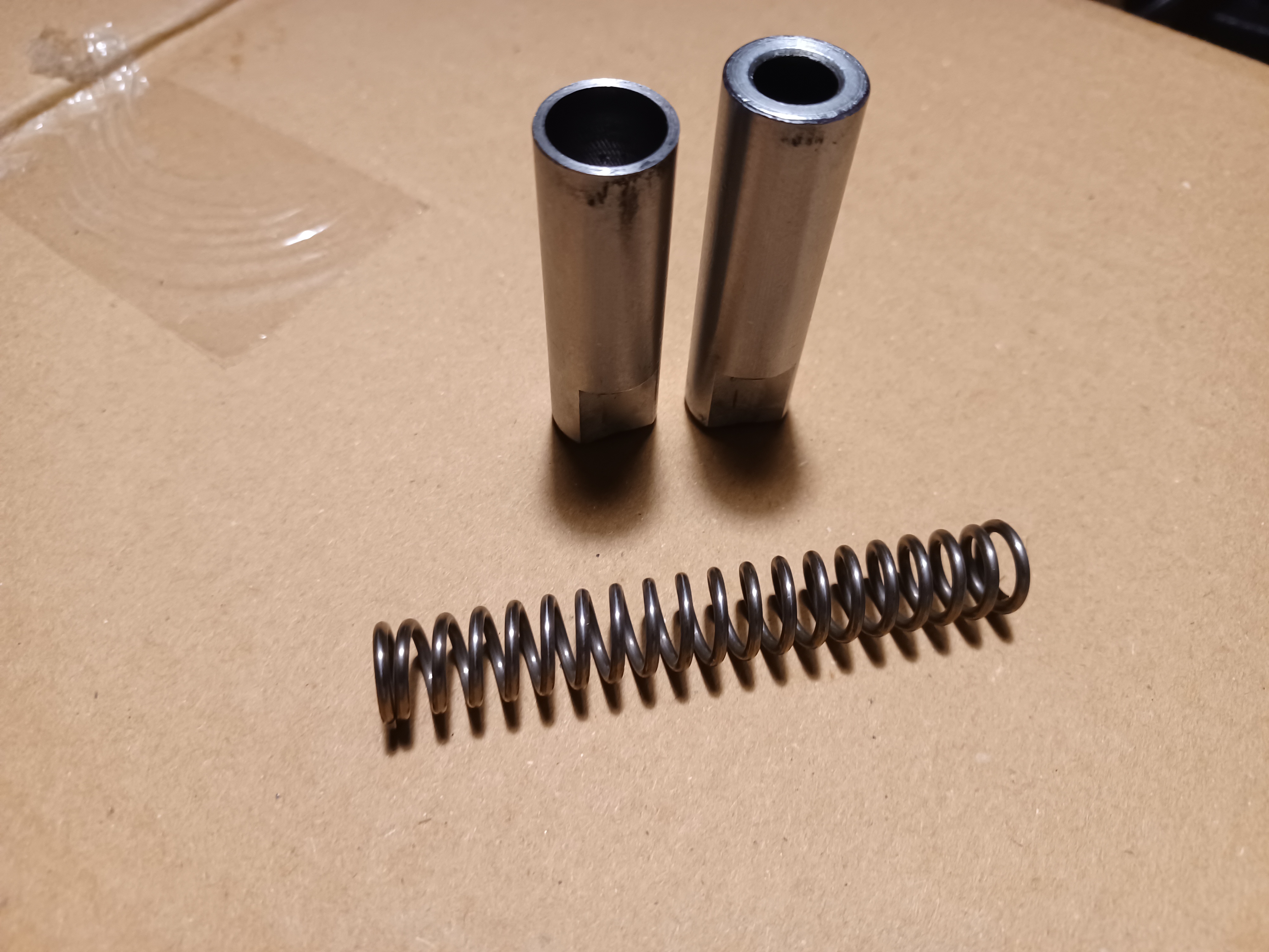

I'm the US importer for the Bighorn. They seem accurate in 25 and 30 pellets. The 357 barrels I got were no good. The hammer and spring from factory weren't suitable for my liking so I modify them. Once finished the .30 gets 4 magazines (36) Shots at 900fps with 44.75 JSB and will shoot a 3/8" group at 35 yards. They come both regulated and unregulated. Most are not. 2nd picture shows the hammer mod. It's shortened and drilled out to 1/2" same depth as Factory and a shortened spring from a Benjamin Bulldog installed. 3 coils removed and a new spring guide.
I'm the US importer for the Bighorn. They seem accurate in 25 and 30 pellets. The 357 barrels I got were no good. The hammer and spring from factory weren't suitable for my liking so I modify them. Once finished the .30 gets 4 magazines (36) Shots at 900fps with 44.75 JSB and will shoot a 3/8" group at 35 yards. They come both regulated and unregulated. Most are not. 2nd picture shows the hammer mod. It's shortened and drilled out to 1/2" same depth as Factory and a shortened spring from a Benjamin Bulldog installed. 3 coils removed and a new spring guide. View attachment 292963View attachment 292964View attachment 292965
