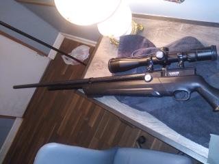

I bought a BKL-260 one-piece scope mount and sat here staring at it for 2 months while my scope was on backorder. It's such a beautiful piece of machining. My dad, who was a machinist for most of his working career, agrees that it's a really nice looking piece of work. Couldn't wait to put it to use. Then the day came, my scope was finally delivered, and this mount proved to be a disappointment.
They give detailed instructions how to install it on the BKL website, with suggested torque rating. I followed the directions exactly, tightening each base bolt in sequence to the recommended 35 in/lb. I have a pre-calibrated Presta torque wrench rated for 4 Newton Meters made for installing bicycle parts. If you convert the units you'll see that 4Nm = 35.4 in/lb. When it gets to 4Nm it slips, stops applying force.
The first 2 allen bolts stripped their base threads long before they got to 35 in/lb. Aluminum is much too soft a material to stand up to that kind of torque apparently. You'd think I'd learn my lesson after stripping the first bolt, but some days I'm not that bright and not realizing what happened, I went ahead and stripped the second bolt before the bulb went on in my brain. Obviously I tightened the next 4 allen bolts well below the suggested torque rating. I'm sure 4 bolts is plenty to hold the mount on my relatively low-powered rifle but I lost 33% of my holding bolts and that's the kind of thing that will nag my brain forever.
Next problem, mounting the scope in the rings. The clearance between the bottom of the rings and the flat top of the base looks to be about 1/8". But the turret box at the bottom of my scope hangs down slightly more than that, so the scope is actually sitting on the base rather than in the rings. I didn't notice this at first and realized as I was tightening the top rings that it was applying bending force to the scope along its axis with the turret box as fulcrum. Not good.
So I went back to my 2-piece Sportsmatch rings, which incidentally hold 35 in/lb at the base no problem. I think they're steel instead of aluminum.
I sent BKL an email last week, not making any demands, merely informing them of my experience and suggesting they might want to reconsider their recommended torque rating. I haven't heard anything back from them yet. I threw away the packaging and paperwork a long time ago so I don't have any illusions about getting a refund. I don't care about that anyway, I just want to put this information out there so that others don't have the same experiences I did.
