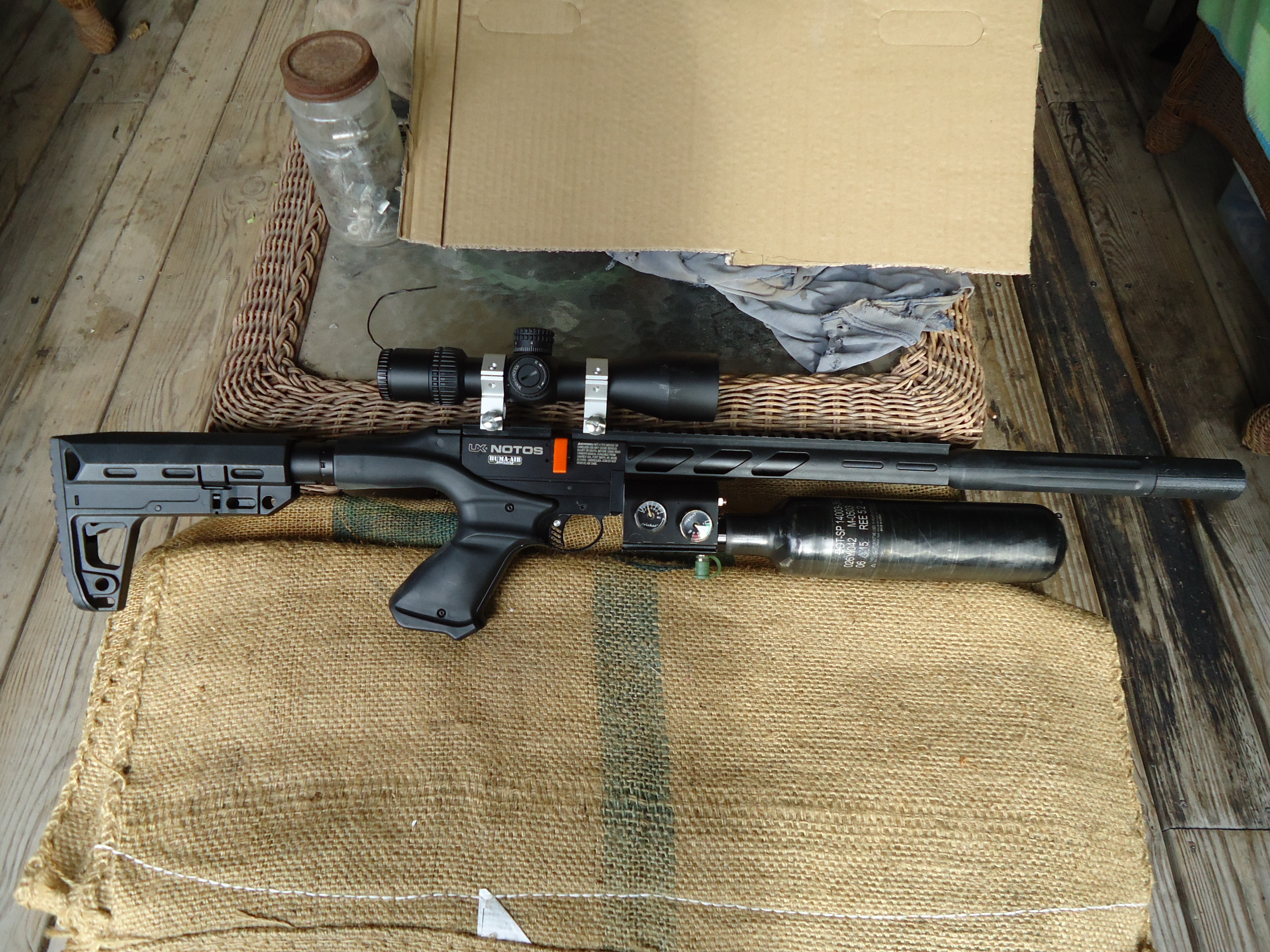

I found the dropblock and bottle on Aliexpress. I had no idea it was Huben branded until I got it.
It checked all the boxes for my needs. Dropblock, on-board regulator, dual gauges, and pic rail for bipod mounting. It came packed well and was pressurized when I got it. I'm pleased with it. The reg doesn't creep and is easy to adjust. Here's a few more pics of the reg. I didn't have to re-tap anything. The clocking was off by only ~5deg so I sanded the mating face with 400g on a flat block which only took 10min or so and was able to get a nice fit. The drop block & bottle added right at 1lb to the rifle. The weight balance is nice and it feels less top heavy now. Shot consistency is good as well. I haven't had a chance to shoot the entire bottle yet, but here's a 24 shot string with JSB 18.1gr.

Correct me if I'm wrong. The drop block screws on to the threaded piece where the stock air cylinder is? If that is correct what seals it the same oring that sealed the stock air tube?
Hi NB1,

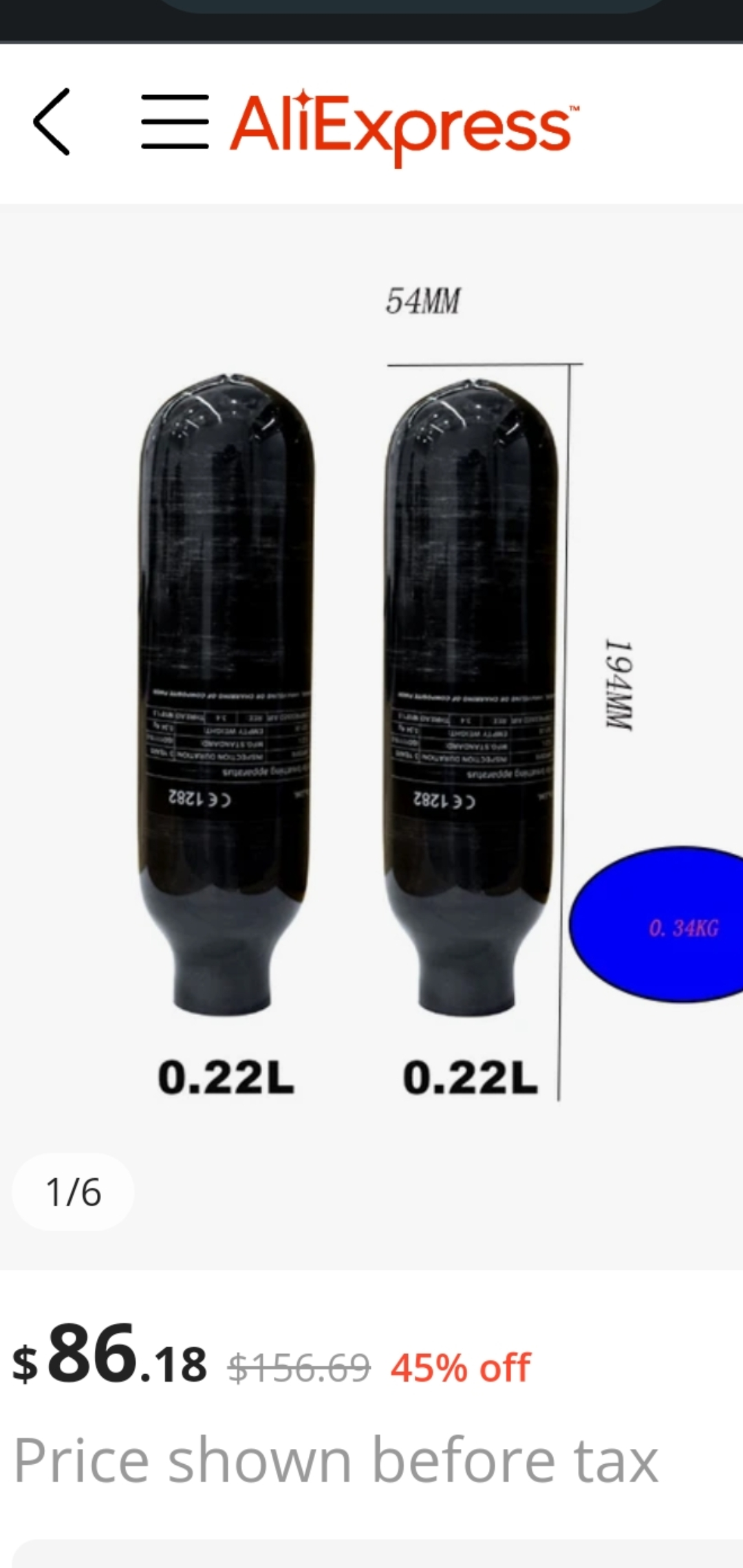

Barrel needs to come off first. Unfortunately I don't have a pic of the Notos receiver block with original tube removed, but yes, there is a M16 threaded male nipple fitting on the receiver that the drop block threads onto. The picture in an above post shows the silver face on dropblock that mates to the receiver. This had been painted but to get the dropblock to rotate and align properly to the receiver block, I had to remove a couple mils from the drop block face. I did that on a flat block with 220g then 400g psa sandpaper. I had such a small amount to remove, it wasn't worth chucking it in the mill. It just depends how the fit is between the dropblock and receiver housing how much material needs to be removed from the dropblock. The Notos itself is not modified and you can revert back to the tube easily. I chose a 220cc 54mm diameter bottle, but the Huben dropblock would likely work fine with a larger capacity 62-64mm diameter bottle. 220cc at 300bar = ~100 19fpe shots. That was my goal.

Here are the bottle dimensions.

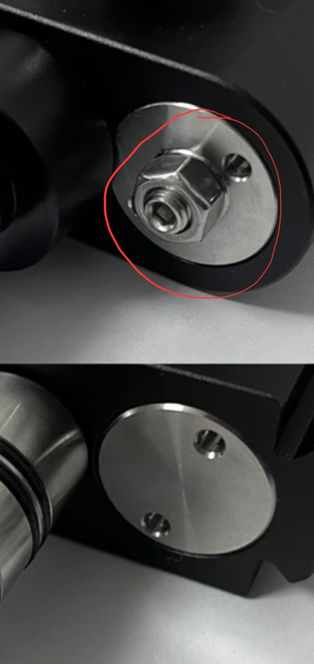

So any one have any idea what the procedure might be for adjusting this reg up and down?
Hey Mik,
Adjusting the reg is pretty easy. The adjustment screw is shown here. You'll want to loosen the locking nut a bit then use allen key to make the adjustment. CCW to raise reg pressure or CW to lower reg pressure. OK to raise pressure with air in bottle, but should degas completely to lower pressure. Doesn't take much to move the reg pressure. Go in 1/8th turn increments or less if going up. If you're increasing it, you'll be able to watch the pressure rise on the reg gauge. A couple dry fires will settle in the reg pressure as you're adjusting it. Tighten locking nut when you're done.
Hey Mik,
