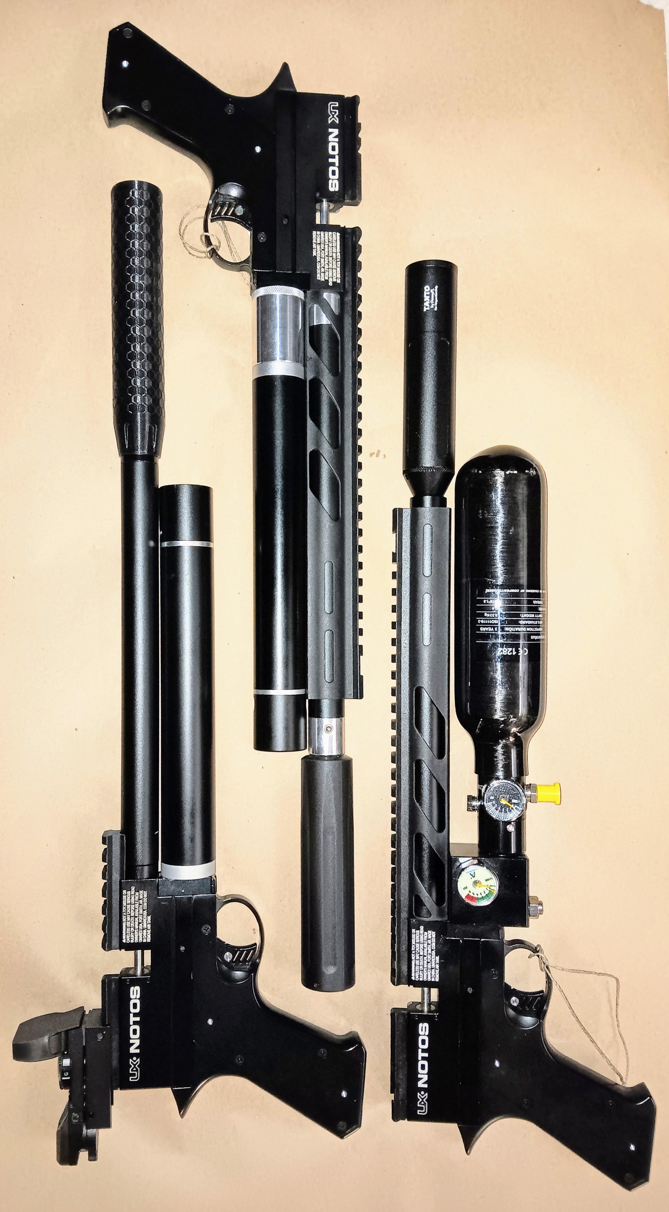

Barrel needs to come off first. Unfortunately I don't have a pic of the Notos receiver block with original tube removed, but yes, there is a M16 threaded male nipple fitting on the receiver that the drop block threads onto. The picture in an above post shows the silver face on dropblock that mates to the receiver. This had been painted but to get the dropblock to rotate and align properly to the receiver block, I had to remove a couple mils from the drop block face. I did that on a flat block with 220g then 400g psa sandpaper. I had such a small amount to remove, it wasn't worth chucking it in the mill. It just depends how the fit is between the dropblock and receiver housing how much material needs to be removed from the dropblock. The Notos itself is not modified and you can revert back to the tube easily. I chose a 220cc 54mm diameter bottle, but the Huben dropblock would likely work fine with a larger capacity 62-64mm diameter bottle. 220cc at 300bar = ~100 19fpe shots. That was my goal.

I’d love to see a pic of your Notos !
I have 2 Notos and they are both almost stock.
They both have the silencer insert which makes the Notos significantly more quiet.
Other than the insert I only changed the hammer springs to slightly weaker ones.
The weaker springs give me velocities from 460 to 720 FPS with CPHP.
At some point I was getting about 100 shots in the 460-500 FPS range, and 50 shots in the 680-700 FPS range.
Since I am just plinking it works for me.

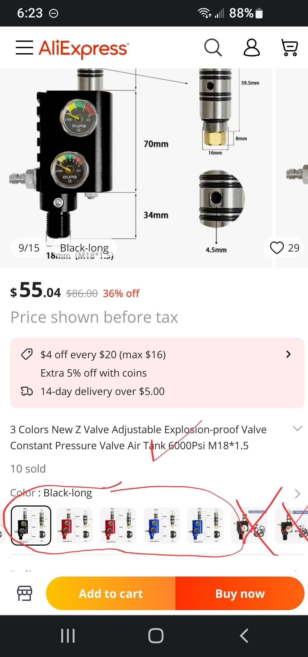

I am about to buy the same drop block from Aliexpress: https://www.aliexpress.us/item/3256805918865165.html
They have a big sale going on now (until November 17), 15-30% off depending on what you buy.
I was also going to buy an aluminum air tank: https://www.aliexpress.us/item/3256805732748728.html
The 0.3L (300cc) air tank is 22.5cm long and 6.1 cm wide.
Do you think the air tank would fit using that drop block?

That bottle will fit on that zblock on the Notos. It's pretty heavy though. Like 9oz more than the CF 220cc one. 21.2 vs 12oz. Gotta make sure what the working pressure is on these aluminum tanks and fill them appropriately.
Make sure to select the right zblock. Don't get the two choices on the right. They don't have the regulator!
These are a different brand than what I ordered. Should work though. Includes a degass screw which is sweet. I use the foster fitting as the degasser though. Works fine too. I've been really impressed with the regulation with the "Huben" one. No creep and nicely stable. Better than what's in my Avenge-X. Lol.
You said that the valve itself is not used
I was thinking to buy the block with the shorter valve, since it's a little cheaper.
The valve and the cover are not used.
Don't buy the aluminum tank, get the carbon fiber tank, you will have way too much weight way too far forward and its WAY too big around at 61mm!!.
