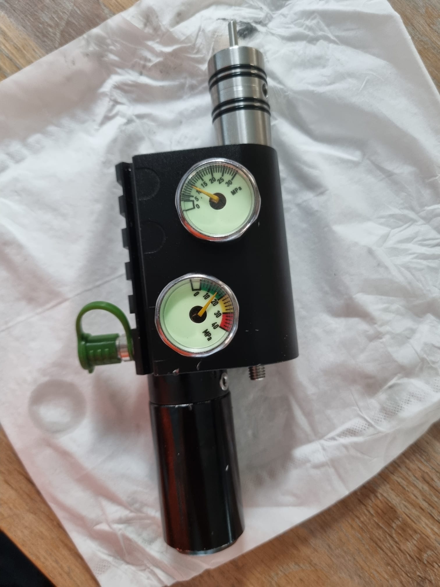

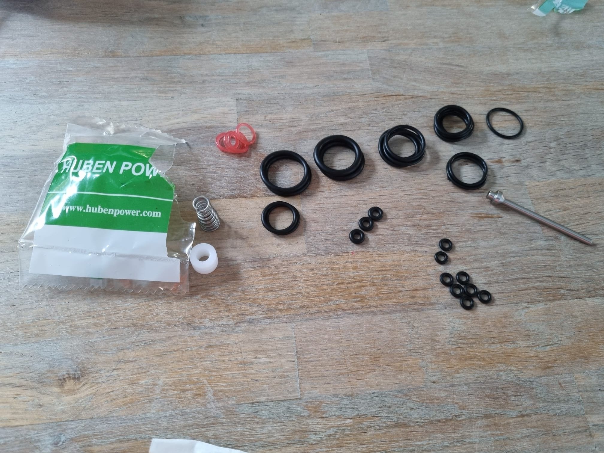

My Huben Power Cricket Z-valve isn't working anymore, probably some o-ring that has blown. When I fill the bottle, the reg gauge shows the same pressure as the bottle gauge. I've opened it up but I can't find what is wrong inside the drop block. All the o-rings on the bolt and the cap look okay. It was working great but I fear I've pushed air into it with too much velocity, as my diving bottle has an on/off valve. When I opened up the regulator, it was still under pressure and the cap wouldn't turn that great until it lost it's seal and the air could escape. Kinda strange it still held air as both gauges were off the block and no bottle was connected.
Where do I need to look to fix this?

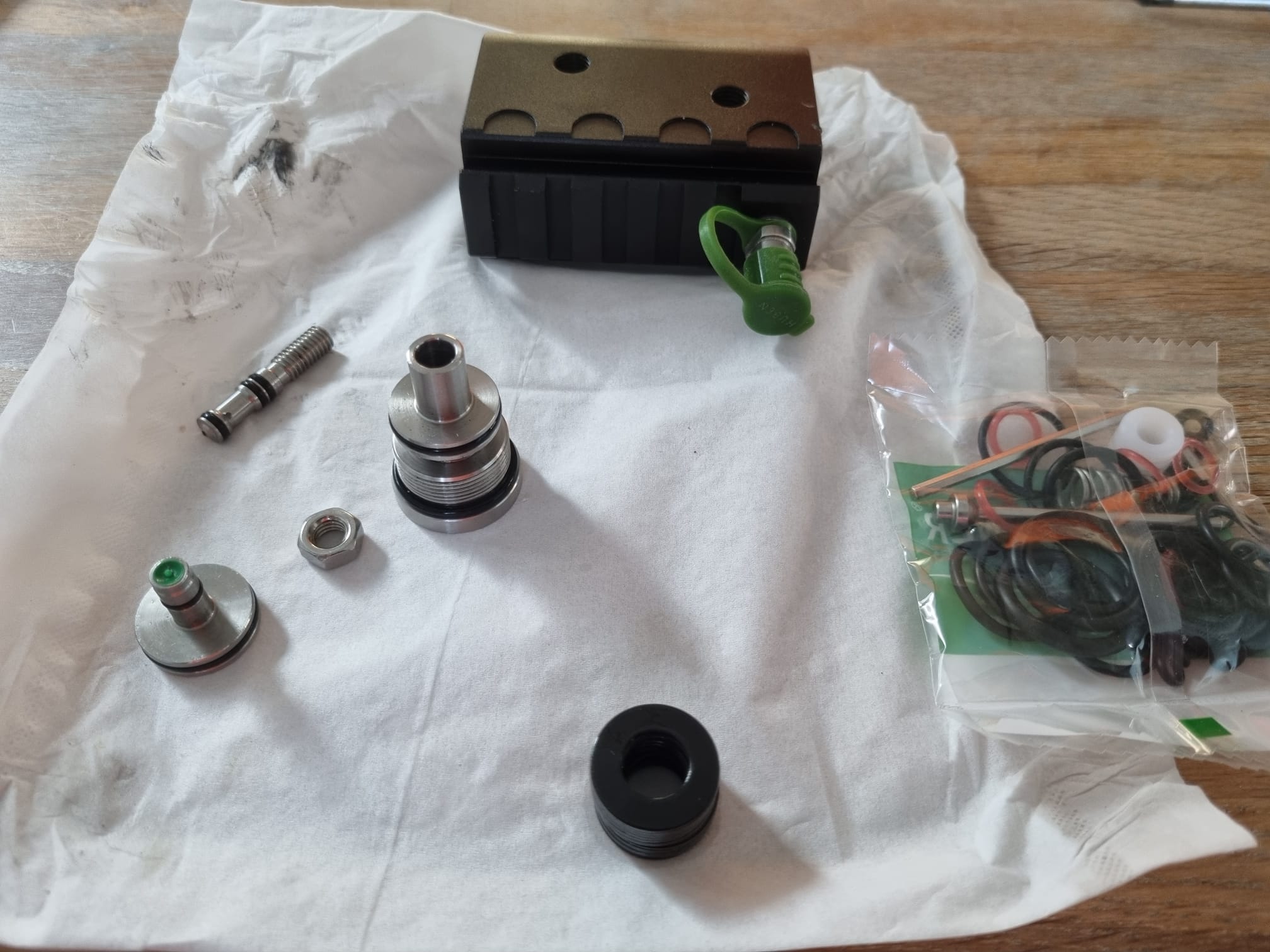

As no one replied with a solution (and the replacement Z-valve I ordered from Aliexpress was delivered with a damaged thread on the bottle adapter and held no air because of that) I tried to fix it myself. The Huben Cricket has a repair set in the box that contains multiple formats of o-rings:
Taking the regulator apart is pretty simple and all I did was replace all the small o-rings after applying some silicon grease on the new ones.
Put it all back together and set it under pressure and it seems to be all good again. Good to know that it's an easy fix.
My new compressor is not yet delivered and my dive bottle is at 160 bar, so the difference between reg and bottle pressure is not that obvious but there's a difference between the two again. @mil might be worth a try if you haven't done allready.

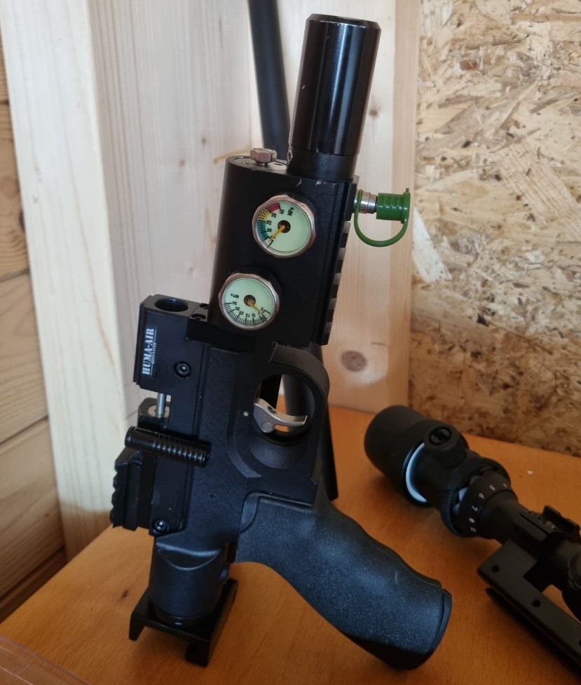

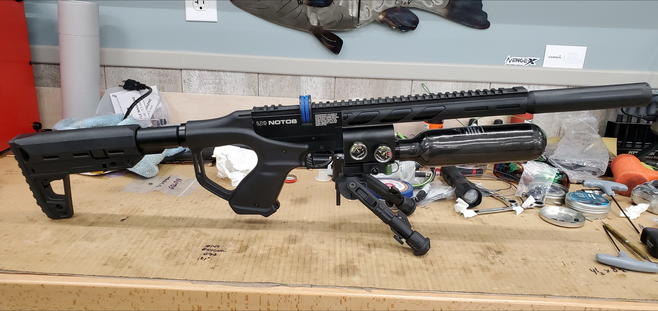

Barrel needs to come off first. Unfortunately I don't have a pic of the Notos receiver block with original tube removed, but yes, there is a M16 threaded male nipple fitting on the receiver that the drop block threads onto. The picture in an above post shows the silver face on dropblock that mates to the receiver. This had been painted but to get the dropblock to rotate and align properly to the receiver block, I had to remove a couple mils from the drop block face. I did that on a flat block with 220g then 400g psa sandpaper. I had such a small amount to remove, it wasn't worth chucking it in the mill. It just depends how the fit is between the dropblock and receiver housing how much material needs to be removed from the dropblock. The Notos itself is not modified and you can revert back to the tube easily. I chose a 220cc 54mm diameter bottle, but the Huben dropblock would likely work fine with a larger capacity 62-64mm diameter bottle. 220cc at 300bar = ~100 19fpe shots. That was my goal.

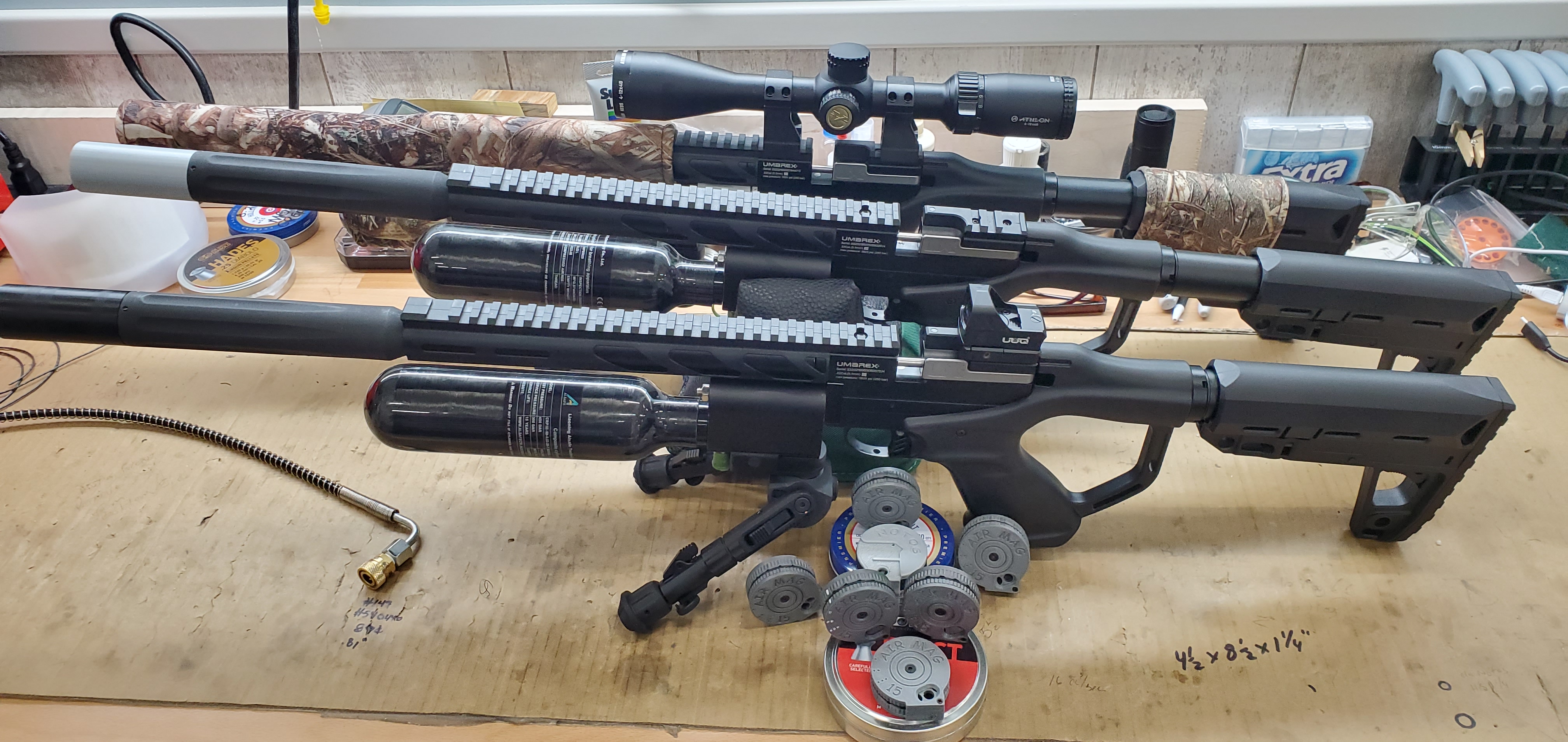

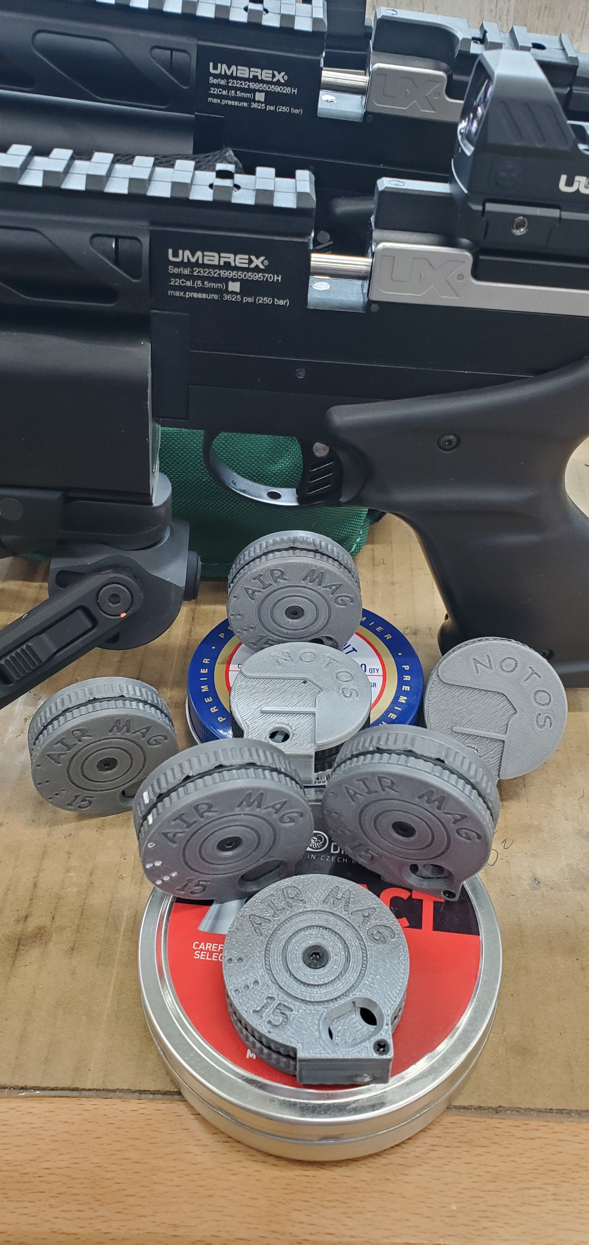

Hey Man for some reason it won’t let me PM you but i was hoping you could message me. I purchased a zelos and interested in what you have for mods to purchase. Thank you appreciate your time!I've been a busy elf. I modified a couple more Notos's for Xmas gifts. Turned our great. Again used the Huben Z-blocks and 220cc bottles. I gave both a bit of tweaking too. Cocking lever smoothing, Breech and barrel polish, trigger job, power boost mod and I printed moderator inserts as well as several mags for each. I think my son and brother will be thrilled. Find out later today. I'll let them pick their own optics. Should be all set for a springtime Notos league!
