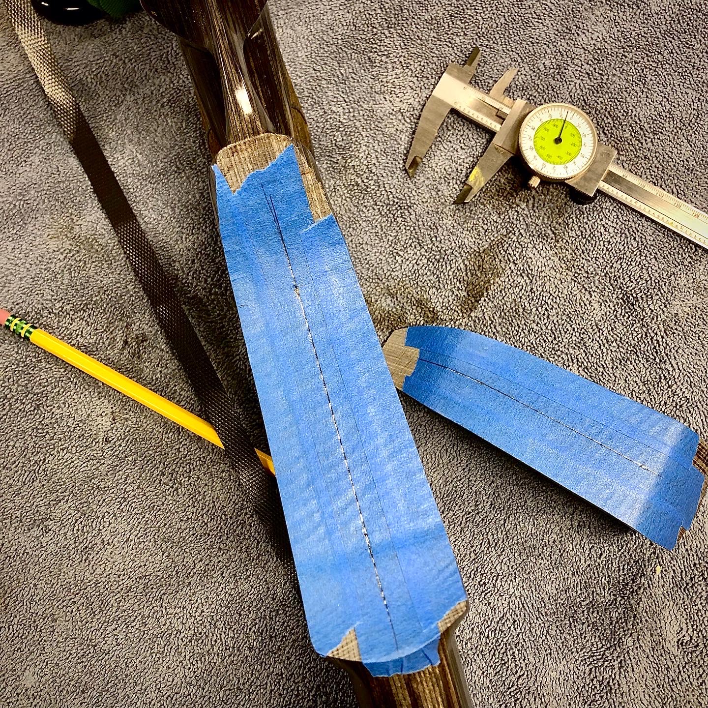

I have always loved my FX Royale 400 in 22 cal but ever since handling the bullpups I feel that the Royale is a long gun.
I recently purchased an FX Original Smooth Twist barrel blank from @airgunsofarizona and I am having it machined to fit in the gun. I didn't measure the total length that will be coming off but after adding a moderator to the new shorter barrel it will be 4-5" shorter OAL.

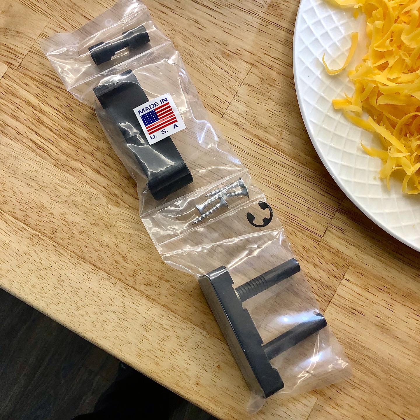

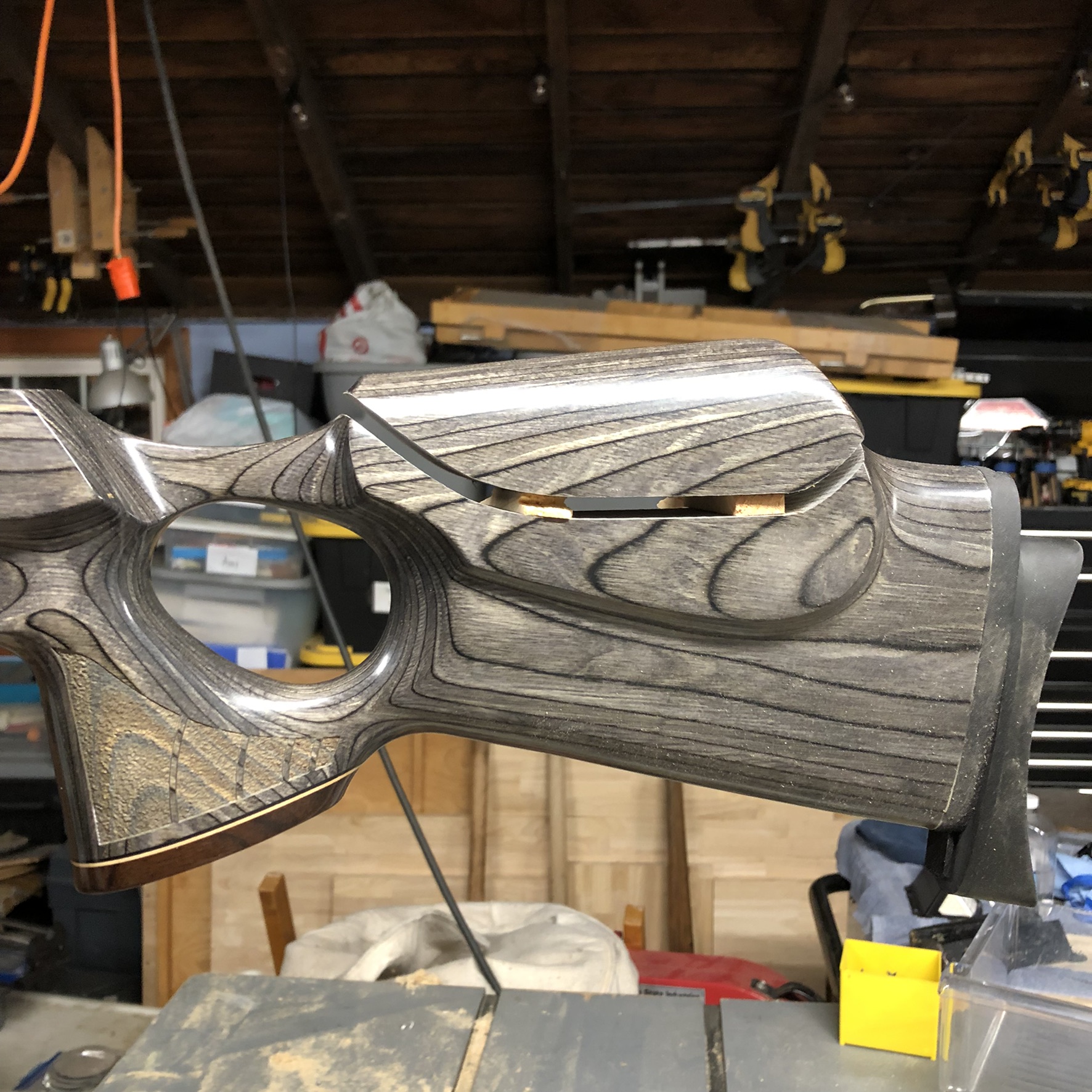

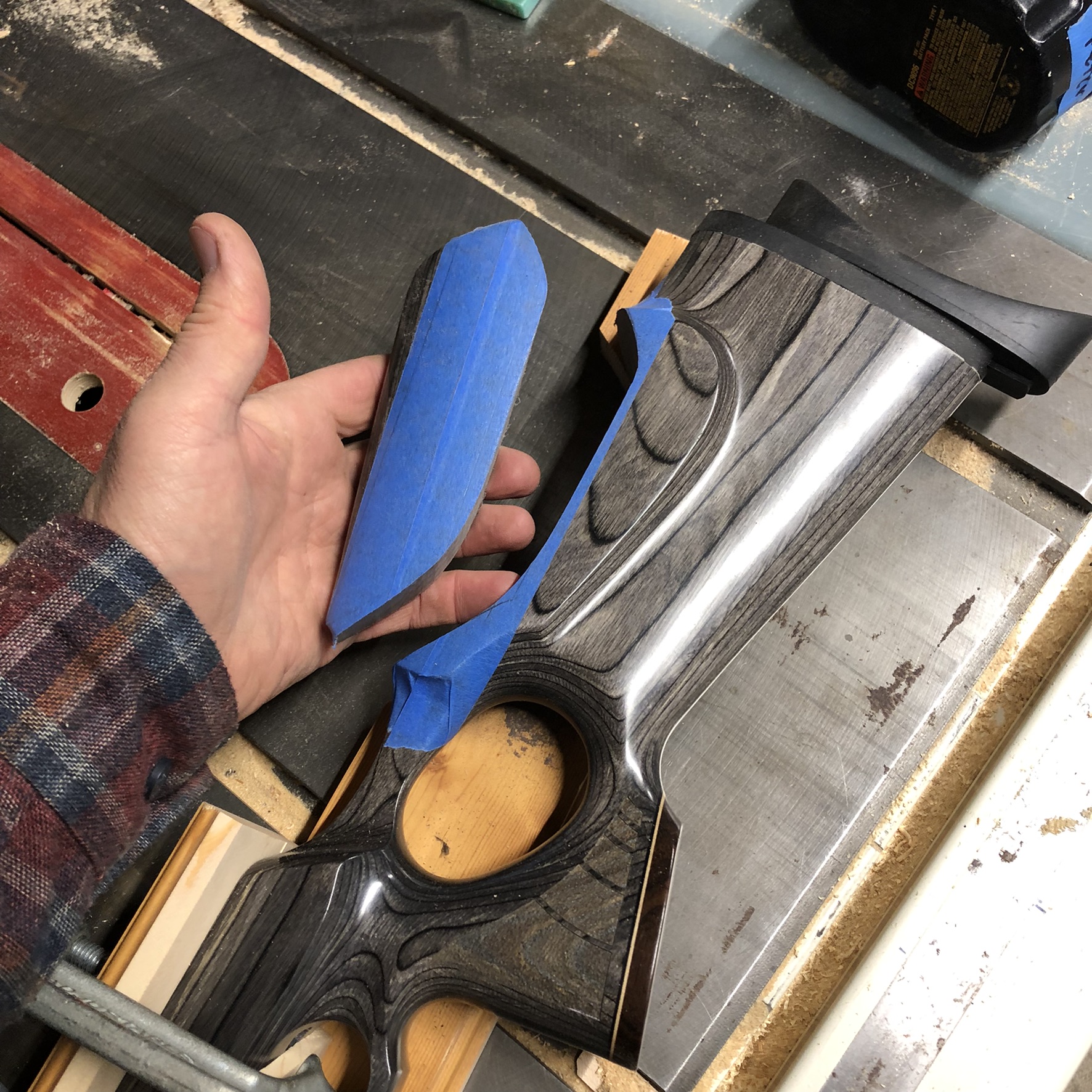

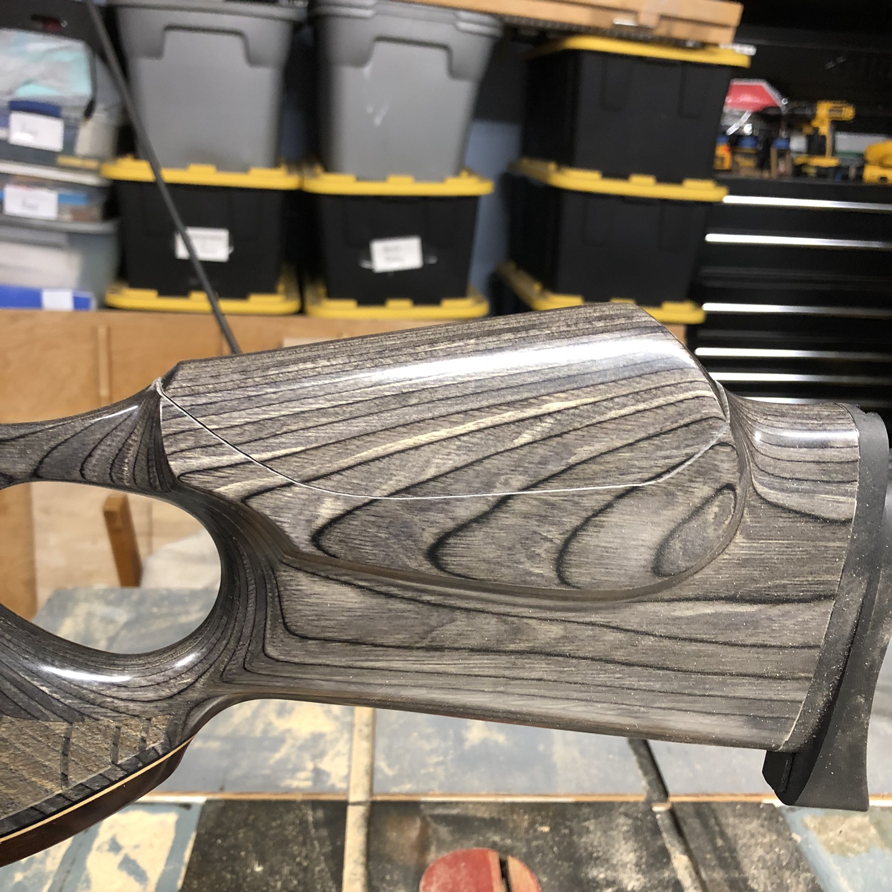

Another drawback about the gun was having to use high scope rings to use the magazines (clearance under scope). I bought some adjustable cheek rest hardware a few years back and never got around to working on it. Since the rifle is apart with the barrel work I figured it was a good time to work on the stock. I marked and cut the cheek tonight and have the center lines marked on the two pieces getting ready to inlet the pieces to receive the hardware.
Just thought that I would share the start of some mods on my Royale.
Thanks for looking!

View attachment 311592View attachment 311593View attachment 311594
Suggest a pin or dowel to strengthen the top thumb holding area after installing the cheek riser.
Great work could be frustrated by a simple stress fracture along the woods grain.
