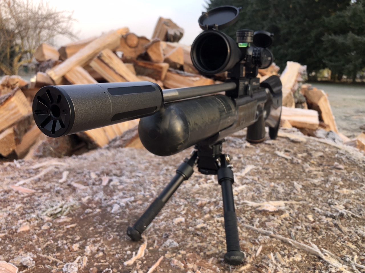

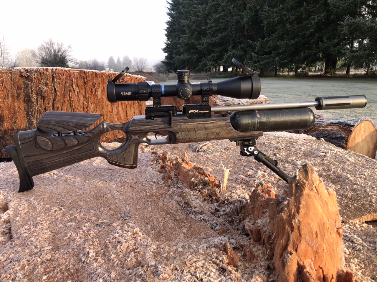

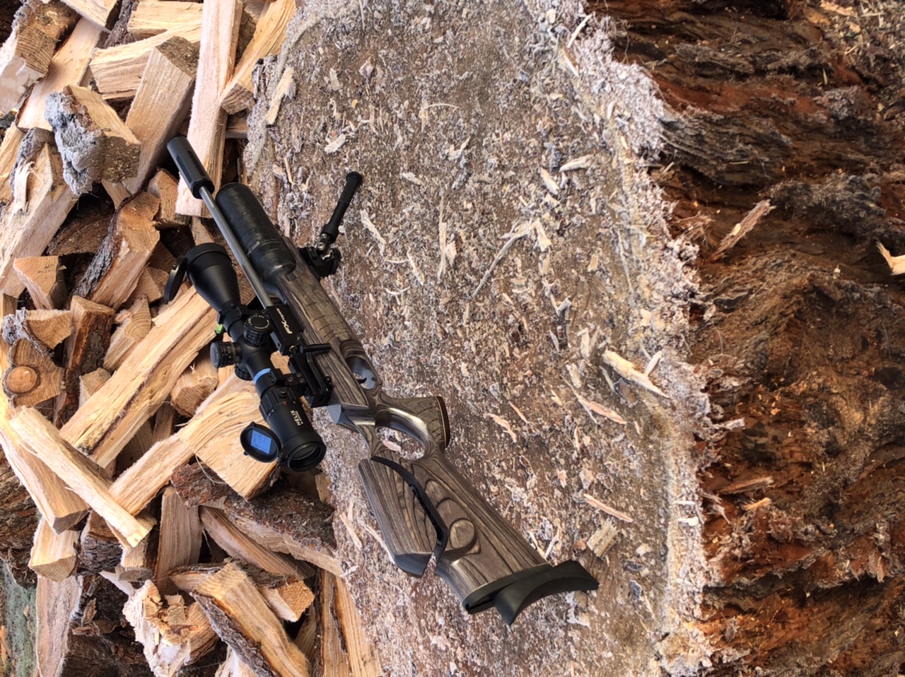

I still need to finish the barrel for protection/looks but the Royale is up and running! High power accuracy is great at 30 yards with the 16 and 18 grain JSBs. The medium and low power accuracy isn't there. I'll start into figuring out why soon.
As hoped (could it be mental) the overall feel and function is improved.
I added the Impact side lever a while back and that was well worth the effort.
The adjustable cheek is a must. So happy that I went through with it.
The shorter barrel in s nice for handling also and I prefer the look. I'm pleased with the high power setting accuracy but not so much with medium and low. Once I get this ironed out I will say that this project has been a success. The journey continues....
