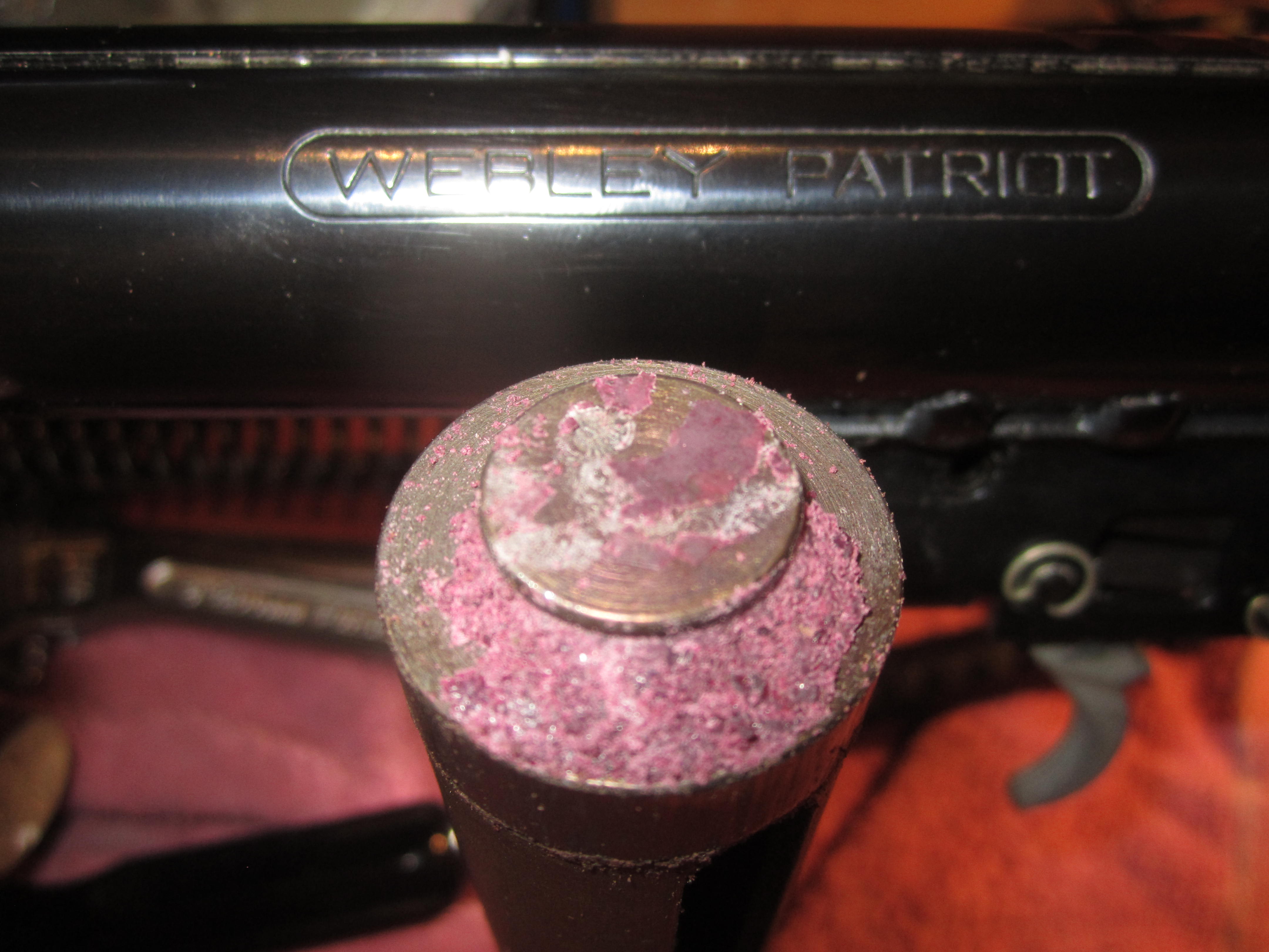

Beeman I think Cody needs a new seal?
Looks like its not sealing?
Reactions: Sc0-
Typical of the British purple seals
lots can be done to make it a better shooter.
Factory spring is hit or miss

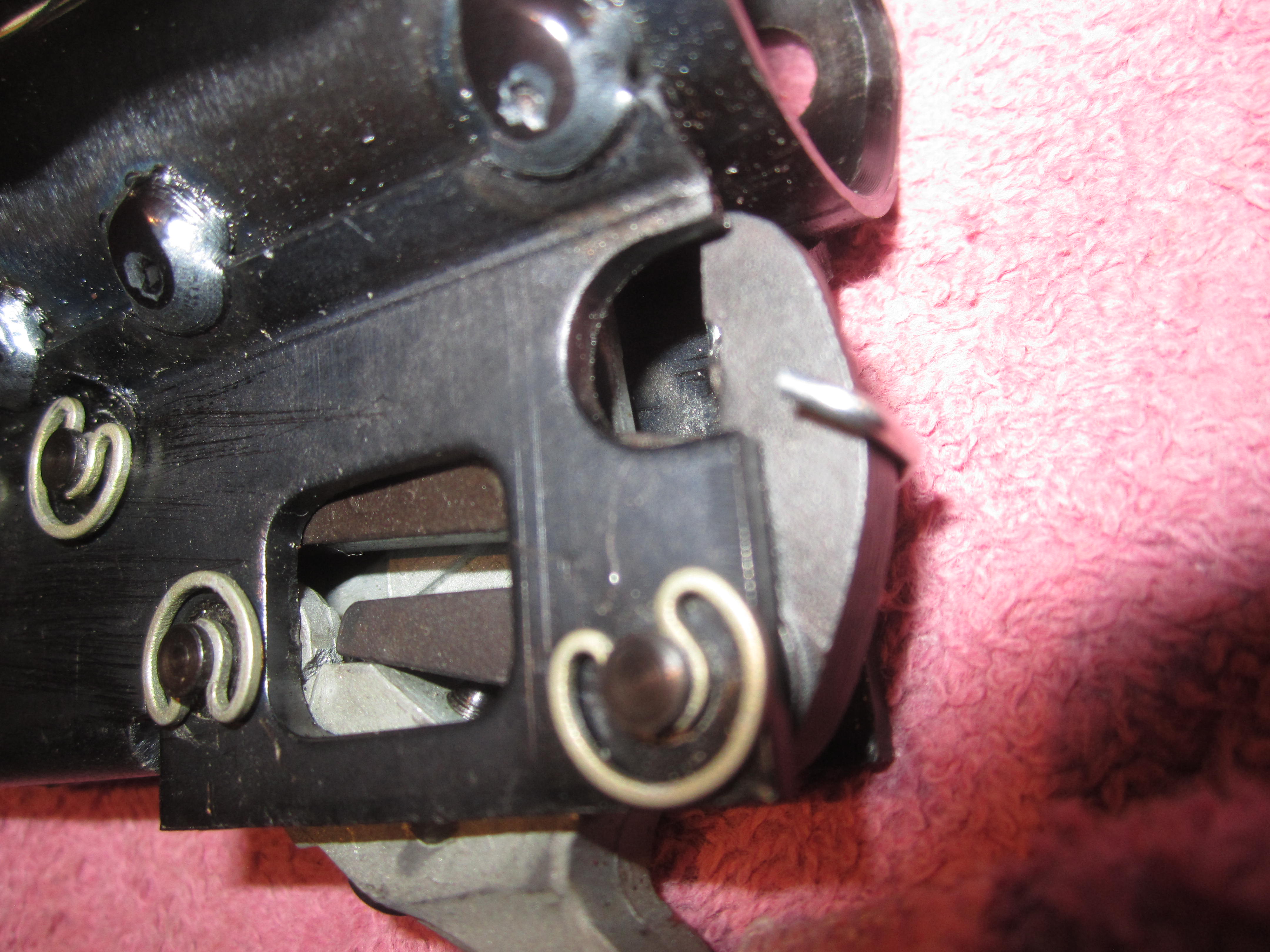

New guide and spring and some port work it’s 30 ft lb gun with a much nicer shot cycle.
The Trigger is what it is ..They tend to break there from the lateral stress of the sears .
I may have one as well springs and things

Got it all back up and running" WOW" it does have power for a 25" and accurate too"What blows me away is the small end that pushes the piston back" Scarry"Its clocken 780 with 20g,
