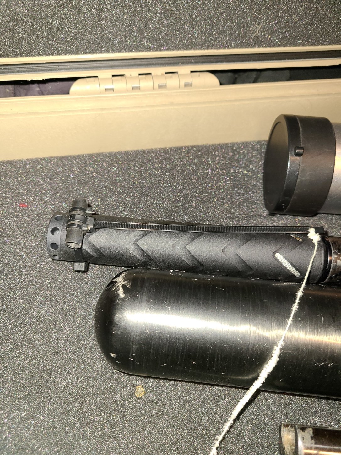

I think I have a cool idea for FT wind indicator attachment
I'm prepping a .177 regal for HFT.
Until I can machine up a more permanent solution Im looking for a good way to mount a feather string to the barrel as a wind indicator.
I want something that's foldable so I dont rip it off and ideally with a removable string so I don't have to wrap it around the barrel when not in use.

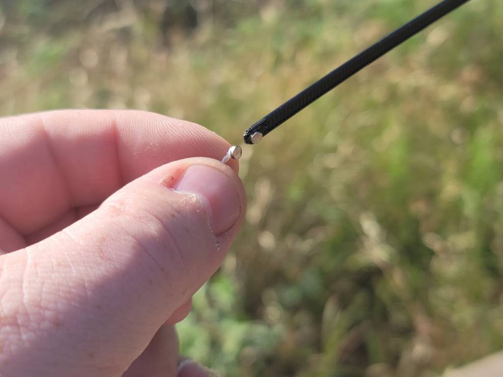

I cam up with this. Just a few zip ties and the one that sticks out pivots on a small segment off fiberglass rod.
To attach the string, I used a 3mm x 1mm rare earth magnet so I can pull it off and stick it in an envelope when I'm done.
It's cobbled together but it works perfect.
I figured I'd share the magnet string attachment idea since it works so well.
Brian

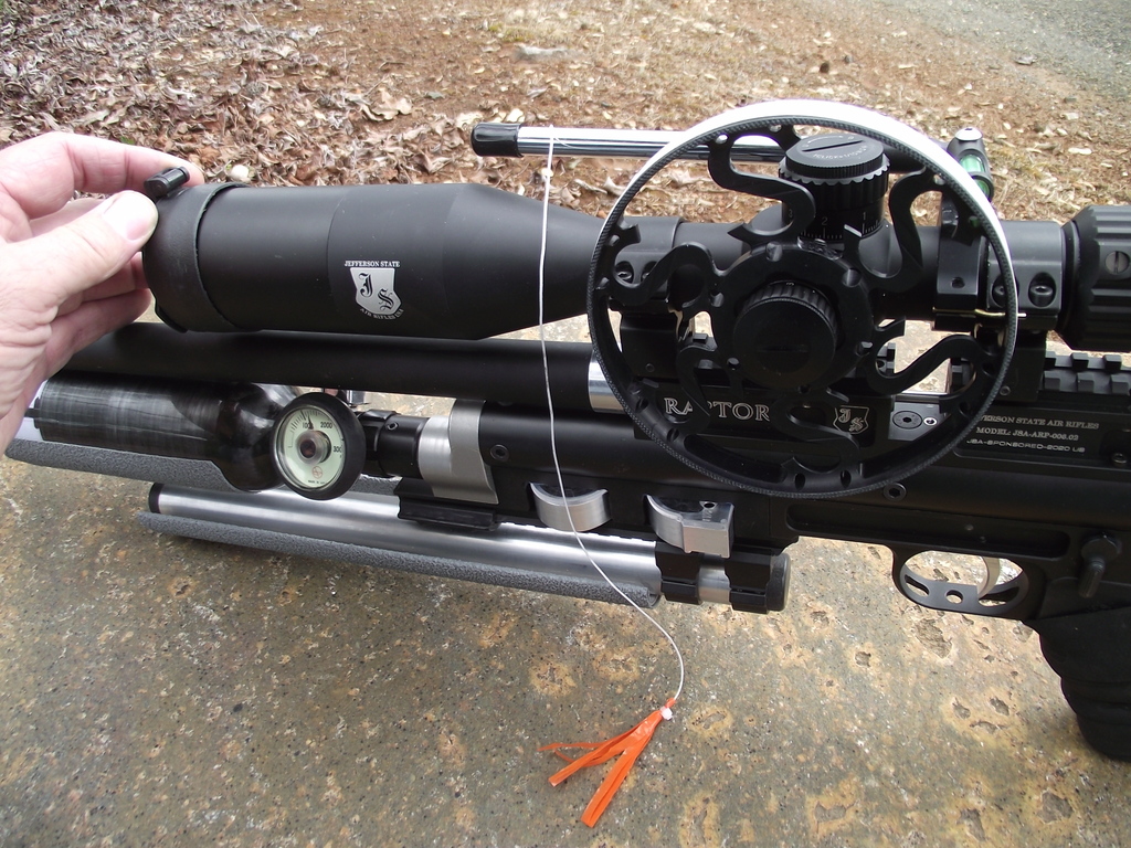

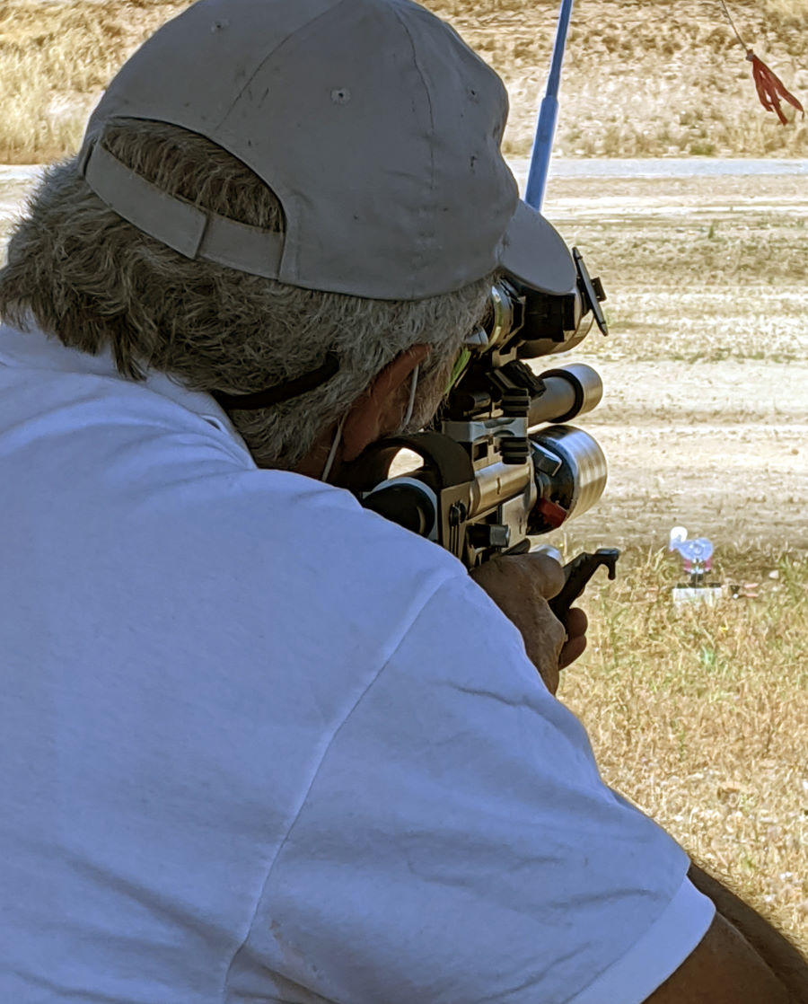

Just an FYI ....
Have an old R/C toy car, boat or aircraft ?
THAT ANTENNA makes for an AWESOME telescopic mast to attach some string & wind flag. ( attached to BKL level on a fabricated swivel foot )
It places your flag UP AND IN VIEW while being head down in your scope, in close or out further as wanted.
Just sharing options on this subject specific thread !
I make a foot that the antenna can screw into and that attaches sideways onto the BKL bubble level bracket as a snug friction fit under a single screw.
It allows swinging Up/Down pending how far out you extend the flag and how long a string you have hanging from it ?
Sorry to have distracted this thread ... was trying to help and share options.
Scott S

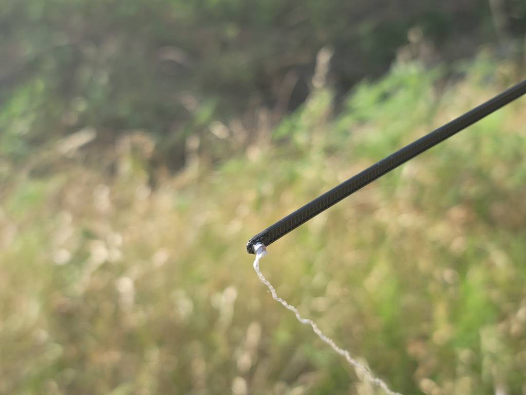

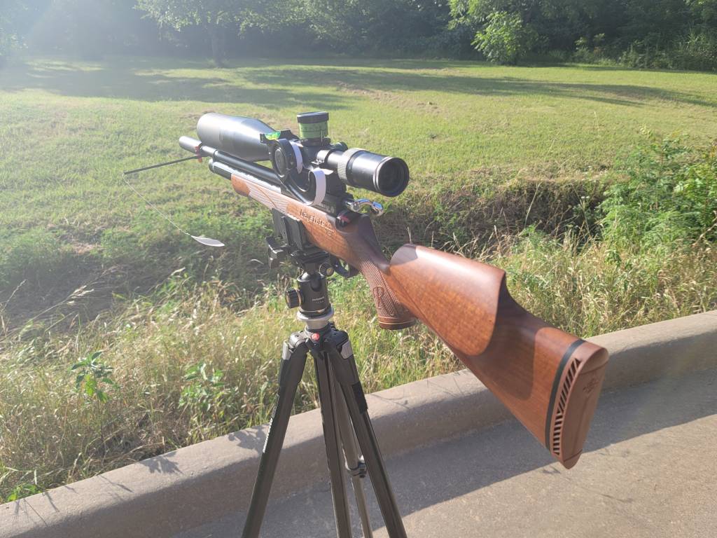

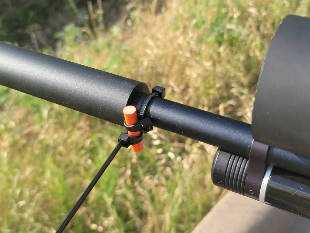

Reviving an old thread, I wanted to share how I make a wind indicator. Mine is basically the same as the ziptie windicator in the first photo with three changes.
Change 1 - I use two small zipties to attach the rod to the barrel, one above and one below the swing out ziptie.
Change 2 - I use a piece of carbon fiber arrow shaft instead of a fiberglass rod. Looks better and I have plenty of cracked carbon fiber shafts laying around.
Change 3 - I use a lighter and an awl to melt a nice round hole in the end of the swing out ziptie. Then I just thread the string into the hole and tie it on.

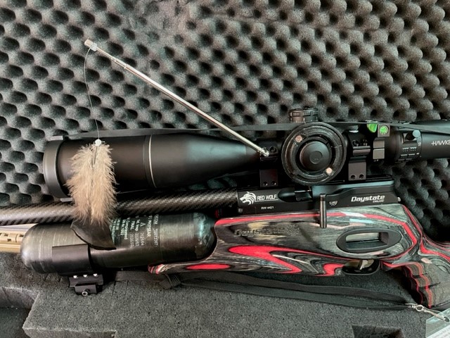

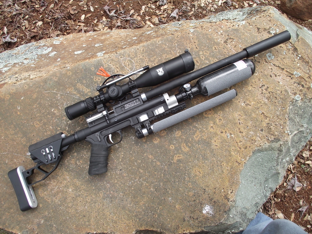

Kind of took Motorhead's idea and changed it up a little.
Got a 3 pack of Amazon replacement AM/FM radio antennas.
Shaped the base a little to fit snugly in the scope ring and used a slightly longer screw to attach it.
It swivels 360 degrees and extends or retracts. Seems like it might be a little fragile, so I don't know how long it will last.
Thanks Motorhead!
Thanks Motorhead!
I was thinking the same .. screw in radio antenna then here you are next post with one 👍. ( Great minds think alike🥴)..lol
