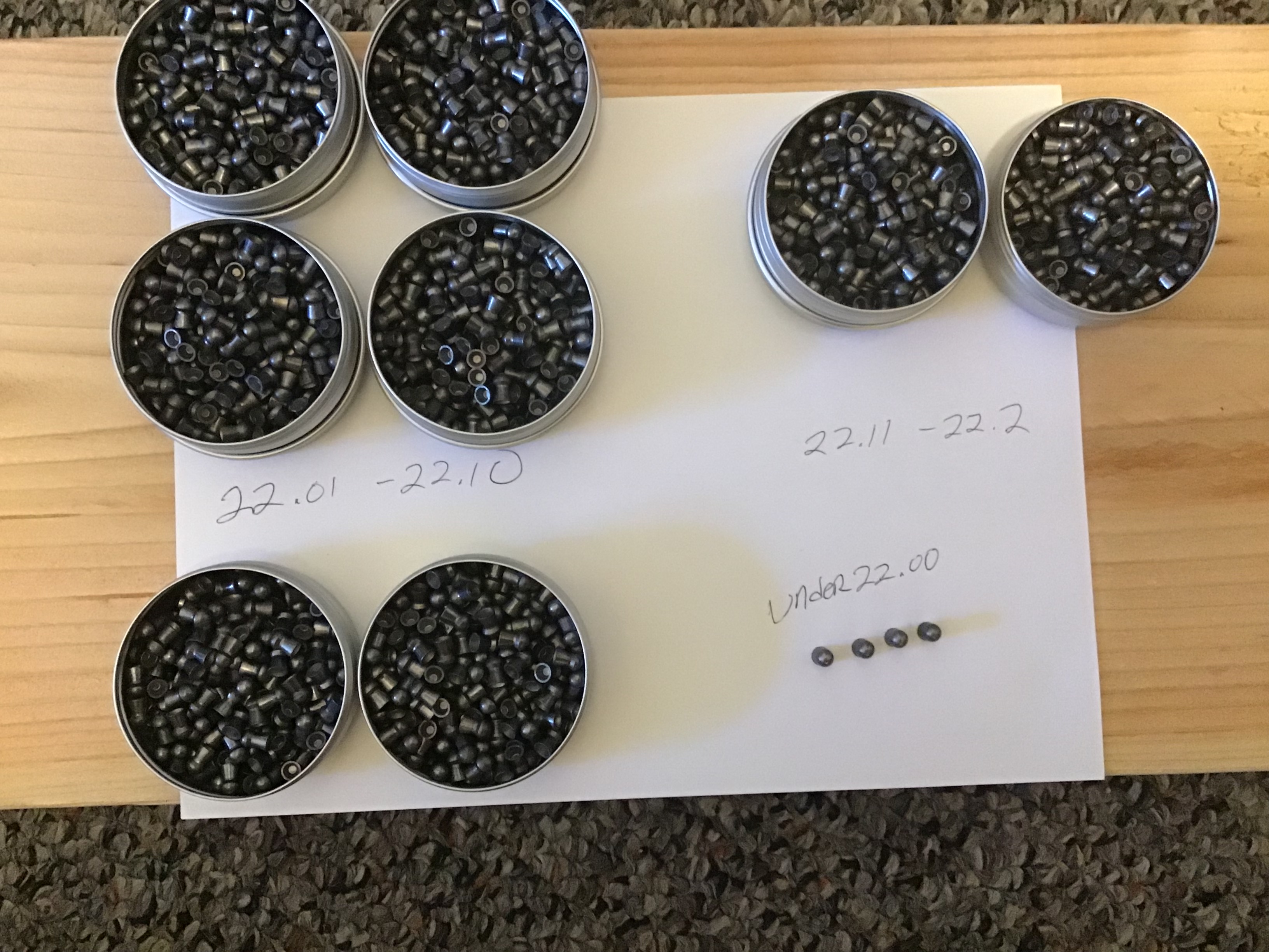

I think i have been wasting my time with JTS
Sorting them was kinda a waste of time
I recently made a purchase of some JTS 22.07g pellets to try out.
Needed a replacement for the JSB's and their failing quality control
I have been using them straight from the tin for 50yrd shooting with great results, but for 100, i wanted to sort them by weight
This is where i think i wasted my time ...
I sorted out 1500 pellets to the 1/10th of a grain on a scale that goes to 1/100th
I ended up with 2 main groups and 4 ..yes 4 that were lower than 22.00g and Nothing above 22.20g ..Out of 1500!!!
The quality control is So Much Better than JSB!!!
I will still sort for 100 yards, but with these JTS, I just need2 piles
