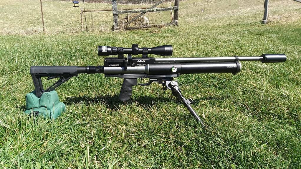

I hear ya. I disliked the looks of my Challenger Pro so much I tried to sell it. When nobody seemed interested I decided to do my best at "de-ugly-fying" it without spending too much. Below is the result (I've since added a bigger scope). Now I enjoy shooting it as much as any of my other rifles. Gobs of power and much better than average accuracy. My only complaint is the trigger, I wish it was adjustable. If they made a bullpup version of the Challenger Pro I'd buy one.
