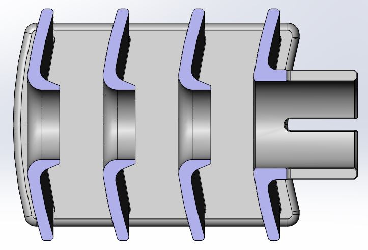

If you take some pictures of your air rifle muzzle with the moderator off, and the dimensions of the handguard, I can cook up a design for a basic air stripper. The thread designation is the most important thing. Ideally, a simple brake or air stripper could be machined from aluminum. It could be made more fancy with a cone havening an adjustable stand-off distance from the muzzle.
Are you concerned with recoil reduction? If so, is that an important factor? I ask because simple perpendicular vents are the simplest to machine. Else, rearward jetting vents could be to reduce the recoil further, but it increases the complexity of the part.

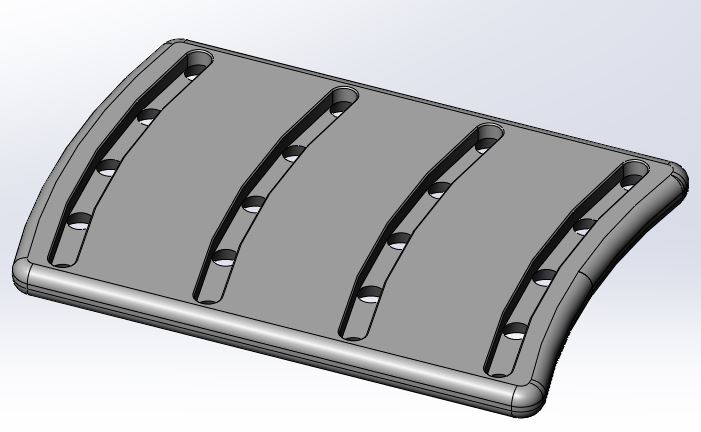

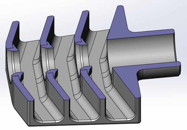

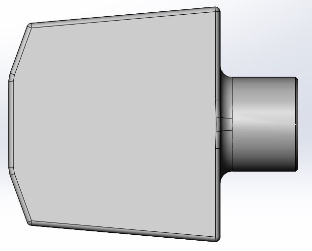

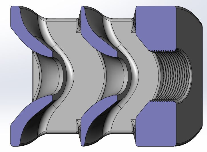

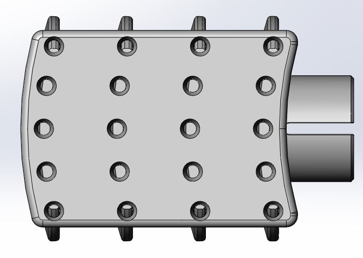

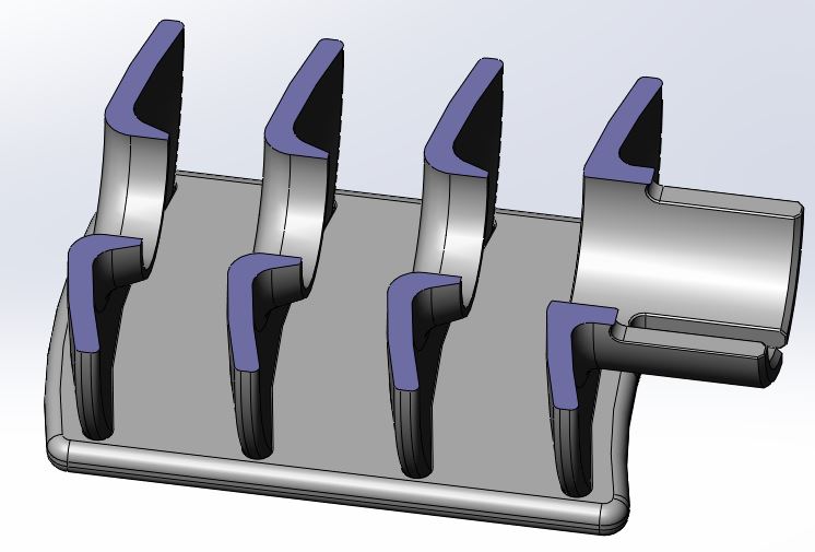

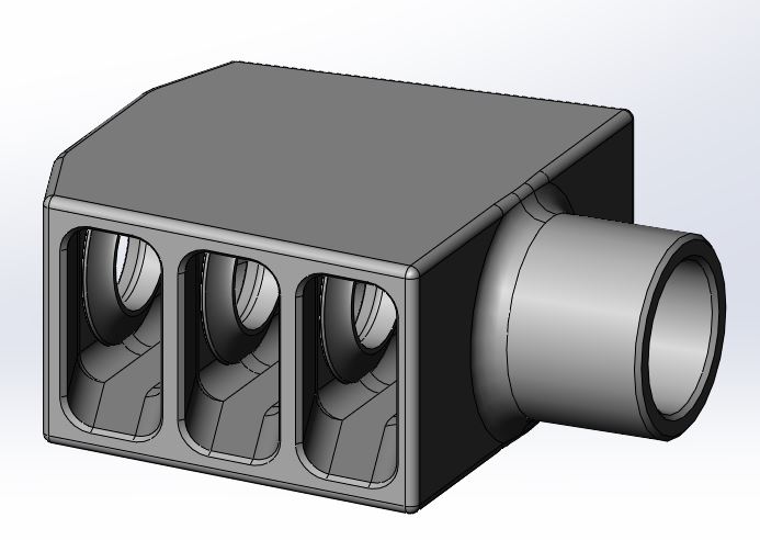

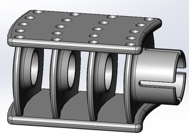

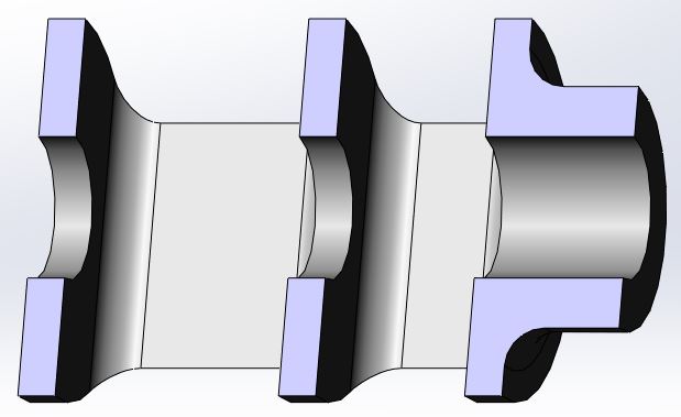

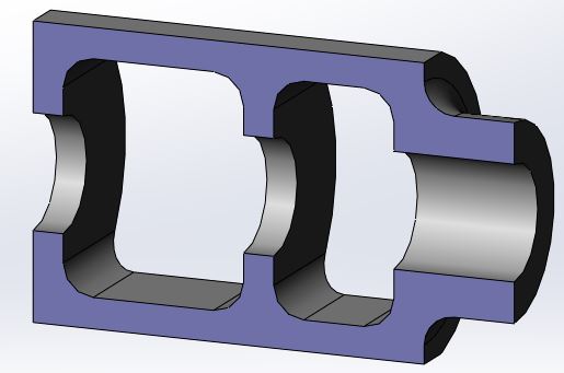

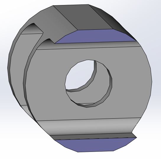

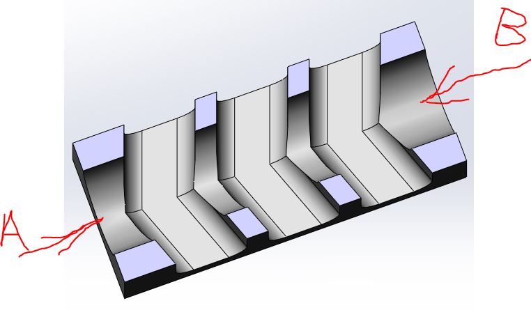

Below are some ideas for a 3000 FPE 20 mm air rifle. The owner has a metal muzzle brake and claimed 3D printing was the only way to produce it. So, I came up with machined baffles and plates that could be welded together, if one wanted to. There are also some other brake ideas I did at the time.

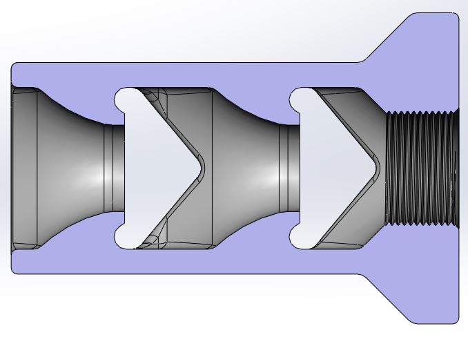

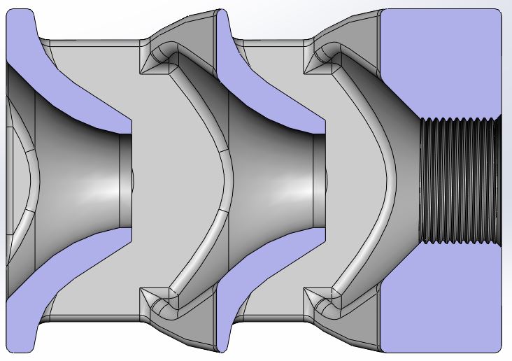

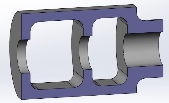

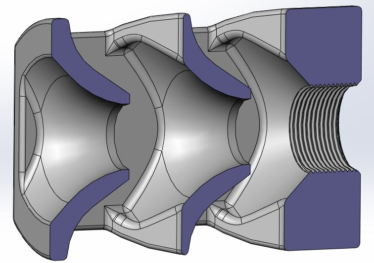

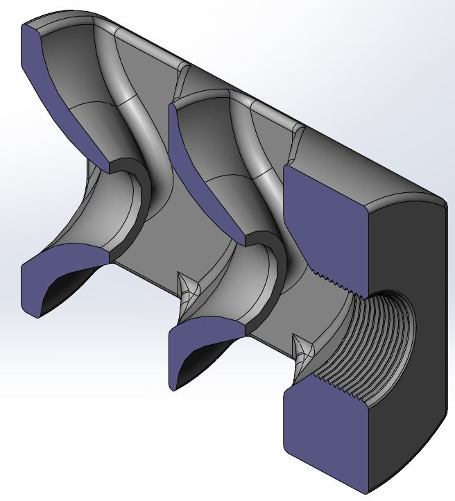

The simplest brake is only show in section with two red arrows, indicating air flow direction. In one direction (A) the brake works best at air stripping. In the other (B) is works best at recoil reduction. The angle of the ports could be optimized for air stripping, but for the best combination, turned inserts can be added - as used with the other designs.
I see these designs as way overkill for your .457, as the recoil on that is nothing compared to the 20 mm monster. I have some other muzzle brake designs, if I can remember who I did them for, I can find the designs

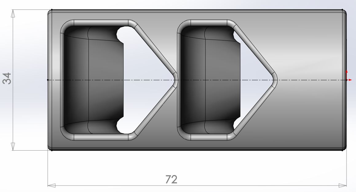

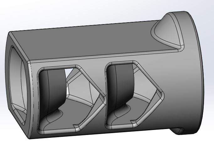

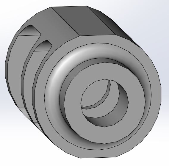

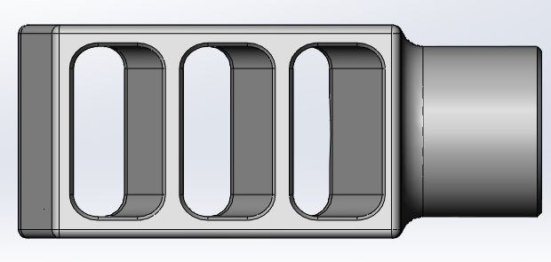

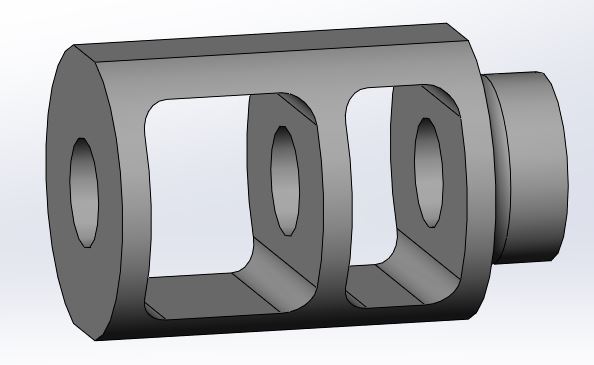

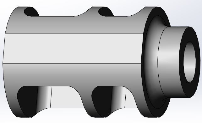

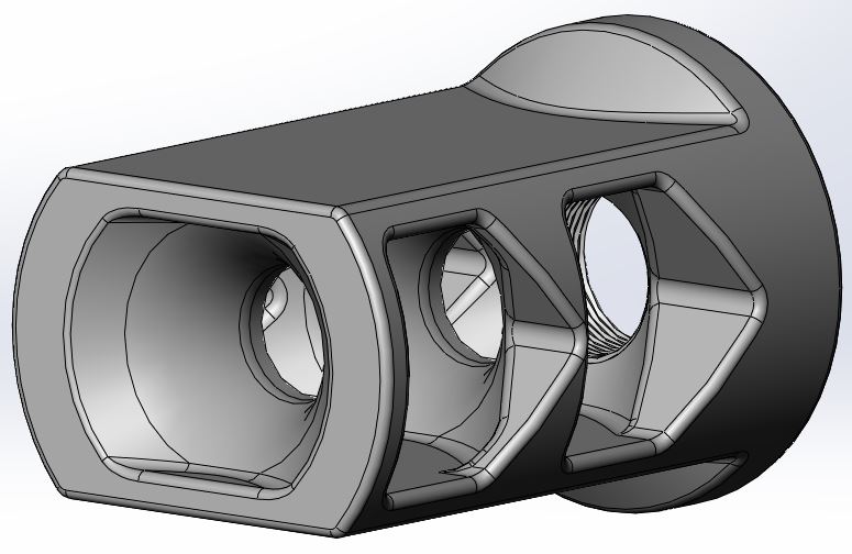

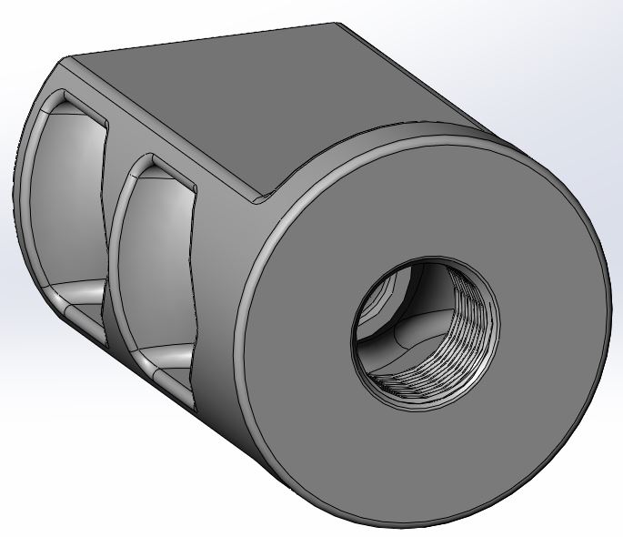

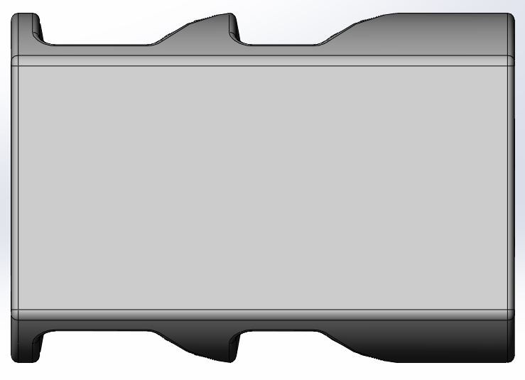

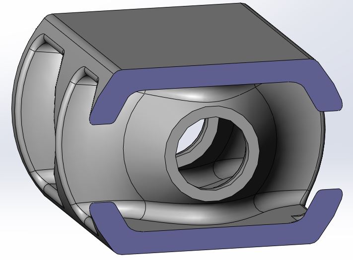

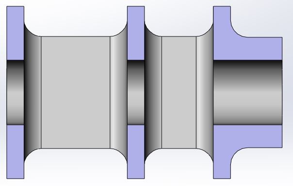

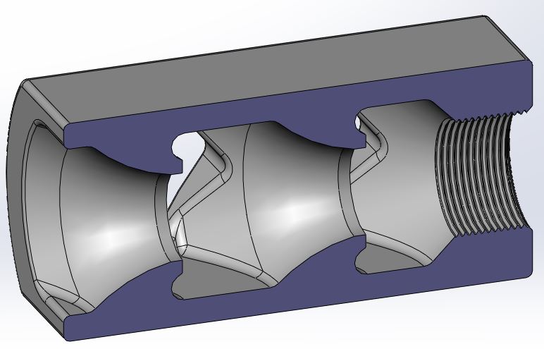

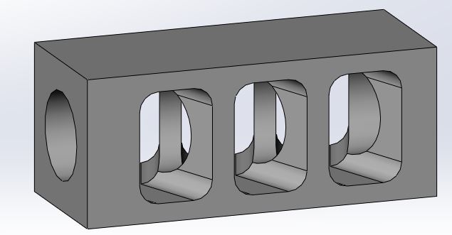

Below is a very basic machinable muzzle brake/air stripper design I did for someone else - see images. Note that the mating thread is not shown, and that the hole for the thread is shown smaller than it would need to be to accept the barrel stud - or adaptor stud. This is the sort of thing I would recommend for you, unless you want something more fancy.
All I need to know is the mounting thread, and the max outside dimensions you can tolerate, or want.

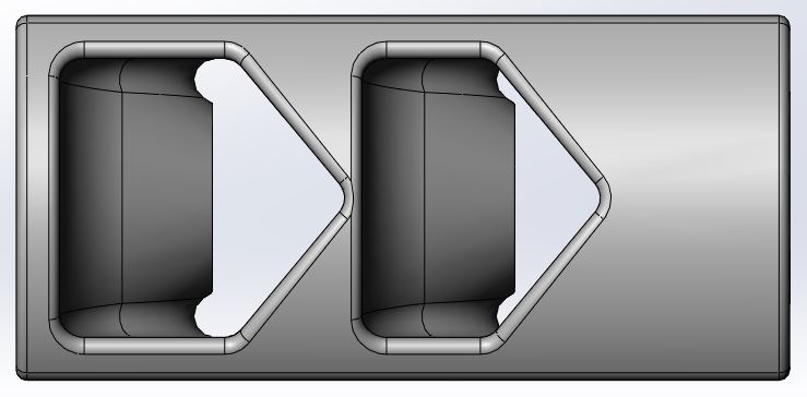

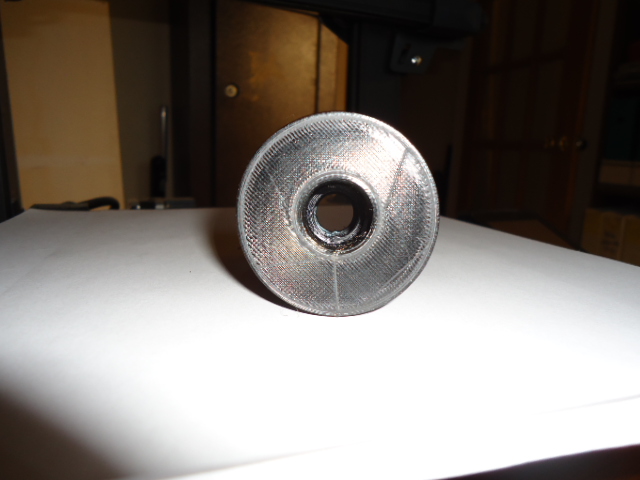

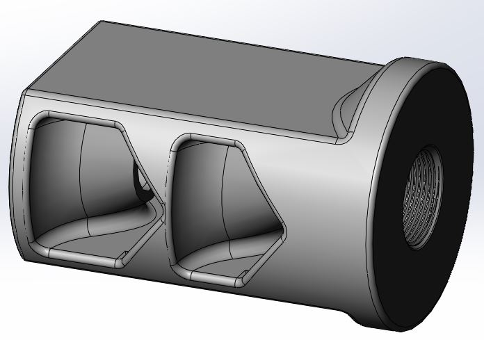

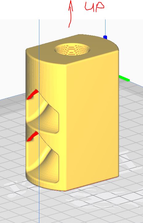

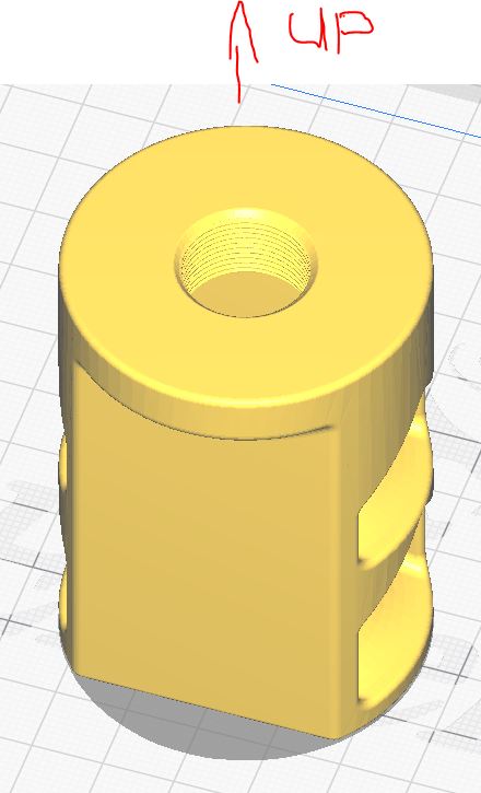

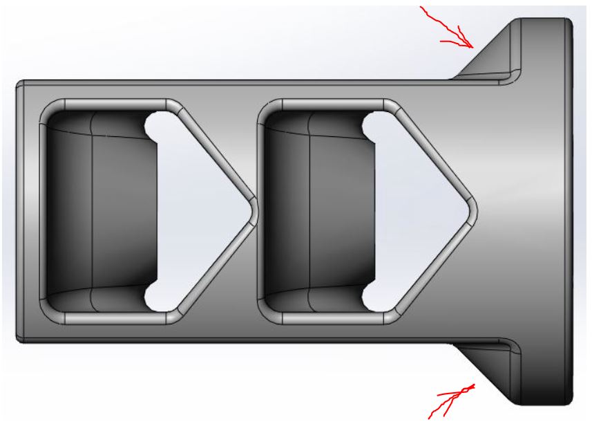

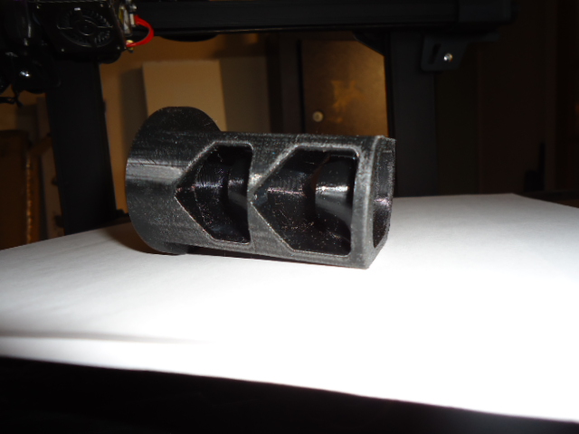

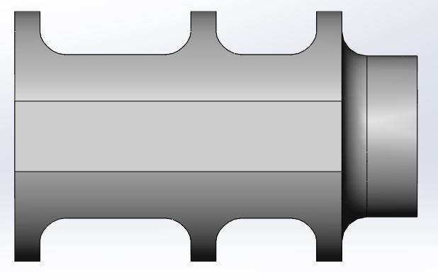

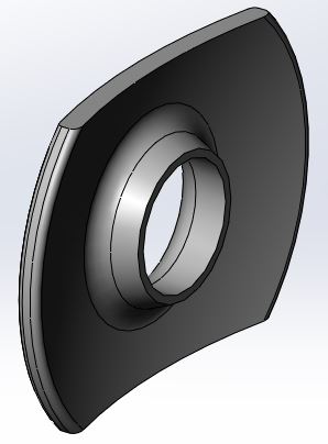

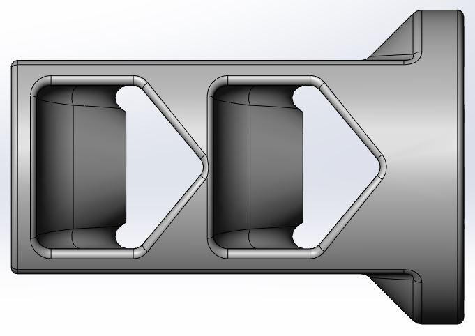

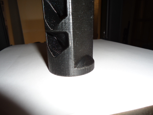

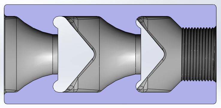

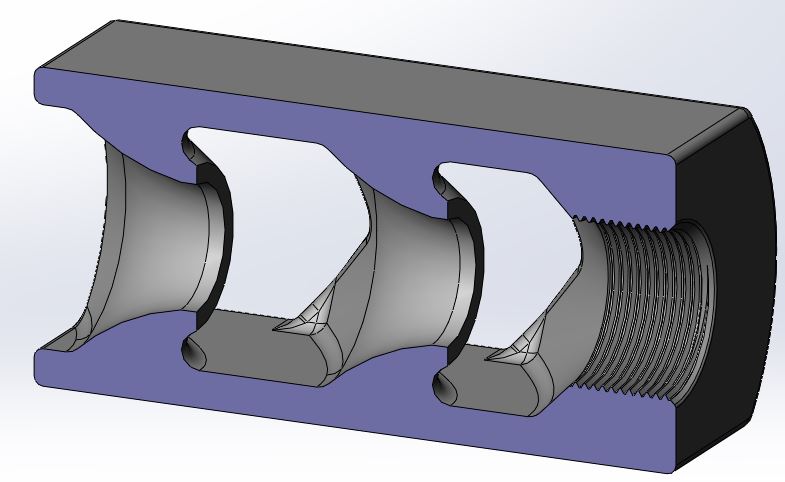

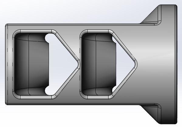

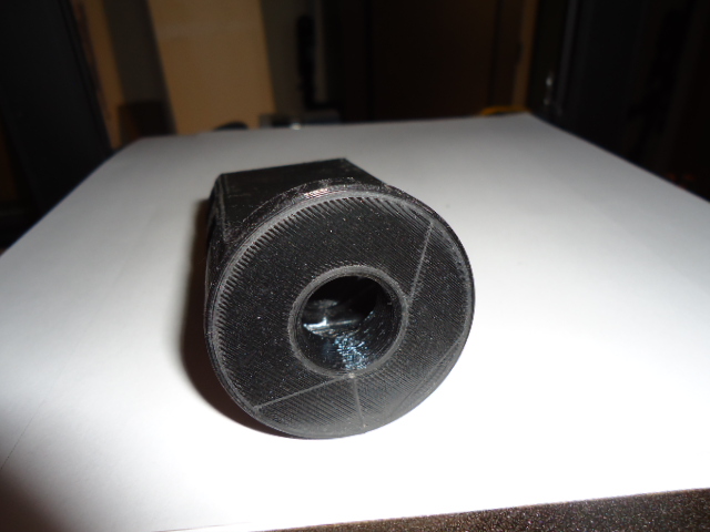

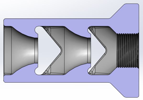

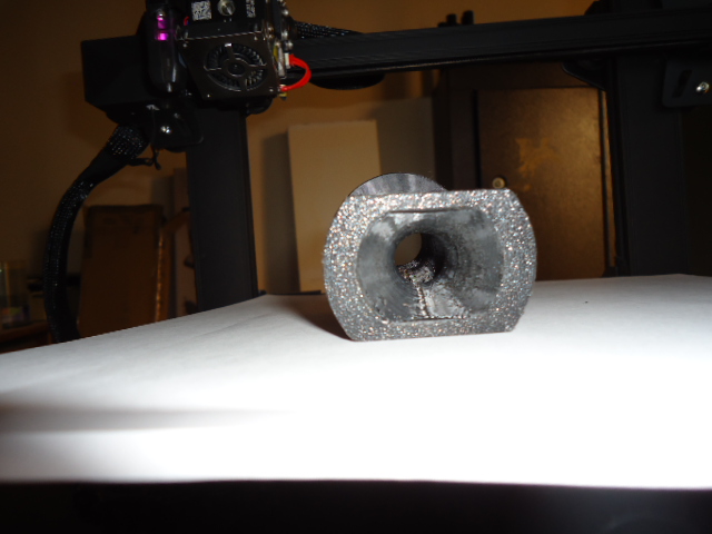

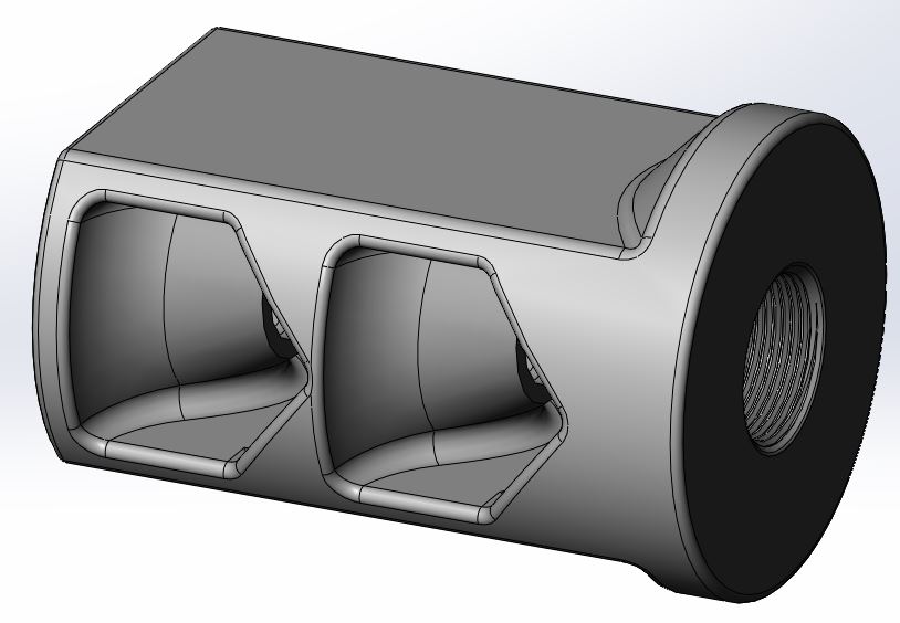

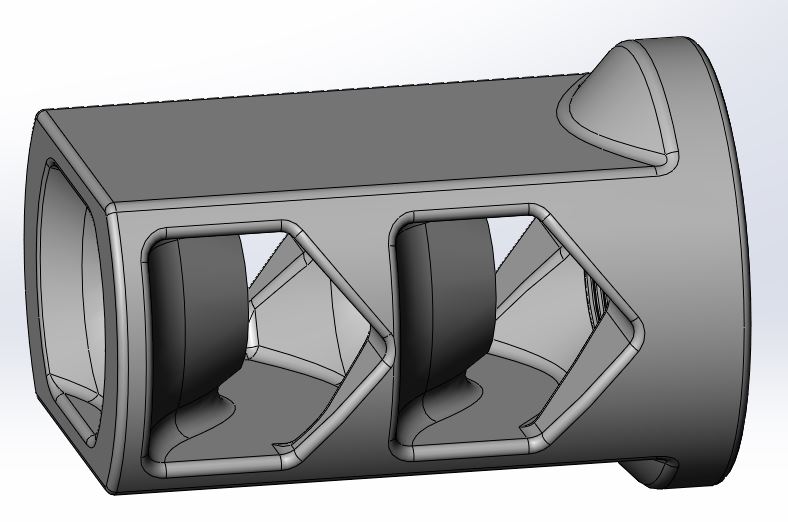

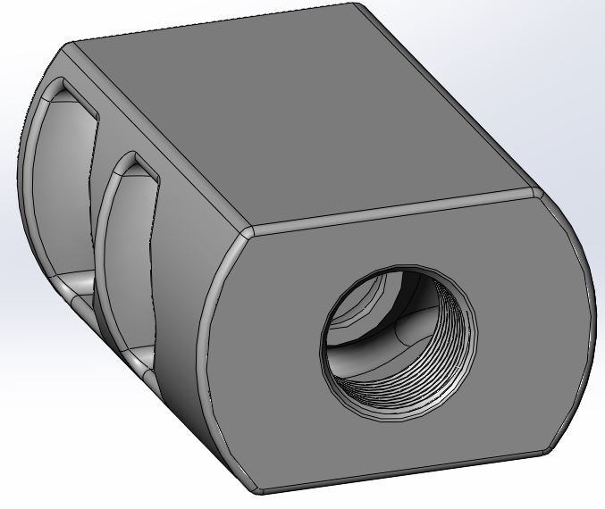

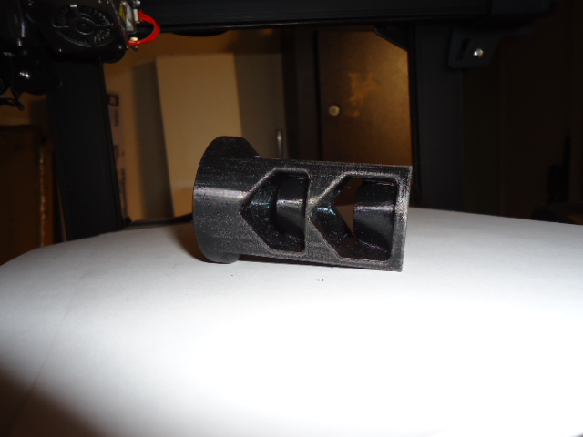

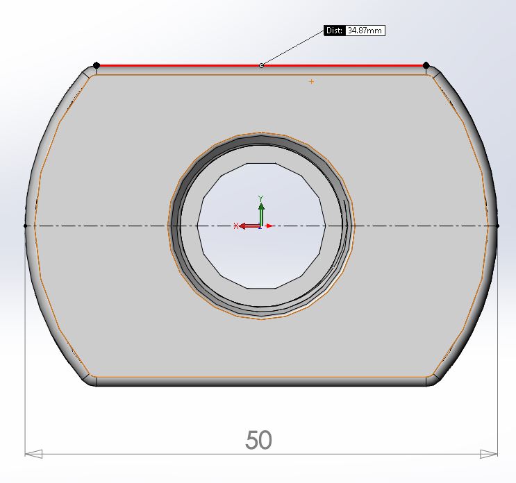

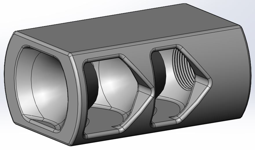

So, I found that the DFL adaptor for the .457 Texan has a M18 x 1 mm thread. I looked at images and assumed the stud is 12 mm long. The Texan barrel shroud / forend looks about 50 mm outside diameter. I used this info / assumptions to design a muzzle brake / air stripper that could be printed from PETG - so many people could do it for you. I could recommend someone, if you like. See images below.
The attached zip file contains the STL print file, and the STEP file for this part. Since I started drafting this reply, I created a second version of the brake that has a rear flange to better stabilize it against the adapter in the vertical direction. Both types of brake will need to be "timed" with shim washers to place the flats top and bottom - although that is not essential for function. It has more to due with reducing the blowing up of dust.
If any of my info or assumed dimensions are bad, please let me know. I will update the design, if indicated.
The parts need to be printed with the mounting threads pointing up, else the cones will not print correctly and the thread may not fit.
The intent is to print at 100 % infill, although a low percentage infill may be used, provided the total inner and outer "wall" thickness adds to 4 mm. Else the part may not be strong enough.

The image order is a little jumbled because I attached them en masse:

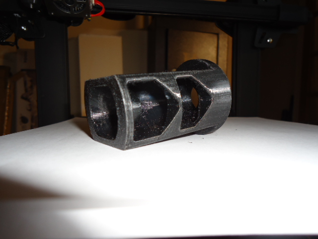

I suspect you'll be able to get away with a robust plastic 3d print. But given you've got a pretty high-powered rifle you might want to stay safe and use a metal brake.
I agree that of a suitable metal one can be found, that is the way to go. The reason for a custom design is the emphasis on air stripping to improve grouping, rather than reduce recoil. The clue is in the short stand-off distance between barrel muzzle and the first cone face; and the longer second cone stand-off from the first cone.
As for a custom printed design, that can be made out of metal too. If machined as one piece, I would simplify the design. The reason why I made the basic diameter 50 mm was to match the handguard diameter.
