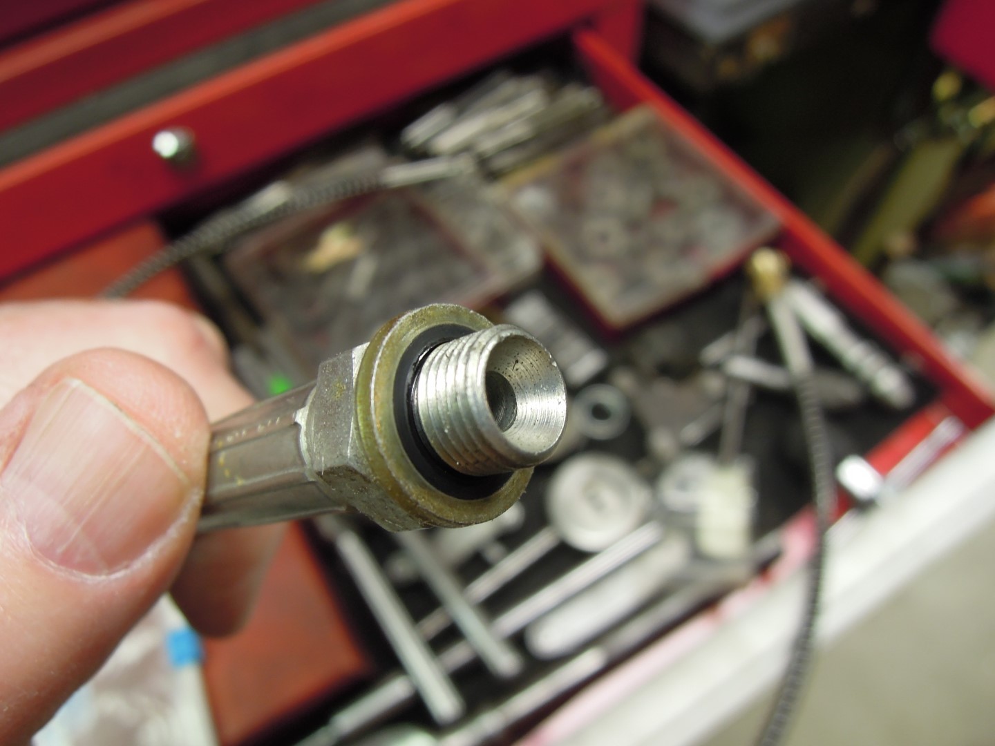

This is the end of the incumbent short whip. Although it has a tapered section like a JIC fitting, there is no male tapered part in the brass pump fitting into which is screws. The air is sealed by the washer.

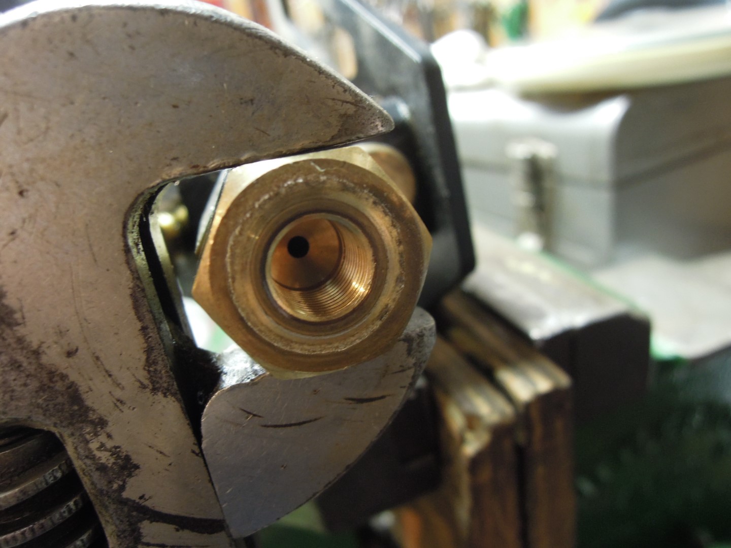

This is the fitting on the pump into which it screws. It has another female type JIC section in it, not a mating male tapered area.

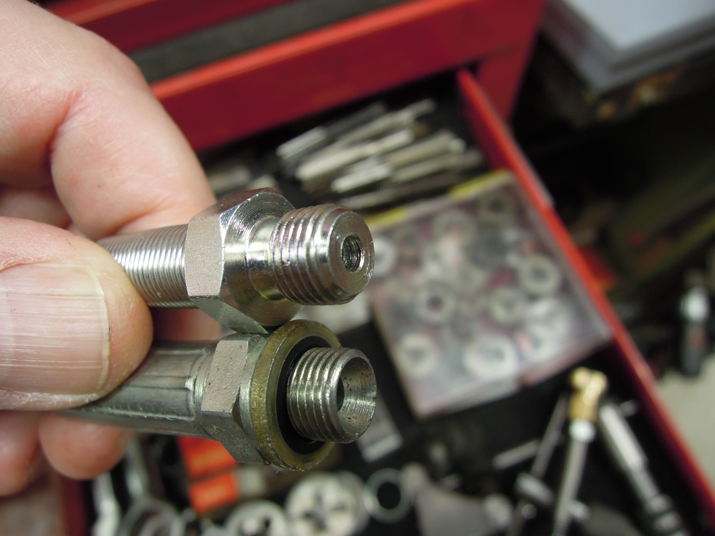

Here's a comparison of the new longer whip's end on top and the incumbent short whip's end on the bottom.

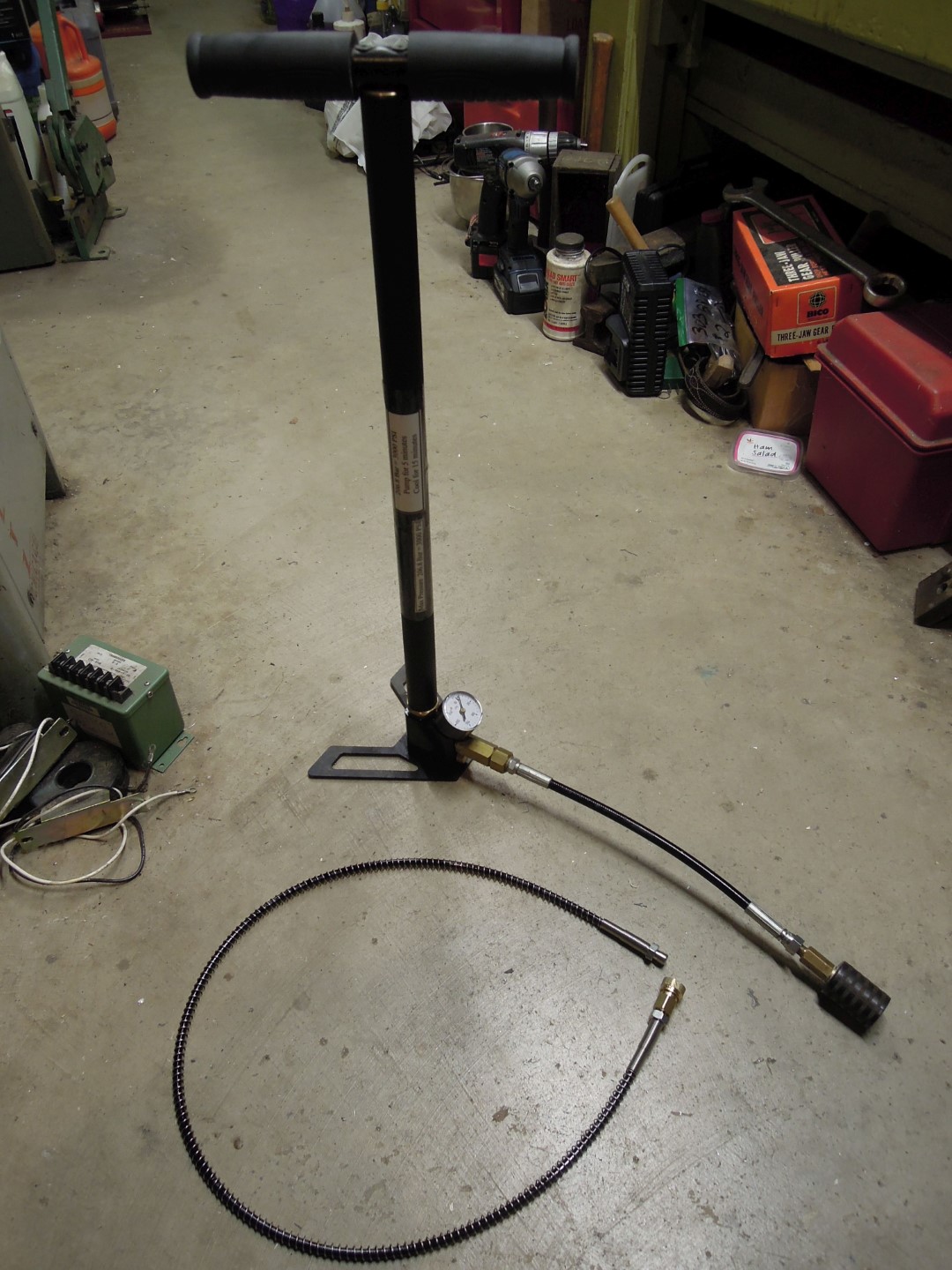

This is the pump I'm trying to upgrade. It came with my AirForce Talon as part of the package in 2006. There are no branding identification marks on the pump that I can find.
