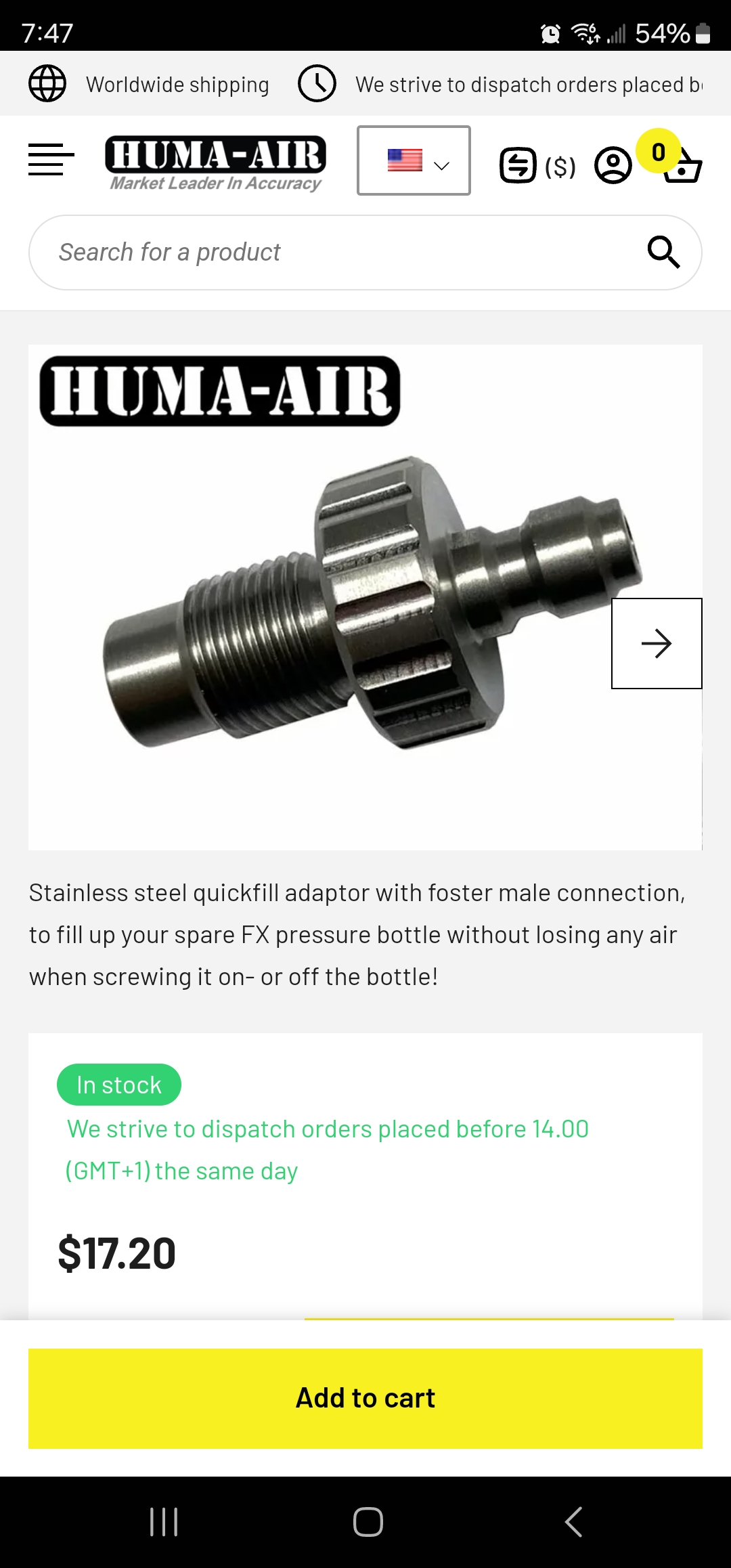

Scotay42 Member Jun 23, 2021 1,326 2,436 Somerset, KENTUCKY, United States Dec 28, 2024 Add bookmark #6 Dec 28, 2024 Add bookmark #6 It would need to be an adapter to fit the tank , tapered down to a fill nipple. This kne is for an FX Upvote 0
Dr. Kralenstein Member Apr 14, 2022 4,642 8,043 The Laboratory, United States Dec 28, 2024 Add bookmark #7 Dec 28, 2024 Add bookmark #7 Most bottles are m18x1.5 thread. Some are 5/8-18 UNF. If you're planning to use it as a fill station/buddy bottle, you'll need a valve or regulator. Something with an in and an out nipple, as well as a pressure relief screw. Upvote 0
