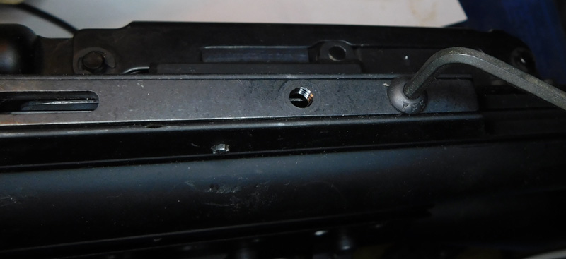

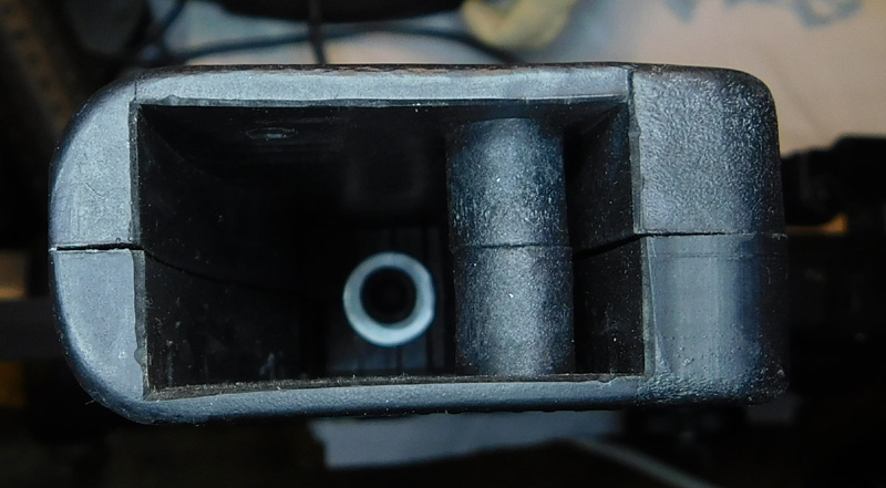

First remove the handlre 5/32" hex

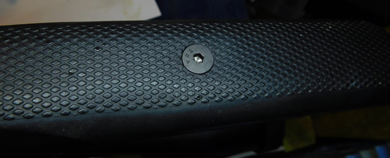

Next remove the front "stock" 1/8" hex

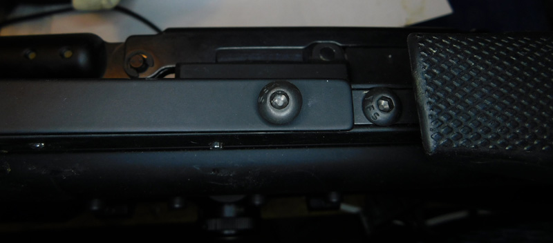

Remove trigger guard 1/8" hex

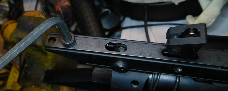

Remove front trigger screw 1/8" hex
Remove rear trigger screw 5/32" hex
Remove trigger "blade" and safety "blade" 1/16" hex. Mine was crazy tight one screw on the safety stripped the hex and had to be removed with wice grips.

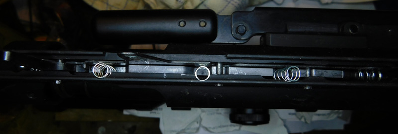

Here's the innards, please note the positions of the springs, they are different!

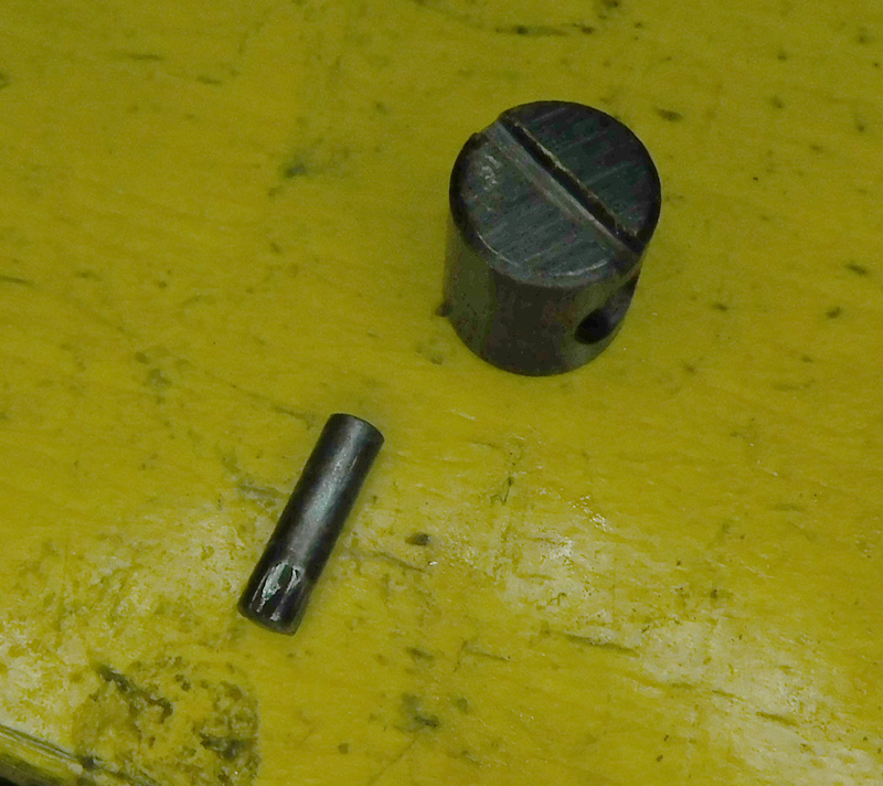

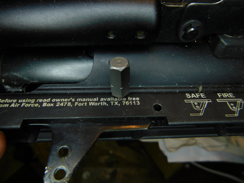

Tap out the set pin for the transfer bar (i used a small torx bit to do this. From right side with all the print.

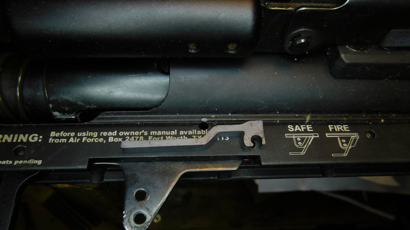

Remove transfer bar

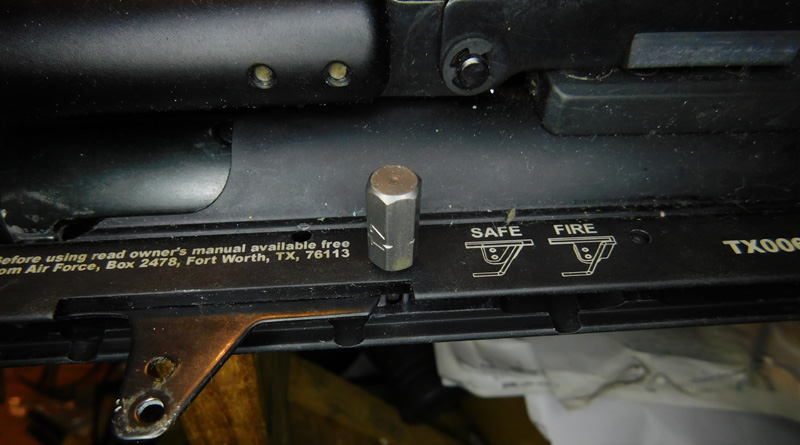

Tap out this pin
And your auto reset transfer thingamajig will rattle out
Assemble in reverse order and try to index the pins with the indentations in the frame.
This is what a pin looks like and you see the splines and why they have to go out from right to left and why it's best to try to index then again in the holes.
