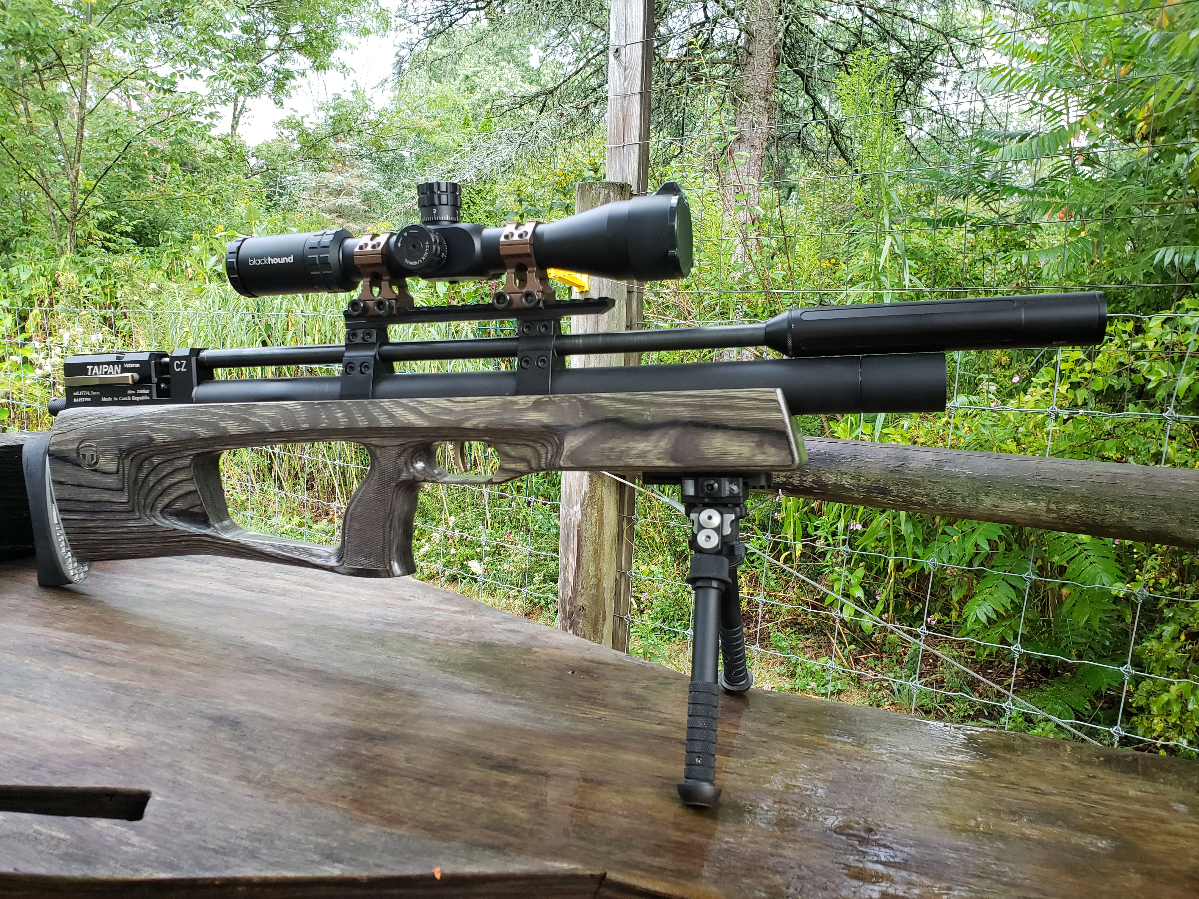

Hey guys - update on Saturdays debacle ( my meltdown ). The gun did in fact malfunction and that is what ( in part ) was due to my horrible day of shooting. I decided to at least look at it today ( lol ) and when I took it out in the back yard to start re-tuning it for the heavier monster 13.43's it started behaving EXACTLY like it was last Sat @the FT meet. ( "... what the frick is going on with this thing . . .? " ) I'm mumbling to myself. I take a close look at the front end of it and "! Whoa . . . " - clipping - BIG TIME. I took it back in the house and pulled the shroud off of it and sure enough there was LOTS of "shrapnel" ( bits & pieces of mangled pellets ) in there. A couple of the baffles were dinged up to boot - one of them essentially destroyed. I've never seen anything like it. I've NO idea what may have caused it to do this. Maybe I fed a pellet in backwards? Or a couple of them backwards? I dunno . . . .
Anyway - since I had it somewhat apart - I pulled the barrel, gave it a good cleaning, decided to lose the shroud altogether and just slap a spare Donny moderator on it that I have ("koi" I think it's called) It's ( the gun in general) is only an inch or two longer in overall length now with the moderator vs. with the native shroud. I think it'll still be acceptably quiet . . . . we just had a wicket thunder & lightning storm roll through - I may be able to get out in the back yard and test it out . . . or not. If not - then - tomorrow or the next day.
Here's what it looks like now sans the shroud - "naked". ( lol ) 31.5" overall length now
