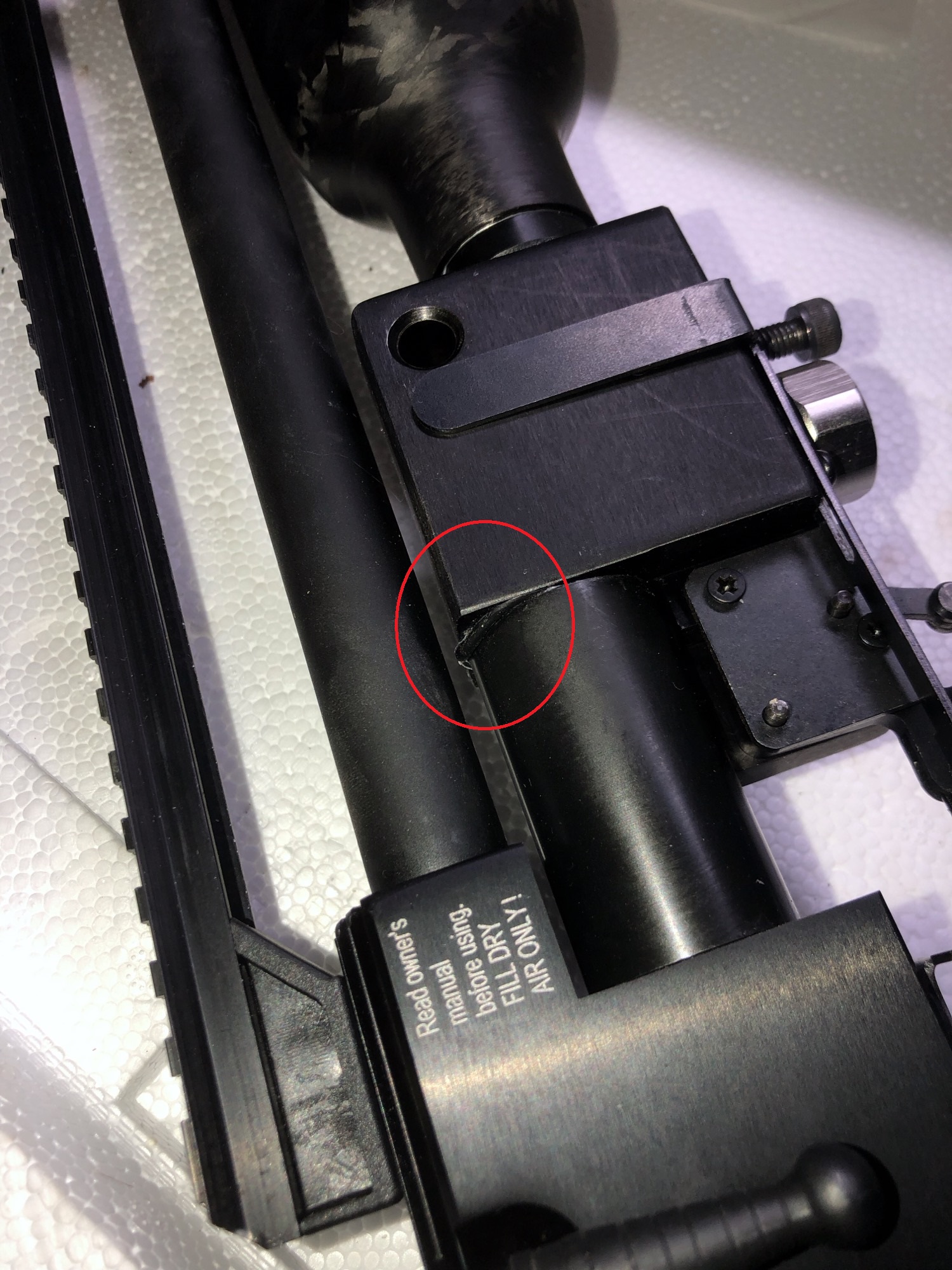

When I got it all I did was cock it and then heard something rattling in it. A piece of the internals broke just from cocking it. When I got it back it had air in it. I set it on my bench after I cocked it to see if it broke again. The next day a O'ring popped out of its seat and it lost all air.
ok now we (AGN) have something to go on and a picture . IF you are confident to change out the o ring , i would do that . Maybe air it up and see how long it takes to drain and also soap that area to make sure that is what is leaking . before you send it back . To me it looks like a "to fast " repair job
Agreed with what you said but I assume that as soon as I work on it then the warrantee is void. I was even worried about just taking the stock off. If I was to fix it I assume that the barrel has to come off first. I have no idea if it is threaded or not since the exploded parts pics don't show threads on it. Like I said before, it would be great if manufacturers had detailed repair instructions. To me it seems like I would need to unscrew the barrel so that I could unscrew that first air block to get at the O-ring. Funny, guns come with replacement O-rings but no instructions as to how the properly replace them.
you are right about the warrantee . I would send a detailed Email with the picture and ask for a return and a new gun replacement
