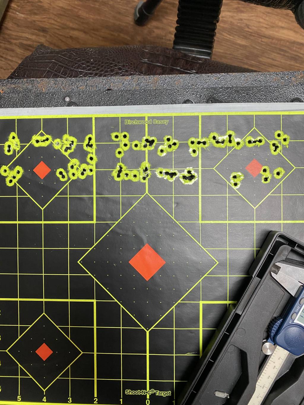

2. What kind of accuracy should I be expecting? Not only out of my gun but in general to be competitive in HFT All the 5 shot groups below average 0.480 inches or about 12 mm at 25 yard. With a little wind. If that really matters at that range. I shot all these also from a tripod.
