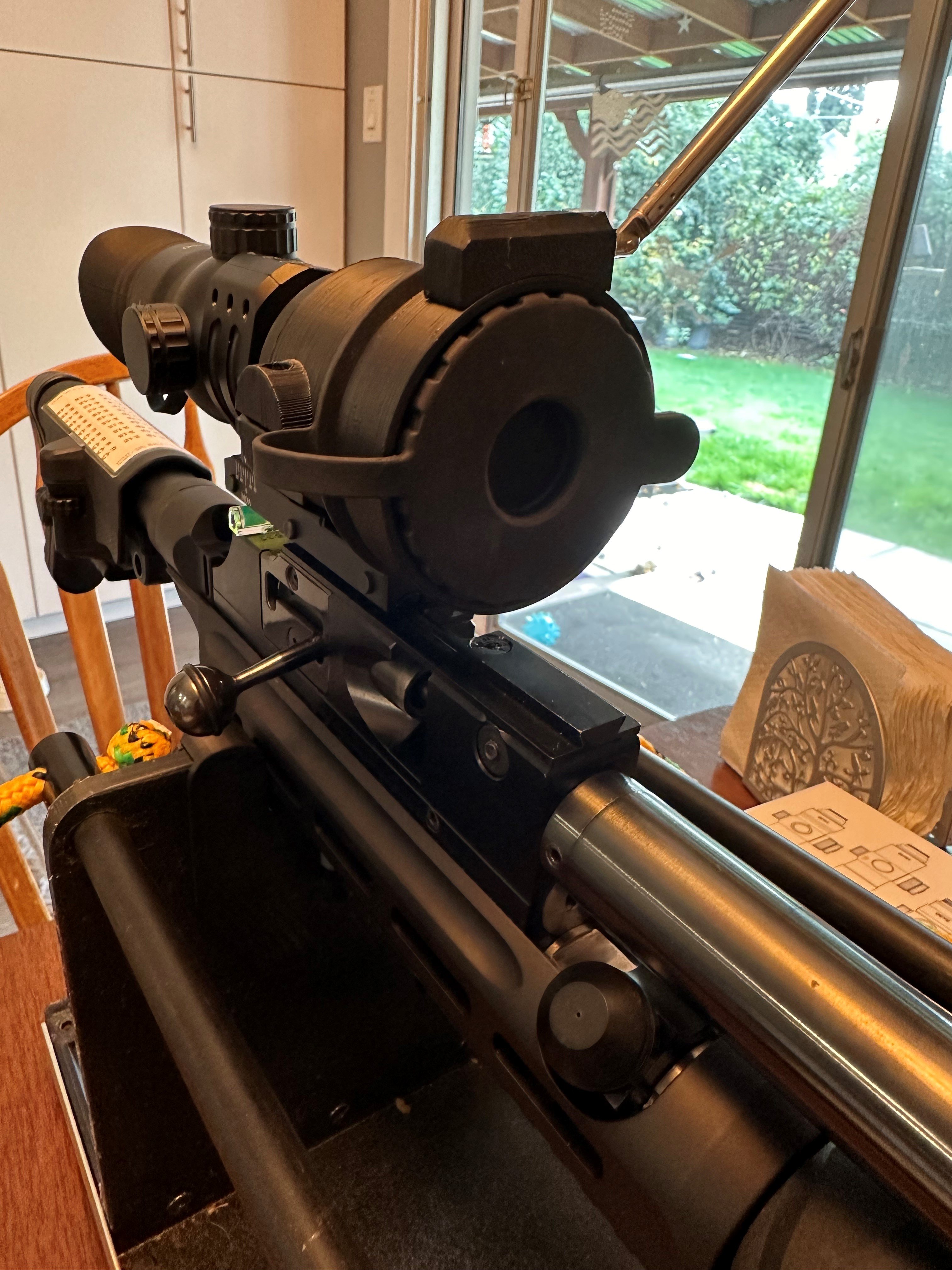

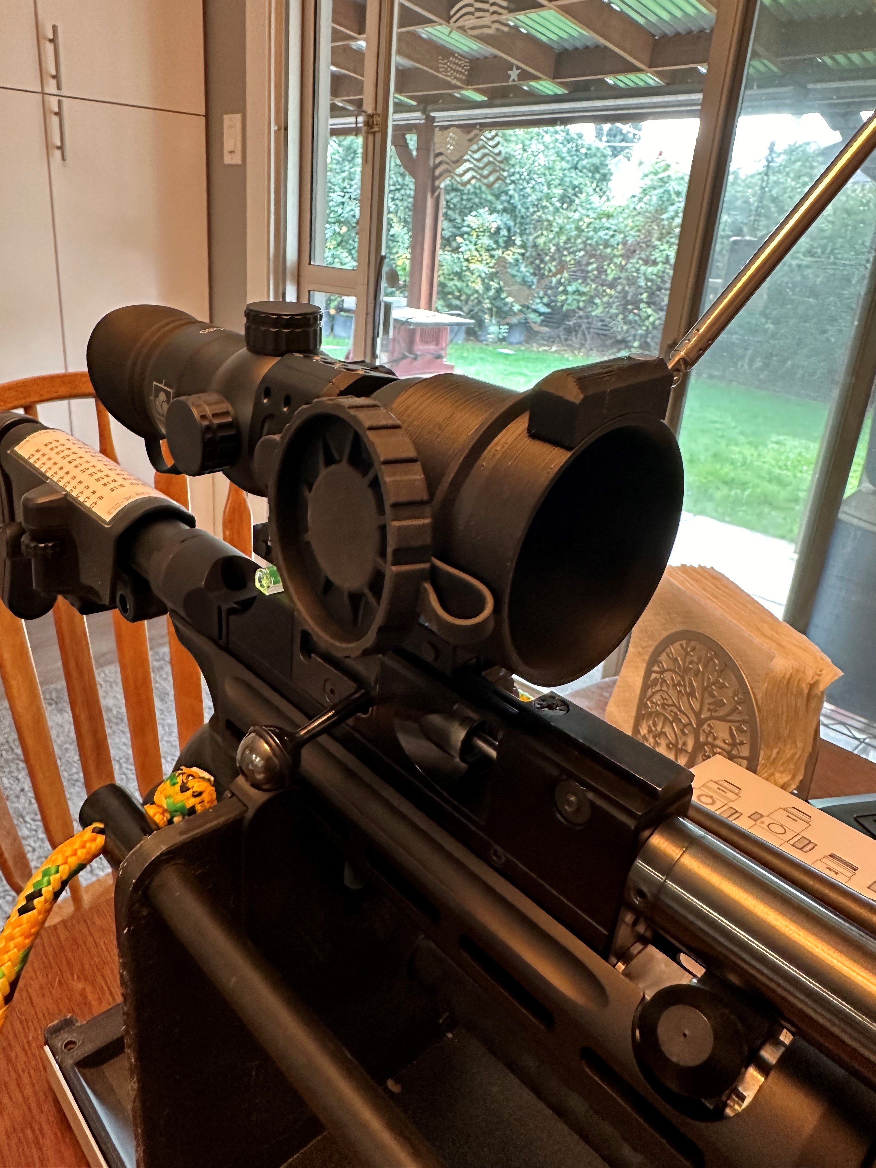

Typical wheel set up has the pointer mounted on or near the back scope mount. This set up has a sunshade and pointer rigged to read the inside of the scopewheel. The slice of wheel is 120 degrees of a 7" wheel. Enough to range from 8 to 70 yards. The sunshade has a button to mount the cap on when not in use (keeping consistant with the original scope design). The cap fits inside the shade instead of around.

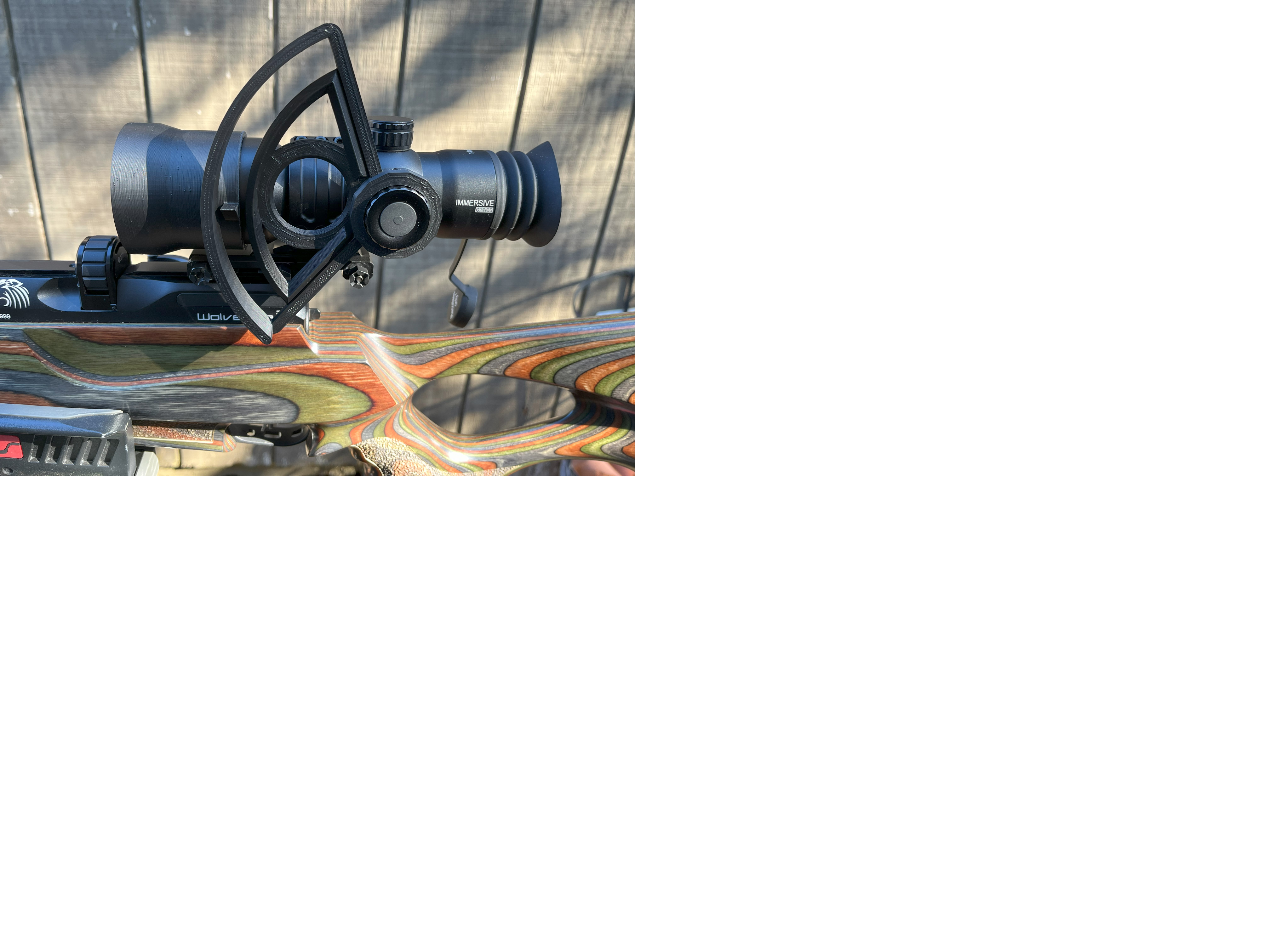

@SacramentoSam sent me one for my 14x50 IO and I have 10 through 30 measured out. I am joining an new range and orientation is this coming Saturday and after that I will get it out to 55 yards. The shade with the pointer on it is very good and give the 14x50 a bit more clarity - which it already has a lot.
With the little testing I have done so far, it is my intention in using the rig in HFT. So far the markings on mine have been spot on with the card I made and I have been scoring better (in my home range) better than with my other scope. I have it mounted on a Wolverine R shooting 10.34g FX pellets. Will post more results after next weekend when I get it fully ranges out.
@SacramentoSam did a great job on the wheel and the shade! I haven't looked, but I think the Element Immersive is the same wheel so his wheel and shade should work for that scope also.

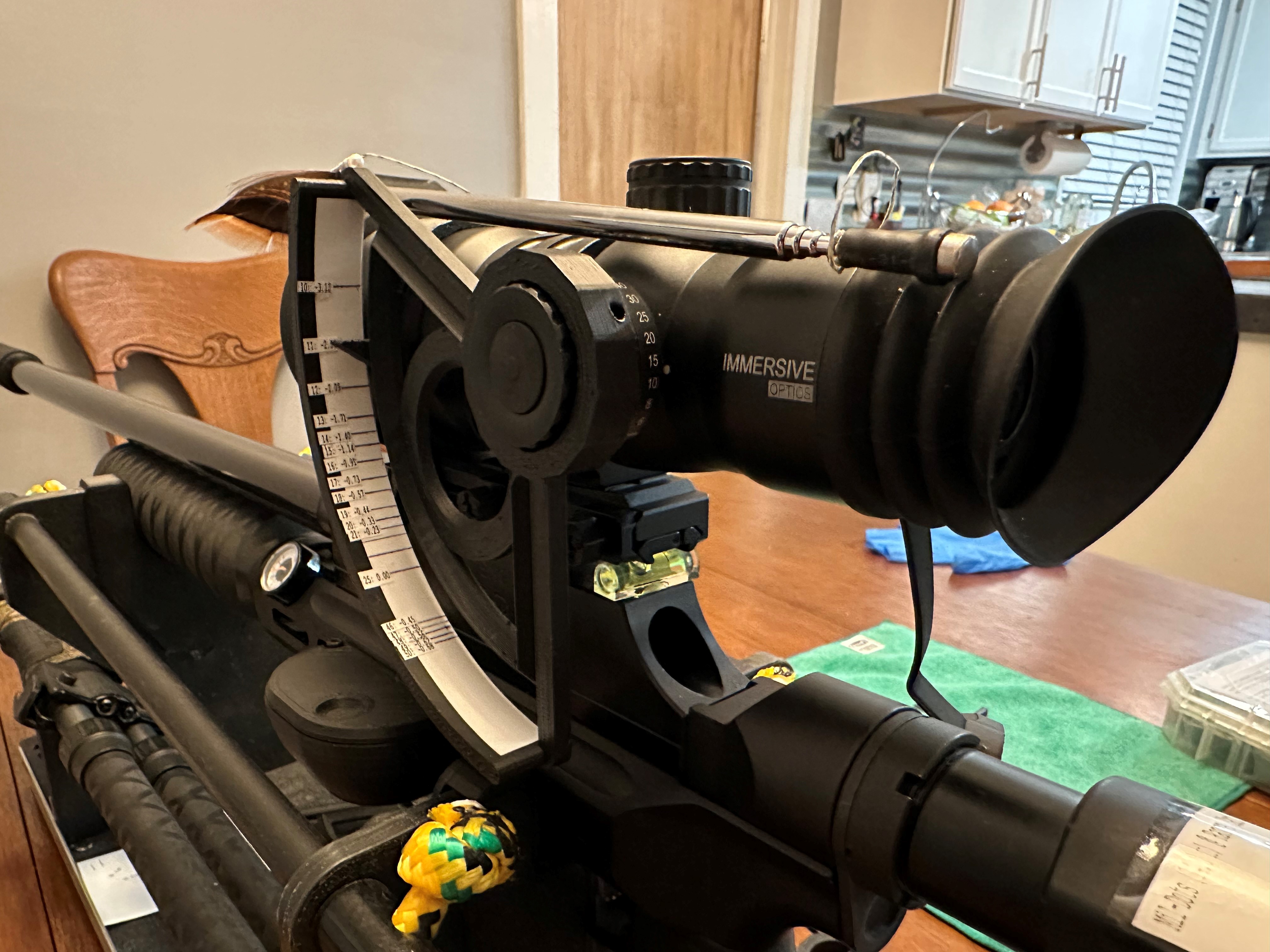

Here's mine when I started to get the yardage marked off:

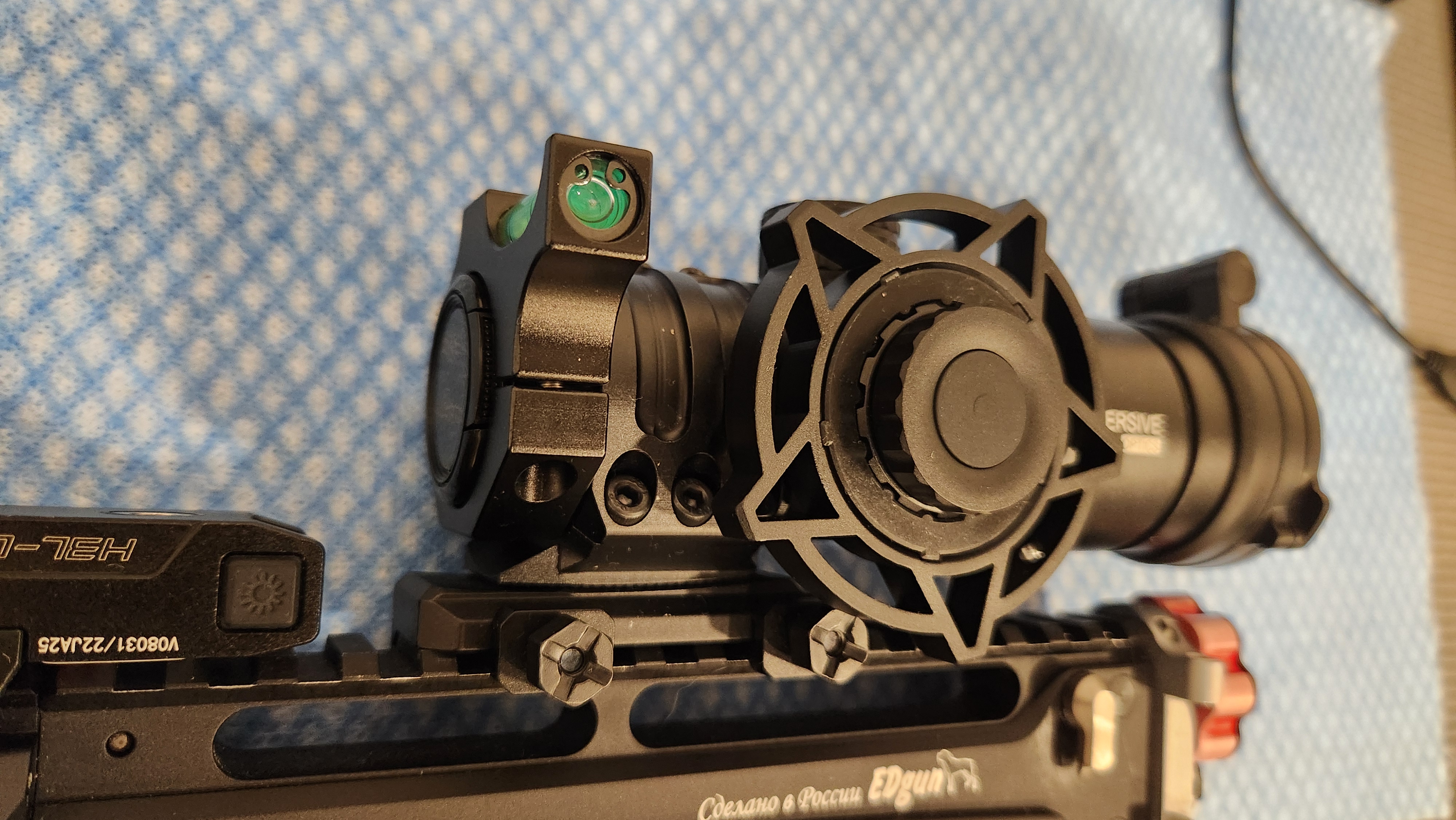

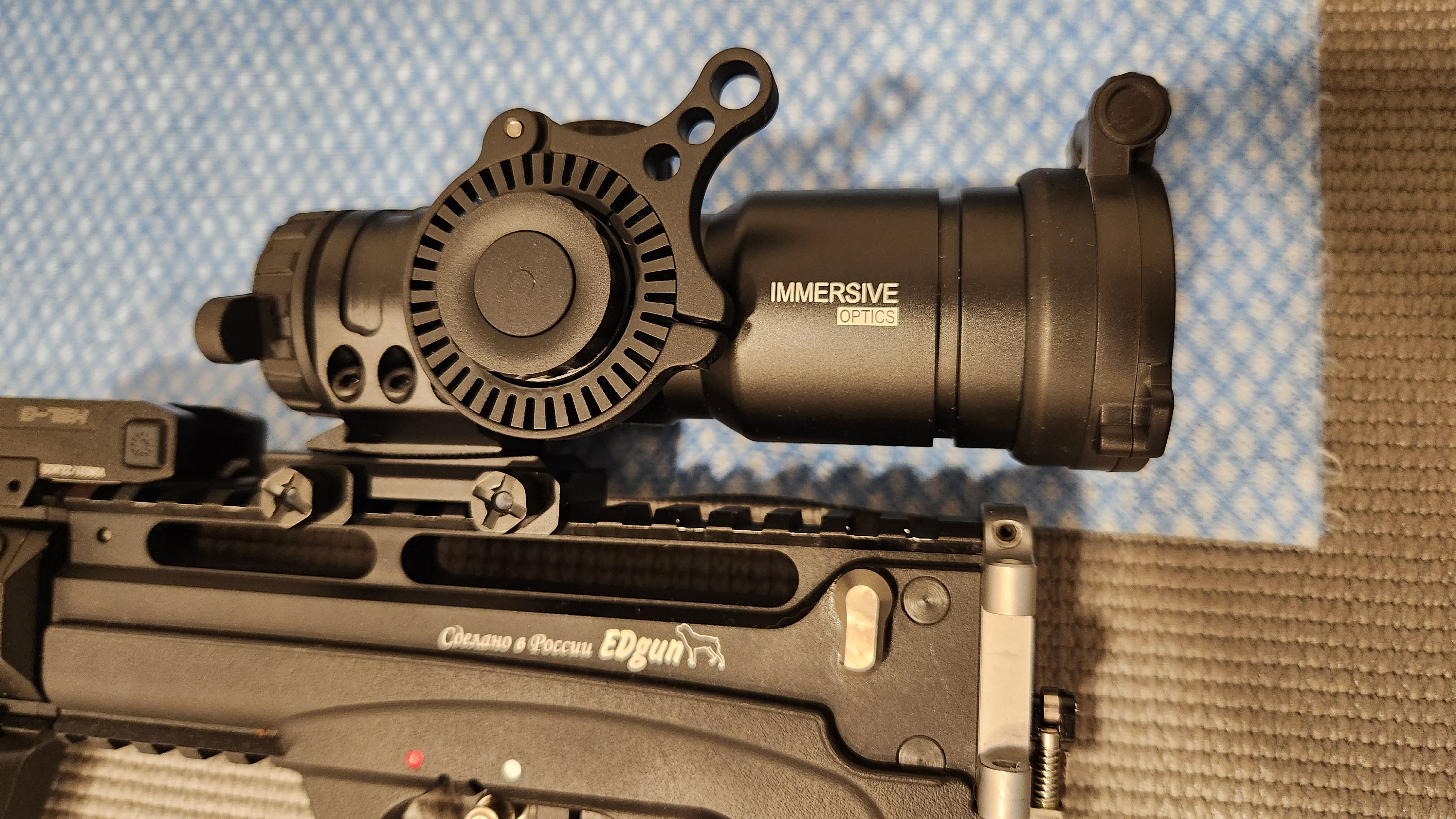

I came up with ordering a sidewheel from vicoptics, with in mind that I will have to modify things on the fly.
For my short range handheld games in the backyard I would also need a bubble, but then nomore room for front lens cover... but a snap on 32mm lens cap can do.
When I throw all parts on a pile, it looks pretty crowded. And I still need to add a flashkill...
Why I always need more trouble? Nothing was wrong with the throw lever setup...
