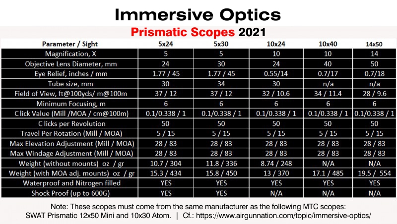

Here are the specs of the prismatic scopes from Immersive Optics:

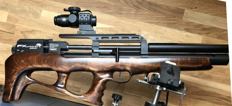

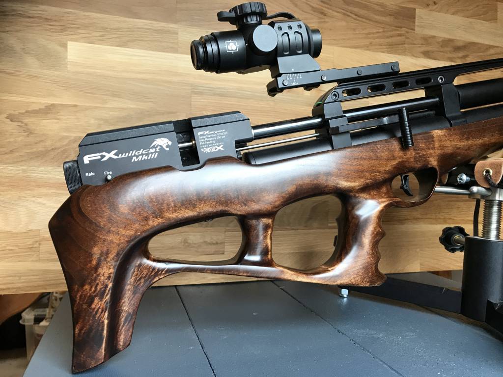

Mounted the Immersive today to my FX Wildcat. Had some shooting time, and I am all over very satisfied.
The short eye relief is new to me, and something I have to get used to. Unpleasant in the beginning, but after a couple of magazines I kind of got used to it. The field of view and crisp image is excellent, and for this little scope (and extremely low weight) with 10 x power almost unbelievable.
But the looks…….? Not so sure. It looks a bit odd with the mounting so far back (due to the short ER again), but it sits tight and firm so no problem there.
Boxtest? Didn’t do that today. In fact I didn’t use the turrets at all. I was going to set zero at about 50-60 meters, but the scope was dead on when I took my first shots at 50 meters. Didn’t have to adjust anything. Never have experienced that before with a scope right out of the box, and a bit amusing aktually.

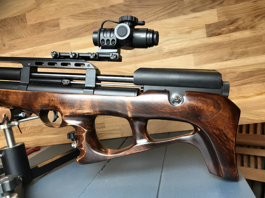

What will happen if you reverse the rail on FX ?
Mballistics, you are amazing at photo manipulating! You even shortened the long base to the shortest one that comes in the box.
Even if there is moa in the rail, I think it would work because the base has adjustable moa in it.
But I am anyway going to put this scope on one of my Rancheros. Think it will suit a pistol very well.

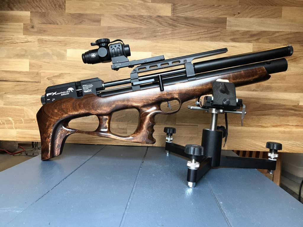

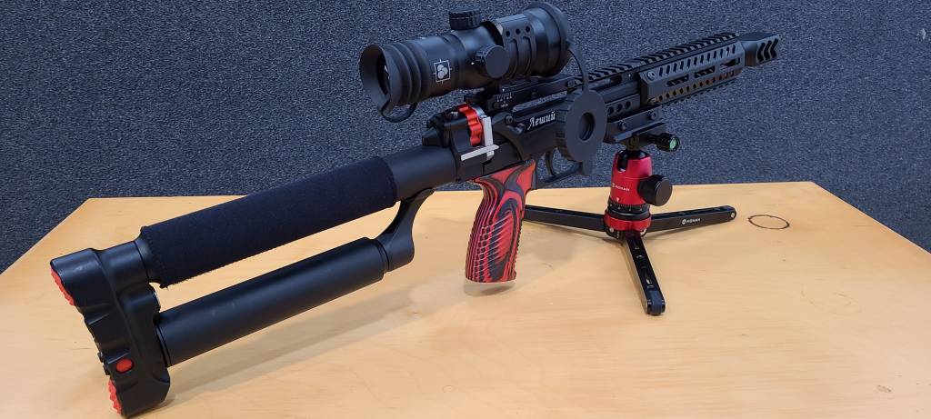

They have some odd features, like the zero eye relief. That can be rather odd — look at the pic how the scope extends waaaay beyond the action — the "wrong" way.
But for pistols — and carbines with the stock detached, retracted, or folded away — that arrangement seems PERFECT for rested shots (rested on ellbows and door posts and fences)! 😊
The advantage of having a 10x scope with the field of view (FoV) of a 3x scope is mind boggling to me. The wide FoV is one of my main reasons why I want scopes with variable magnification — because I need to wide FoV for those close range shots. But with a prismatic — I get the best of both worlds! 😄
🔶 However, I am wondering a bit about scope jitter for offhanded shots. A 10x or 12x and certainly a 14x magnification is probably a bit high for offhanded shots (at least for someone like me with a caffein jitter....). 🤔

Mballistics and jungleshooter. Turning the rail will conflict with your face. Not much, but I wouldn’t recommend it without cutting an inch off the rail. That will work.
The Immersive is ok for the Wildcat, and even if the placement looks unusual, it is well balanced.

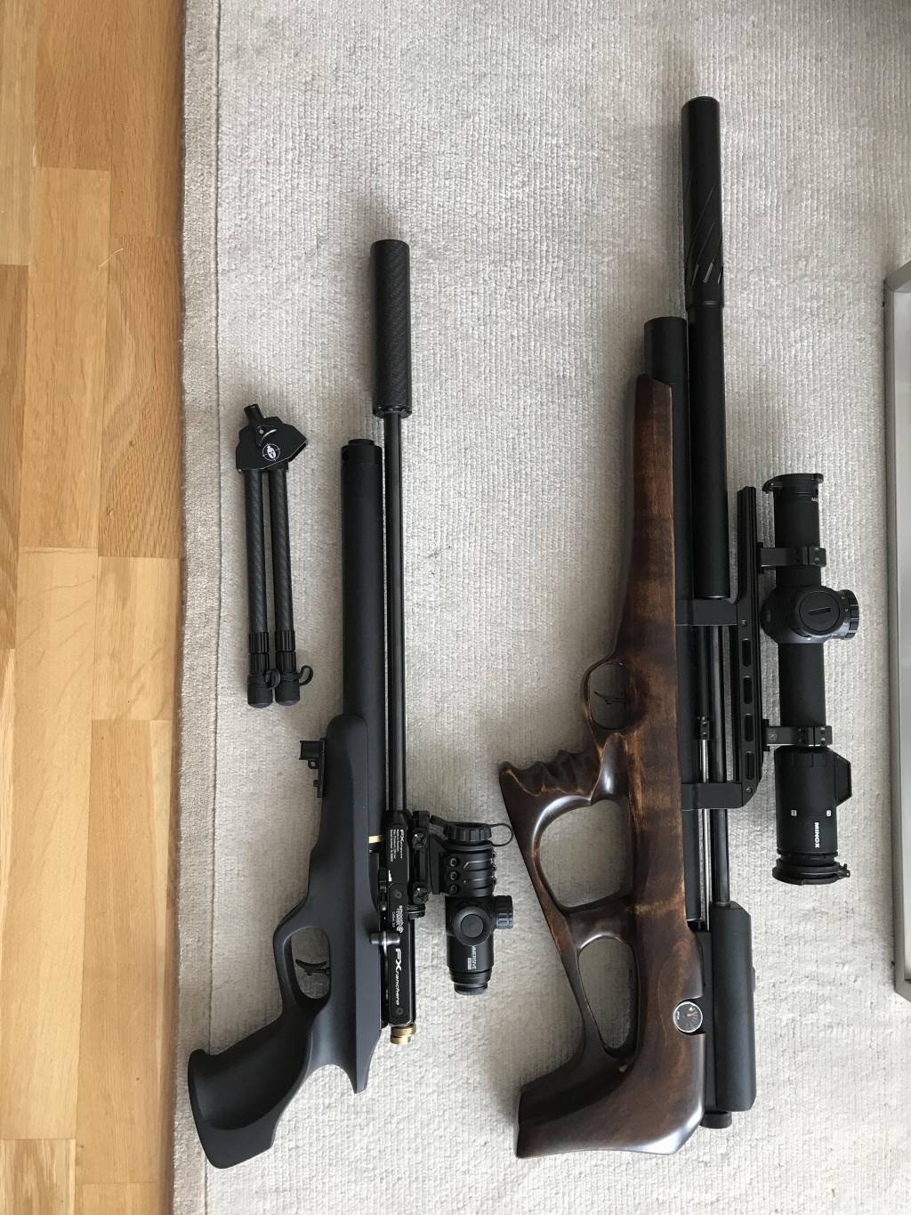

The end solution: I switched the Immersive and the Minox between the Ranchero, and the Wildcat.
10x is no problem for this Pistol. It’s a custom built .22, and delivers 27 ftp. No problem shooting beer cans at 100 meters with this one.
