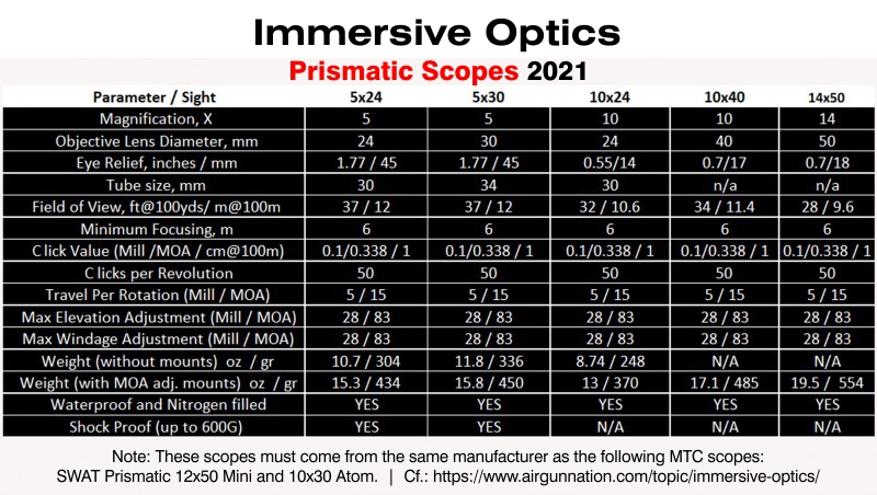

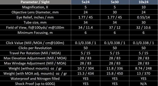

Regarding the weight differences between the 5x24 and 10x24, something seems off. If you calculate the weights of the mounts by subtracting the difference between the weight with and without, the 5x24 mount is 64g while the 10x24 is 56g. Why would the weight of the mounts be different?
And, if you compare the weights of just the scopes, 304g for the 5x24 and 248 for 10x24, how/why is the 5x24 over 20% heavier?
Something seems off.

For curiosity's sake, I weighed my 5x30 and it mount: I got 368g for the scope and 115g for the smallest mount. I left the eye cup on the scope, which would account for the extra weight. So, it looks like the manufacture's weight specifications for the 5x30 are pretty accurate.
This obviously does not explain the questions about the weight discrepancies between the 5x24 and 10x24.
