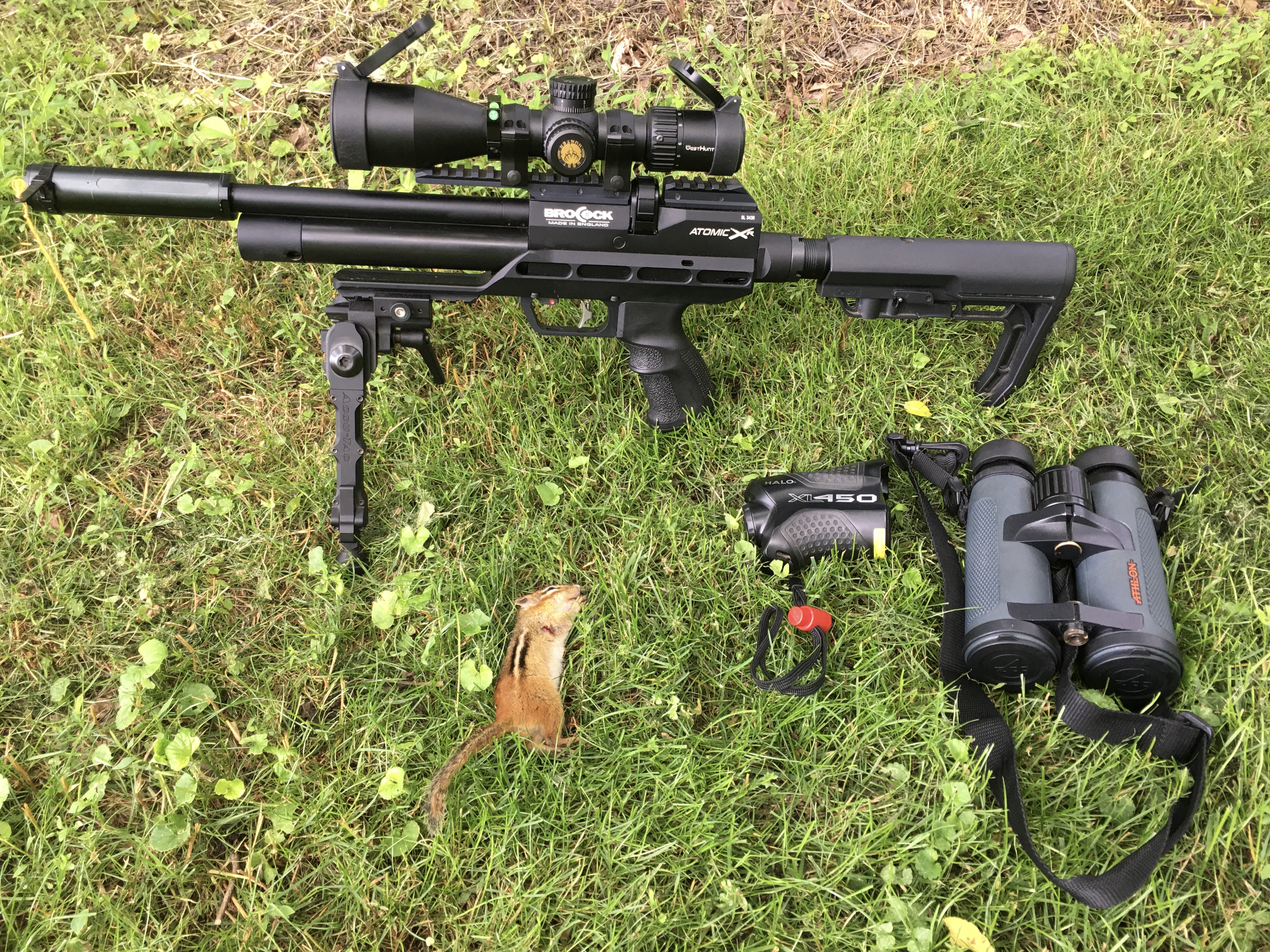

A Ranger or Atomic XR would nicely suit your ratting requirements... My .22 Atomic has proven deadly out to 51 yards. It’s accuracy impresses me daily. You’ll be very surprised at what you can do with 17-18 FPE. The Brits are pesting machines with their 12 FPE guns. My Atomic is my go to pester... My rifles are too long and powerful at 30 FPE for ratting. Even at 17-18 FPE pass throughs are the norm on rats.
This chipper was taken at 51 yards...
